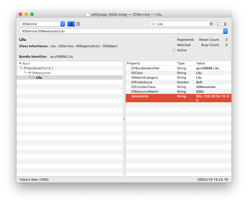

zerobokoo Posted February 8, 2019 Share Posted February 8, 2019 8 hours ago, Andres ZeroCross said: Use this config.plist then reboot, check your AUDIO and upload your IOREG output again config.plist Here it is. The audio device is still missing. Thank you for looking into it, Andres. p40yoga_feb8.ioreg.zip Link to comment https://www.insanelymac.com/forum/topic/311293-applealc-%E2%80%94-dynamic-applehda-patching/page/161/#findComment-2663204 Share on other sites More sharing options...
Andres ZeroCross Posted February 8, 2019 Share Posted February 8, 2019 5 minutes ago, zerobokoo said: Here it is. The audio device is still missing. Thank you for looking into it, Andres. p40yoga_feb8.ioreg.zip You're using Lilu.kext version 1.2.8 First, try to use Latest lilu.kext and AppleALC.kext Put all additional kext in "EFI/CLOVEr/Kexts/Others" Reboot and upload your IOREG again And use this config.plist. config.plist Link to comment https://www.insanelymac.com/forum/topic/311293-applealc-%E2%80%94-dynamic-applehda-patching/page/161/#findComment-2663206 Share on other sites More sharing options...
zerobokoo Posted February 8, 2019 Share Posted February 8, 2019 (edited) 8 minutes ago, Andres ZeroCross said: You're using Lilu.kext version 1.2.8 First, try to use Latest lilu.kext and AppleALC.kext No, I'm using Lilu.kext 1.3.3 and AppleALC.kext 1.3.5 from GitHub releases (RELEASE zip file) I just downloaded them again to compare with diff -qr and yes, they are the latest versions. Edit: wait, there's an older Lilu.kext in /Library/Extensions! Who put it there??? Wait a minute, let me try again. Edited February 8, 2019 by zerobokoo Link to comment https://www.insanelymac.com/forum/topic/311293-applealc-%E2%80%94-dynamic-applehda-patching/page/161/#findComment-2663207 Share on other sites More sharing options...
Andres ZeroCross Posted February 8, 2019 Share Posted February 8, 2019 1 minute ago, zerobokoo said: No, I'm using Lilu.kext 1.3.3 and AppleALC.kext 1.3.5 from GitHub releases (RELEASE zip file) I just downloaded them again to compare with diff -qr and yes, they are the latest versions. Your IOREG show that you used Lilu 1.2.8 Link to comment https://www.insanelymac.com/forum/topic/311293-applealc-%E2%80%94-dynamic-applehda-patching/page/161/#findComment-2663209 Share on other sites More sharing options...
zerobokoo Posted February 8, 2019 Share Posted February 8, 2019 (edited) 7 minutes ago, Andres ZeroCross said: Your IOREG show that you used Lilu 1.2.8 Yes, I'm sorry. There was an older Lilu.kext in /Library/Extensions. I didn't put it there, probably some other utility I used did it. Now I've removed it and done the dump again. p40yoga_feb8_B.ioreg.zip Edited February 8, 2019 by zerobokoo Link to comment https://www.insanelymac.com/forum/topic/311293-applealc-%E2%80%94-dynamic-applehda-patching/page/161/#findComment-2663210 Share on other sites More sharing options...
Andres ZeroCross Posted February 8, 2019 Share Posted February 8, 2019 1 minute ago, zerobokoo said: Yes, I'm sorry. There was an older Lilu.kext in /Library/Extensions. I didn't put it there, probably an utility like ##### did it. Now I've removed it and done the dump again. p40yoga_feb8_B.ioreg.zip I upload new config.plist above,, use it. And upload your IOREG again Link to comment https://www.insanelymac.com/forum/topic/311293-applealc-%E2%80%94-dynamic-applehda-patching/page/161/#findComment-2663211 Share on other sites More sharing options...

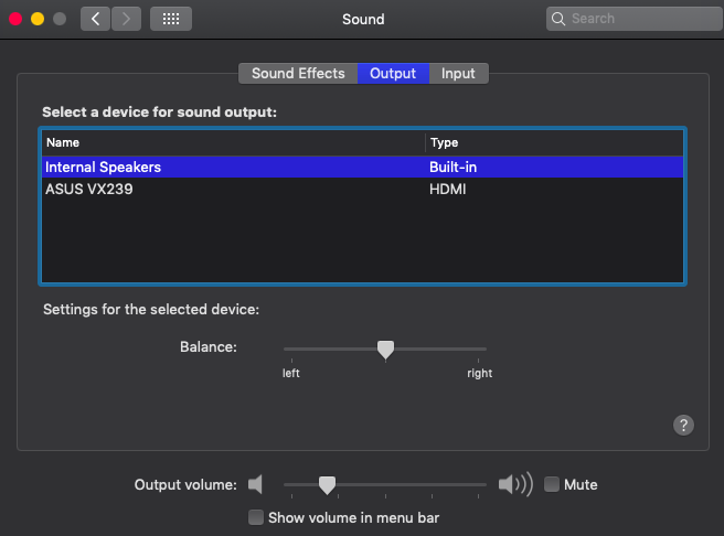

zerobokoo Posted February 8, 2019 Share Posted February 8, 2019 3 minutes ago, Andres ZeroCross said: I upload new config.plist above,, use it. And upload your IOREG again OMG you're right, I didn't use the new config.plist. I feel so dumb! Now I've done it and I have audio output! Thank you sooo much! Here's the IOREG. Is there anything else you want me to try on this hardware? p40yoga_feb8_C.ioreg.zip Link to comment https://www.insanelymac.com/forum/topic/311293-applealc-%E2%80%94-dynamic-applehda-patching/page/161/#findComment-2663213 Share on other sites More sharing options...
Andres ZeroCross Posted February 8, 2019 Share Posted February 8, 2019 (edited) 3 minutes ago, zerobokoo said: OMG you're right, I didn't use the new config.plist. I feel so dumb! Now I've done it and I have audio output! Thank you sooo much! Here's the IOREG. Is there anything else you want me to try on this hardware? p40yoga_feb8_C.ioreg.zip Config plist before is using layoutID = 21,, it's my work for LG Gram series. SO i change it to 3 (Mirone works) Edited February 8, 2019 by Andres ZeroCross Link to comment https://www.insanelymac.com/forum/topic/311293-applealc-%E2%80%94-dynamic-applehda-patching/page/161/#findComment-2663214 Share on other sites More sharing options...

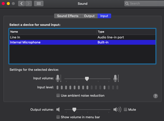

zerobokoo Posted February 8, 2019 Share Posted February 8, 2019 2 minutes ago, Andres ZeroCross said: Config plist before is use layoutID = 21,, it's my work for LG Gram series. SO i change it to 3 (Mirone works) Thank you. To be complete, I see 1 Output device: "Internal Speakers" (which becomes "Headphones" when the headphones are connected) and 2 Input devices: "Internal Microphone" and "Line In". The internal microphone does not work (for me it's ok, because I don't need it, but I wanted to mention it for completeness. Some other people might need it, for Skype or such.) The Line-in I have no idea where it is, because there is no line-in port on my laptop. Maybe it's integrated in the headphone jack, with TRRS pins, but I don't have a headphone like that so I cannot try right now. Link to comment https://www.insanelymac.com/forum/topic/311293-applealc-%E2%80%94-dynamic-applehda-patching/page/161/#findComment-2663216 Share on other sites More sharing options...
Andres ZeroCross Posted February 8, 2019 Share Posted February 8, 2019 3 minutes ago, zerobokoo said: Thank you. To be complete, I see 1 Output device: "Internal Speakers" (which becomes "Headphones" when the headphones are connected) and 2 Input devices: "Internal Microphone" and "Line In". The internal microphone does not work (for me it's ok, because I don't need it, but I wanted to mention it for completeness. Some other people might need it, for Skype or such.) The Line-in I have no idea where it is, because there is no line-in port on my laptop. Maybe it's integrated in the headphone jack, with TRRS pins, but I don't have a headphone like that so I cannot try right now. I don't know, it's mirone's work for LayoutID =3. Can you upload your Codec_dump.txt again??? I will check it later And can you write your Notebook model? Link to comment https://www.insanelymac.com/forum/topic/311293-applealc-%E2%80%94-dynamic-applehda-patching/page/161/#findComment-2663217 Share on other sites More sharing options...
