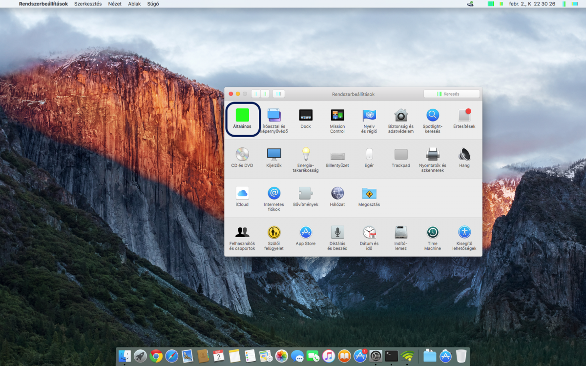

When did you have found this color shifts? only the two kernels or with all the other kernels?
the test with the last two kernels with my Phenom II X6 was much worse than it is visible on your screen, so I have removed the two kernels  :(
Just an idea but, what if the green glitch in FX is caused by Metal being used instead of OpenGl?
Maybe the older processors don't meet the requirements and revert to OpenGl.

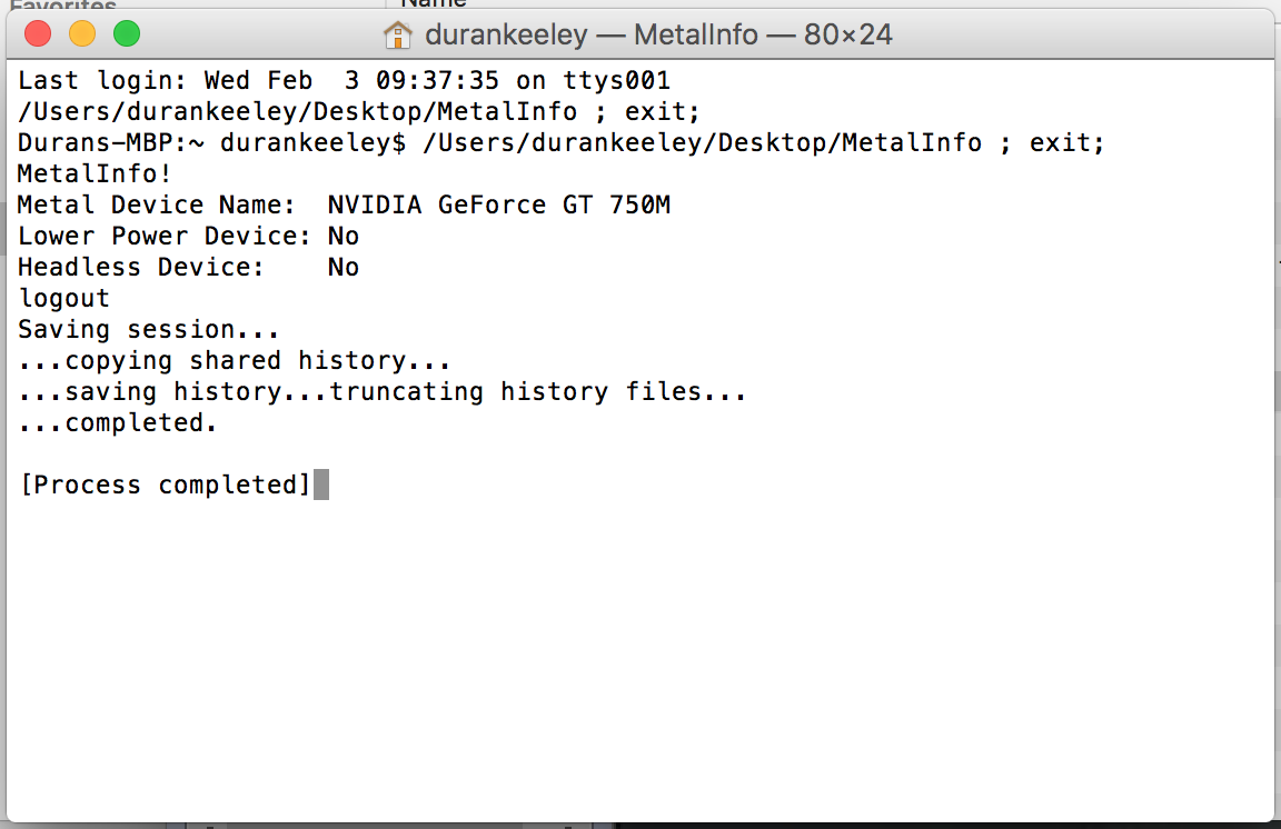

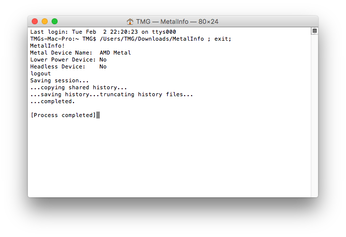

There is a way to test if your machine is using Metal...
Run this app (credits to netkas)
If there is Metal running you should get this result:
If you do not have Metal supported on your PC:
EDIT: If there are any older processors running Metal and does not have the green glitch please advise as well.
MetalInfo.zip

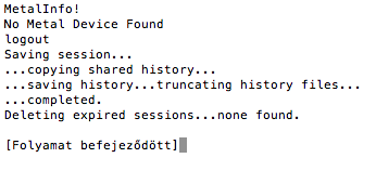

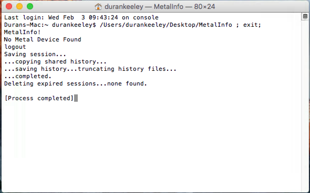

No graphical glitches on my Athlon but no Metal either,
MetalInfo!
No Metal Device Found
logout
Saving session...
...copying shared history...
...saving history...truncating history files...
...completed.
Deleting expired sessions...40 completed.
[Process completed]
My system works reliably and without graphic glitchy, so here is my metal result
MetalInfo!
logout
Saving session...
...completed.
[Prozess beendet]

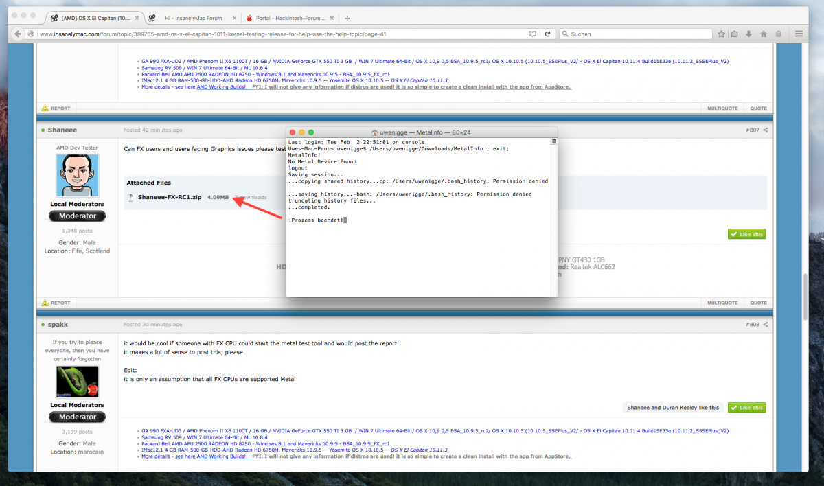

it would be cool if someone with FX CPU could start the metal test tool and would post the report.
it makes a lot of sense to post this, please
Edit:
it is only an assumption that all FX CPUs are supported Metal

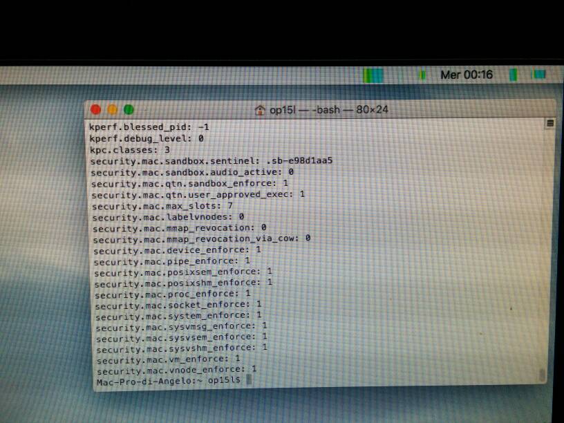

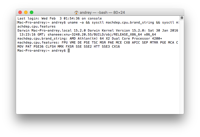

Successfully boot 10.11.3 with this kernel. No graphics bugs.
Mac-Pro-andrey:~ andrey$ sysctl -a

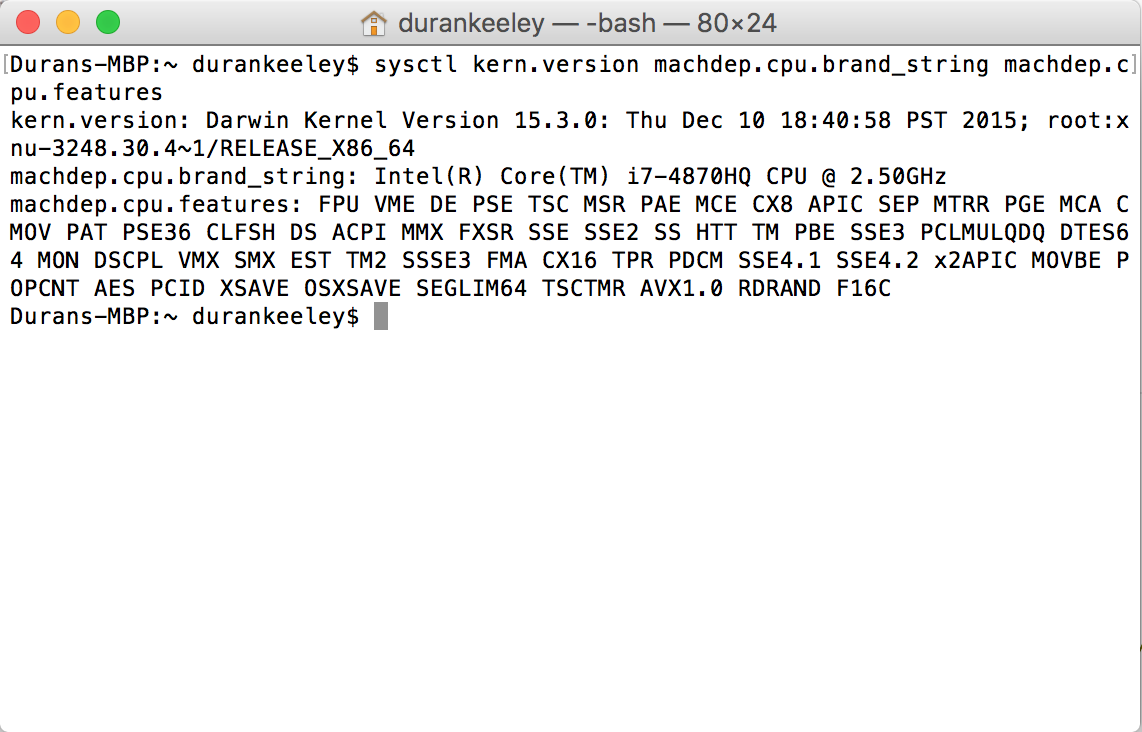

Can you send the "sysctl machdep.cpu.features" of another kernel that you have used in the past and of Spakk's (10.11.2-AMD_6_Duran1) so I can compare the features that show.
Where is it ?how to find it?
Open terminal and type the following
Also state what kernel you are using when you do it
EDIT:
The best way to provide all this info would be to use this command in terminal
"sysctl kern.version machdep.cpu.brand_string machdep.cpu.features"
It will give us the kernel, the processor and the features

green icons & and lagging graphics.(I had this prob with lagging graphics in my early Yosemite hacks due to nvidia 210)

Awesome there is something there that I didn't see (that is what I wanted!)
Shaneee's kernel which is using:
