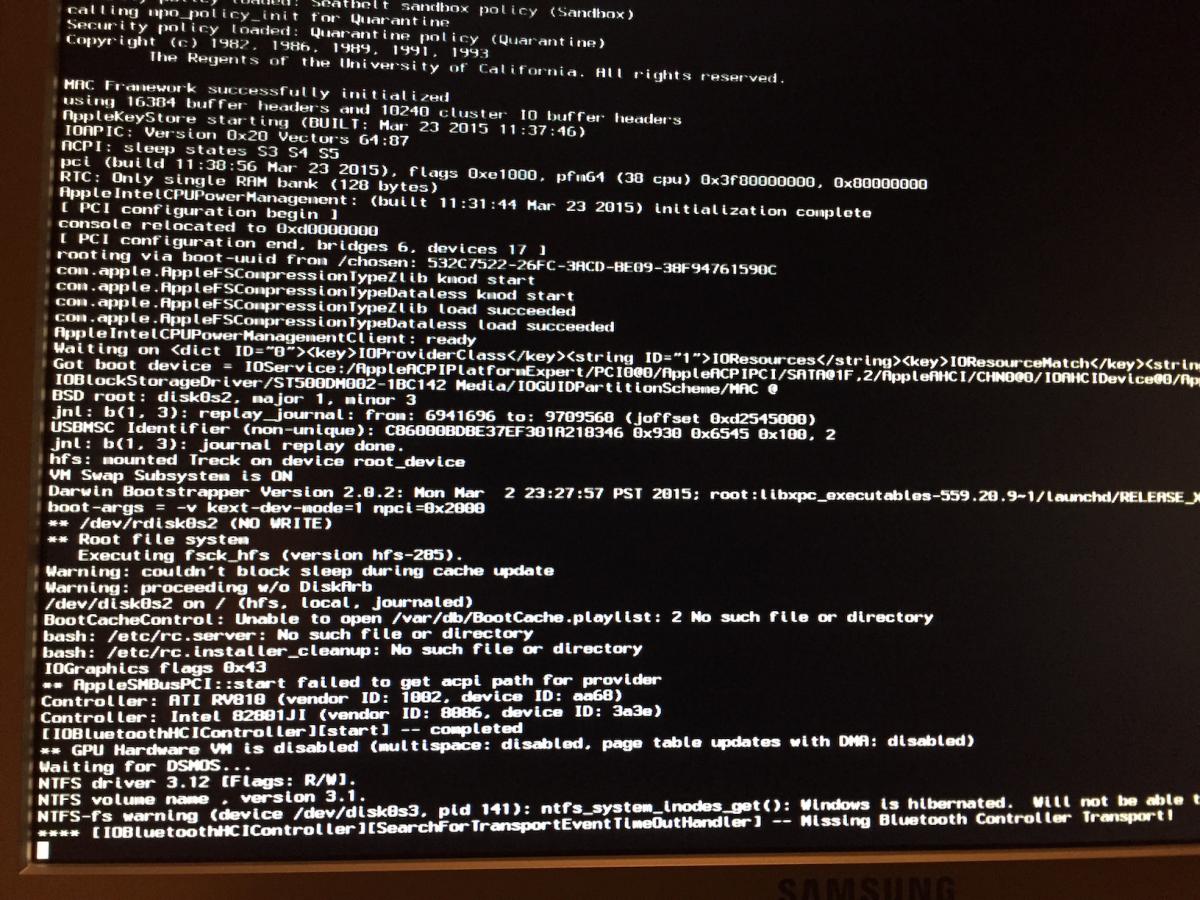

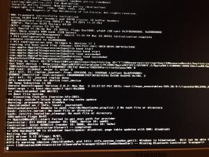

nick.0k Posted December 1, 2015 Author Share Posted December 1, 2015 Copiato i due file e controllato...facendo partire dal boot mi va in panico su PCI configurazione begin. Se aggiungo npci=0x2000 va avanti fino alla seguente schermata: Sembra lo stesso problema dove si impiantava prima di installare i kext video modificati... Link to comment https://www.insanelymac.com/forum/topic/309400-nuovo-hardware-su-mb-asus-p5qld-pro-yosemite-10105/page/3/#findComment-2193353 Share on other sites More sharing options...
gengik84 Posted December 1, 2015 Share Posted December 1, 2015 hai messo Fake? Link to comment https://www.insanelymac.com/forum/topic/309400-nuovo-hardware-su-mb-asus-p5qld-pro-yosemite-10105/page/3/#findComment-2193358 Share on other sites More sharing options...
nick.0k Posted December 1, 2015 Author Share Posted December 1, 2015 oops. giusto nella cartella kext..vero? Link to comment https://www.insanelymac.com/forum/topic/309400-nuovo-hardware-su-mb-asus-p5qld-pro-yosemite-10105/page/3/#findComment-2193362 Share on other sites More sharing options...
gengik84 Posted December 1, 2015 Share Posted December 1, 2015 oops. giusto nella cartella kext..vero? Si..... in EFI/clover/kext/10.10 Link to comment https://www.insanelymac.com/forum/topic/309400-nuovo-hardware-su-mb-asus-p5qld-pro-yosemite-10105/page/3/#findComment-2193365 Share on other sites More sharing options...
nick.0k Posted December 1, 2015 Author Share Posted December 1, 2015 Uaoo! E' partito alla prima!...Unico neo non mi funziona la tastiera... io ho ancora una vecchia PS/2... Cosa devo aggiungere..? Link to comment https://www.insanelymac.com/forum/topic/309400-nuovo-hardware-su-mb-asus-p5qld-pro-yosemite-10105/page/3/#findComment-2193371 Share on other sites More sharing options...
