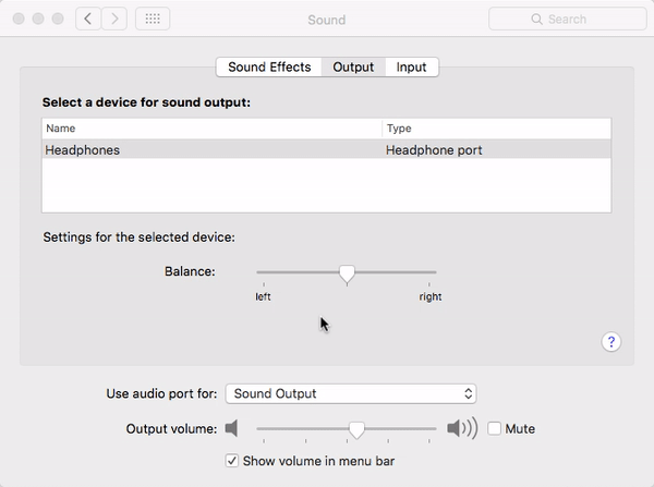

tcm5025 Posted March 6, 2017 Share Posted March 6, 2017 I can't believe it. I finally have sound with volume control! Grabbed your patch from today up above: AppleHDA.kext_10.12.3_front_HP.zip. I replaced my AppleHDA in /System/Library/Extensions and set layout-id to 0 with HDAS to HDEF renaming in clover plist, and it works! I don't have FixHDA on. I've been struggling with this for days. Both line out ports and the headphone ports on the back of the mobo work with volume control . The headphone port works on the front of the case as well. I don't have a mic/5.1 speakers/digital to test with right now. They have basically given up on fixing the layouts for this codec on the AppleALC project for now, and I thought I was never going to get it working. Thank you Wern! Is this what everyone else is doing with the AppleHDA? You can't put that in Clover and let it inject it over top of the other one, can you? Link to comment https://www.insanelymac.com/forum/topic/309283-creative-ca0132-g1sniper-m3-patch-for-applehda-or-voodoohda/page/18/#findComment-2379482 Share on other sites More sharing options...

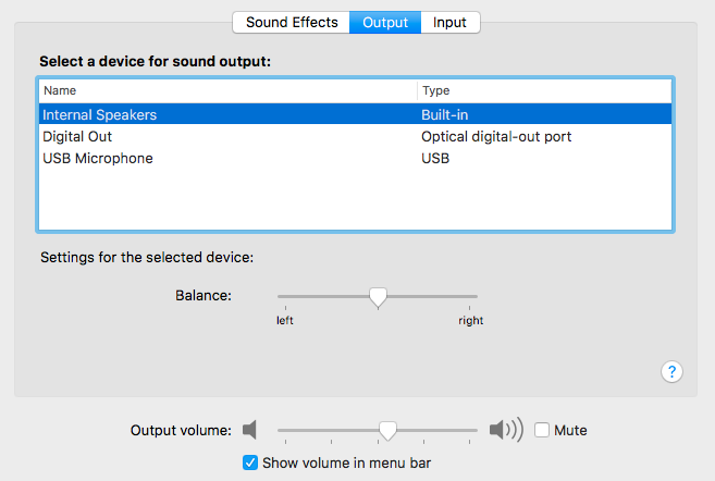

alex88 Posted March 25, 2017 Share Posted March 25, 2017 So I've tried any layout-id by changing clover audio inject from 0 to 13, still nothing, only internal speaker output, no way to use line-out (I've my headphones attached to rear line-out and mic and only mic works) Link to comment https://www.insanelymac.com/forum/topic/309283-creative-ca0132-g1sniper-m3-patch-for-applehda-or-voodoohda/page/18/#findComment-2391612 Share on other sites More sharing options...
wern apfel Posted March 26, 2017 Author Share Posted March 26, 2017 So I've tried any layout-id by changing clover audio inject from 0 to 13, still nothing, only internal speaker output, no way to use line-out (I've my headphones attached to rear line-out and mic and only mic works) You should connect your Headphones to the rear or front Headphone jack, if the device name is "Internal Speakers" you don't use one of my kexts. Make sure you use an untouched AppleHDA.kext, remove VoodooHDA.kext, AppleHDADisabler/Enabler.kext, Creative*CA0132.kext then put AppleALC.kext + Lilu.kext to clover/kexts/other, CodecCommander to /S/L/E, repair permissions, rebuild the cache, reboot. Try layout-id from 0 to 6 Alternatively, remove VoodooHDA.kext, AppleHDADisabler/Enabler.kext, Creative*CA0132.kext set the layout-id to 0 and install a fully patched kext to /S/L/E repair permissions, rebuild the cache, reboot. PS: I have set the layout-id via DSDT.aml. Link to comment https://www.insanelymac.com/forum/topic/309283-creative-ca0132-g1sniper-m3-patch-for-applehda-or-voodoohda/page/18/#findComment-2391923 Share on other sites More sharing options...

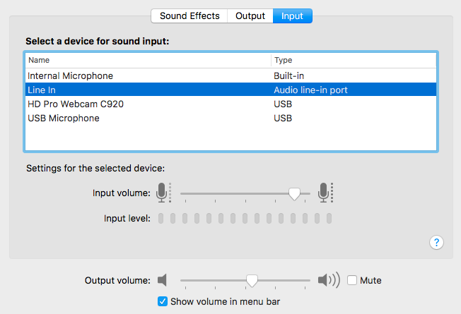

CarbonUK Posted May 29, 2017 Share Posted May 29, 2017 Hey, I have the z270 gaming 7 with the same chip and I have been guided by another forum member. So far we managed to get my Logitech z501s to work in 2.1 and my USB microphone worked out of the box. However, my DT 770 Pros don't seem to work in the front jack and I can't seem to get the z501s to upsample to 5.1 or play original 5.1 audio. I'm very new to this kind of thing and I appreciate all the help. If you can use the most basic language / advice Thanks again. Link to comment https://www.insanelymac.com/forum/topic/309283-creative-ca0132-g1sniper-m3-patch-for-applehda-or-voodoohda/page/18/#findComment-2432374 Share on other sites More sharing options...
CarbonUK Posted May 29, 2017 Share Posted May 29, 2017 Just in case you need any of this Edit: Im not sure what the line in on the inputs tab is EFI.zip Link to comment https://www.insanelymac.com/forum/topic/309283-creative-ca0132-g1sniper-m3-patch-for-applehda-or-voodoohda/page/18/#findComment-2432390 Share on other sites More sharing options...
