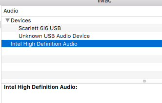

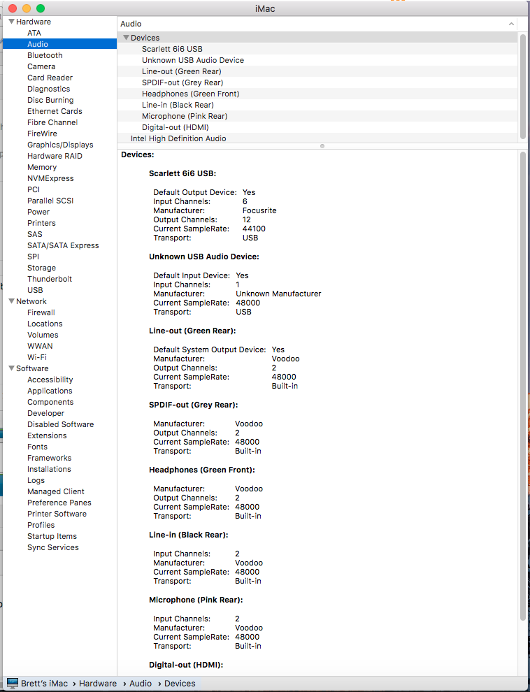

burtmakai Posted October 19, 2016 Share Posted October 19, 2016 Thank you for your help so far. I installed everything I believe, set my audio id to 0, and I am only getting 2 channels. Should be getting 5.1. I also can't control the volume slider from my keyboard or the sound menu. I've included my Audio Information. Any ideas? Thank you. Link to comment https://www.insanelymac.com/forum/topic/309283-creative-ca0132-g1sniper-m3-patch-for-applehda-or-voodoohda/page/15/#findComment-2302657 Share on other sites More sharing options...
wern apfel Posted October 19, 2016 Author Share Posted October 19, 2016 Thanks for your feedback on this.Can you please let me know the changes that you made to the kext (binary patches, Layout0 and platform modifications) so that i can replicate them on the latest applehda.kext (on 10.12) ? As i mentioned, the kext that worked for me was the DP8 version attached at post 319 of this thread. THank you in advance. I don't think that the DP8 kext is different. Since some users are sharing this patch as their own work, i've decided to publish no more infos. Thanks for understanding. Thank you for your help so far. I installed everything I believe, set my audio id to 0, and I am only getting 2 channels. Should be getting 5.1. I also can't control the volume slider from my keyboard or the sound menu. I've included my Audio Information. Screen Shot 2016-10-19 at 4.20.45 PM.png Any ideas? Thank you. The screenshot shows me, that you are using voodoohda 1 Link to comment https://www.insanelymac.com/forum/topic/309283-creative-ca0132-g1sniper-m3-patch-for-applehda-or-voodoohda/page/15/#findComment-2302740 Share on other sites More sharing options...

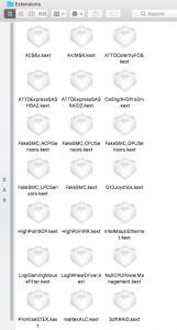

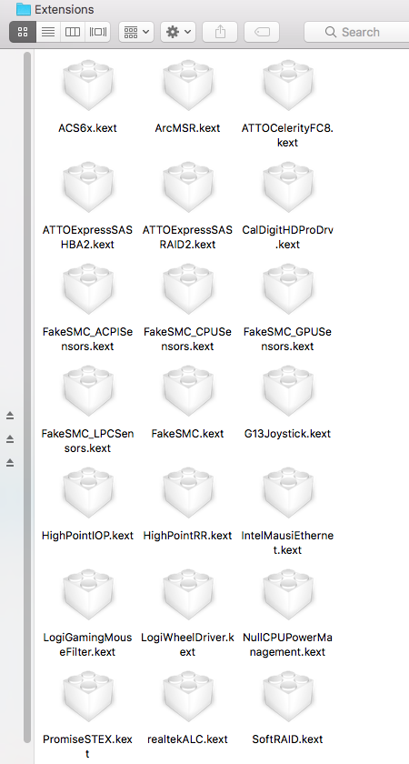

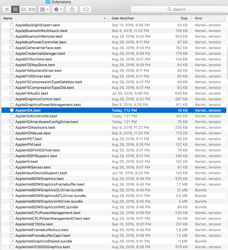

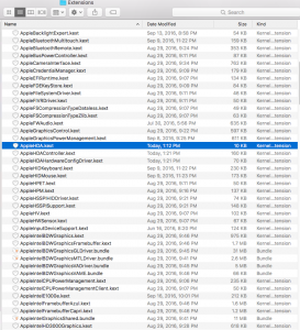

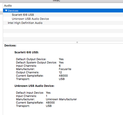

burtmakai Posted October 20, 2016 Share Posted October 20, 2016 Wern and others, I uninstalled VoodooHDA. I installed all the kexts in the AppleHDA.kext_6ch_no_fr_HP zip. I couldn't get the AppleHDA to execute. Everything is in the library/extensions and system/library/extensions. I believe. Nothing is appearing under Intel High Definition Audio. What now? Link to comment https://www.insanelymac.com/forum/topic/309283-creative-ca0132-g1sniper-m3-patch-for-applehda-or-voodoohda/page/15/#findComment-2303026 Share on other sites More sharing options...
wern apfel Posted October 20, 2016 Author Share Posted October 20, 2016 Wern and others, I uninstalled VoodooHDA. I installed all the kexts in the AppleHDA.kext_6ch_no_fr_HP zip. I couldn't get the AppleHDA to execute. Everything is in the library/extensions and system/library/extensions. I believe. Nothing is appearing under Intel High Definition Audio. What now? Screen Shot 2016-10-20 at 1.34.31 PM.png Screen Shot 2016-10-20 at 1.34.50 PM.png Screen Shot 2016-10-20 at 1.38.31 PM.png Screen Shot 2016-10-20 at 1.48.28 PM.png Totally wrong, remove the realtekALC.kext, and the 3 AppleHDA*.kexts, then install the kext you've downloaded with an kextutility to S/L/E. If you use a dsdt.aml or ssdt.aml, search for layout-id and change it to 0, see the code below. Or upload your dsdt.aml and i will change it for you. "layout-id", Buffer (0x04) { 0x00, 0x00, 0x00, 0x00 }, Link to comment https://www.insanelymac.com/forum/topic/309283-creative-ca0132-g1sniper-m3-patch-for-applehda-or-voodoohda/page/15/#findComment-2303108 Share on other sites More sharing options...
