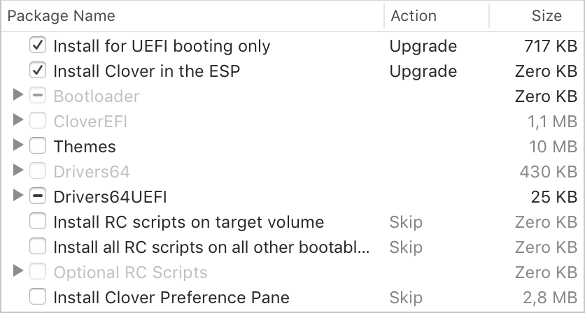

wern apfel Posted November 29, 2017 Author Share Posted November 29, 2017 Thanks for your help but at last I lost my efi partition and I have tried to erase my SSD and completely reinstall my OS High Sierra with a USB stick but after the boot from High Sierra on the installation SSD I get the message /System/Installation/Packages/OSInstall.mpkg appears to be missing or damaged. I don't know what to do I think I'll give my efforts up.\ A fresh install should fix the most issues. If you have already the newest clover, temporary remove the EmuVariableUefi-64.efi driver from your EFI folder to bypass the OSInstall.mpkg issue. Link to comment https://www.insanelymac.com/forum/topic/309283-creative-ca0132-g1sniper-m3-patch-for-applehda-or-voodoohda/page/23/#findComment-2541548 Share on other sites More sharing options...
htimm Posted November 29, 2017 Share Posted November 29, 2017 A fresh install should fix the most issues. If you have already the newest clover, temporary remove the EmuVariableUefi-64.efi driver from your EFI folder to bypass the OSInstall.mpkg issue. Can I use my own EFI folder because I have tried it with a created one by the newest version of Clover. Maybe that is my mistake. Here is my EFI folder that gives me te failure also without the EmuVariableUefi-64.efi driver. EFI.zip Link to comment https://www.insanelymac.com/forum/topic/309283-creative-ca0132-g1sniper-m3-patch-for-applehda-or-voodoohda/page/23/#findComment-2541599 Share on other sites More sharing options...
wern apfel Posted November 29, 2017 Author Share Posted November 29, 2017 I've never had that issue and can't tell you more about it. You should also try some firmware feature values. Link to comment https://www.insanelymac.com/forum/topic/309283-creative-ca0132-g1sniper-m3-patch-for-applehda-or-voodoohda/page/23/#findComment-2541643 Share on other sites More sharing options...
htimm Posted November 29, 2017 Share Posted November 29, 2017 I've never had that issue and can't tell you more about it. You should also try some firmware feature values. When I look on my destination drive I see that there is an empty EFI partition could that be the problem. Link to comment https://www.insanelymac.com/forum/topic/309283-creative-ca0132-g1sniper-m3-patch-for-applehda-or-voodoohda/page/23/#findComment-2541644 Share on other sites More sharing options...
wern apfel Posted November 29, 2017 Author Share Posted November 29, 2017 When I look on my destination drive I see that there is an empty EFI partition could that be the problem. Install clover to the ESP, so far i remember clover cannot be installed on a APFS formatted drive. Link to comment https://www.insanelymac.com/forum/topic/309283-creative-ca0132-g1sniper-m3-patch-for-applehda-or-voodoohda/page/23/#findComment-2541647 Share on other sites More sharing options...
htimm Posted November 29, 2017 Share Posted November 29, 2017 Install clover to the ESP, so far i remember clover cannot be installed on a APFS formatted drive.Forgive me but what do you mean with ESP? Verstuurd vanaf mijn Lenovo TAB 2 A10-70F met Tapatalk Link to comment https://www.insanelymac.com/forum/topic/309283-creative-ca0132-g1sniper-m3-patch-for-applehda-or-voodoohda/page/23/#findComment-2541658 Share on other sites More sharing options...
wern apfel Posted November 30, 2017 Author Share Posted November 30, 2017 Forgive me but what do you mean with ESP? Verstuurd vanaf mijn Lenovo TAB 2 A10-70F met Tapatalk ESP = EFI System Partition Link to comment https://www.insanelymac.com/forum/topic/309283-creative-ca0132-g1sniper-m3-patch-for-applehda-or-voodoohda/page/23/#findComment-2542096 Share on other sites More sharing options...

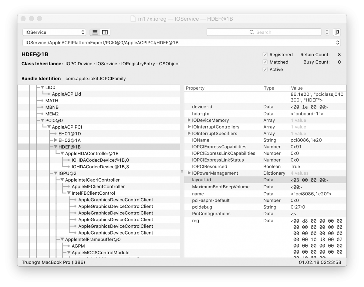

064852029 Posted January 30, 2018 Share Posted January 30, 2018 Hello, i'm a newbie. I have just install hackintosh for hours. And i'm also sorry for my bad English.How can I define which layout-id is suitable for my laptop? I'm using alienware M17x r4. It has 4 3.5 audio jack. They are headphone, headset, micro and optical out. My laptop also has a stereo micro in front of screen. I think layout-id 1 is suitable but I still don't know how to change to that layout. Tell me anything you need to give a guide for me. Thank you very much and sorry for my bad English again. Link to comment https://www.insanelymac.com/forum/topic/309283-creative-ca0132-g1sniper-m3-patch-for-applehda-or-voodoohda/page/23/#findComment-2580296 Share on other sites More sharing options...
wern apfel Posted January 30, 2018 Author Share Posted January 30, 2018 Hello, i'm a newbie. I have just install hackintosh for hours. And i'm also sorry for my bad English. How can I define which layout-id is suitable for my laptop? I'm using alienware M17x r4. It has 4 3.5 audio jack. They are headphone, headset, micro and optical out. My laptop also has a stereo micro in front of screen. I think layout-id 1 is suitable but I still don't know how to change to that layout. Tell me anything you need to give a guide for me. Thank you very much and sorry for my bad English again. You can define the layout-id by entering the value in the config.plist or a custom DSDT/SSDT, where the DSDT/SSDT has higher priority. Layout-id 1 should work for you, but with only one headphone jack. With the necessary information, we can also activate the second headphone jack. Save and upload your IOReg for further investigations. config.plist <key>Devices</key> <dict> <key>Audio</key> <dict> <key>Inject</key> <string>1</string> </dict> Link to comment https://www.insanelymac.com/forum/topic/309283-creative-ca0132-g1sniper-m3-patch-for-applehda-or-voodoohda/page/23/#findComment-2580440 Share on other sites More sharing options...
064852029 Posted January 31, 2018 Share Posted January 31, 2018 You can define the layout-id by entering the value in the config.plist or a custom DSDT/SSDT, where the DSDT/SSDT has higher priority. Layout-id 1 should work for you, but with only one headphone jack. With the necessary information, we can also activate the second headphone jack. Save and upload your IOReg for further investigations. config.plist <key>Devices</key> <dict> <key>Audio</key> <dict> <key>Inject</key> <string>1</string> </dict> I tried this but it does not recognize input neither output Link to comment https://www.insanelymac.com/forum/topic/309283-creative-ca0132-g1sniper-m3-patch-for-applehda-or-voodoohda/page/23/#findComment-2580832 Share on other sites More sharing options...
wern apfel Posted January 31, 2018 Author Share Posted January 31, 2018 I tried this but it does not recognize input neither output As mentioned in the previous post, a custom DSDT has a higher priority and the entry in the config.plist has no effect. Also you've not uploaded your IOReg, which makes troubleshooting easier. Link to comment https://www.insanelymac.com/forum/topic/309283-creative-ca0132-g1sniper-m3-patch-for-applehda-or-voodoohda/page/23/#findComment-2581138 Share on other sites More sharing options...
064852029 Posted February 1, 2018 Share Posted February 1, 2018 As mentioned in the previous post, a custom DSDT has a higher priority and the entry in the config.plist has no effect. Also you've not uploaded your IOReg, which makes troubleshooting easier. This is what I patched in DSDT Device (HDEF) { Name (_ADR, 0x001B0000) // _ADR: Address OperationRegion (HDAR, PCI_Config, 0x4C, 0x10) Field (HDAR, WordAcc, NoLock, Preserve) { DCKA, 1, Offset (0x01), DCKM, 1, , 6, DCKS, 1, Offset (0x08), , 15, PMES, 1 } Method (_PRW, 0, NotSerialized) // _PRW: Power Resources for Wake { Return (Package (0x02) { 0x0D, Zero }) } Method (_DSM, 4, NotSerialized) // _DSM: Device-Specific Method { If (LEqual (Arg2, Zero)) { Return (Buffer (One) { 0x03 }) } Return (Package (0x06) { "layout-id", Buffer (0x04) { 0x01, 0x00, 0x00, 0x00 }, "hda-gfx", Buffer (0x0A) { "onboard-1" }, "PinConfigurations", Buffer (Zero) {} }) } } m17x.ioreg.zip Link to comment https://www.insanelymac.com/forum/topic/309283-creative-ca0132-g1sniper-m3-patch-for-applehda-or-voodoohda/page/23/#findComment-2581649 Share on other sites More sharing options...
wern apfel Posted February 1, 2018 Author Share Posted February 1, 2018 This is what I patched in DSDT Device (HDEF) { Name (_ADR, 0x001B0000) // _ADR: Address OperationRegion (HDAR, PCI_Config, 0x4C, 0x10) Field (HDAR, WordAcc, NoLock, Preserve) { DCKA, 1, Offset (0x01), DCKM, 1, , 6, DCKS, 1, Offset (0x08), , 15, PMES, 1 } Method (_PRW, 0, NotSerialized) // _PRW: Power Resources for Wake { Return (Package (0x02) { 0x0D, Zero }) } Method (_DSM, 4, NotSerialized) // _DSM: Device-Specific Method { If (LEqual (Arg2, Zero)) { Return (Buffer (One) { 0x03 }) } Return (Package (0x06) { "layout-id", Buffer (0x04) { 0x01, 0x00, 0x00, 0x00 }, "hda-gfx", Buffer (0x0A) { "onboard-1" }, "PinConfigurations", Buffer (Zero) {} }) } } Did you saved the IOReg after the DSDT patch? If so, you also have an SSDT in the patched folder, your layout-id is 3! You also need the IRQ fixes: FixHPET, FixIPIC, FixRTC, FixTMR. Which should also fix the not working EH01 device. Link to comment https://www.insanelymac.com/forum/topic/309283-creative-ca0132-g1sniper-m3-patch-for-applehda-or-voodoohda/page/23/#findComment-2582209 Share on other sites More sharing options...
3142sun Posted February 5, 2018 Share Posted February 5, 2018 hi wern apfel I also have a M17X R4 but I cant get my CA0132 work.I use applealc and lilu with layout id set to 1.I dont know why can you help me figure out? is my ioregister file. thank you 3142sun iMac.zip Link to comment https://www.insanelymac.com/forum/topic/309283-creative-ca0132-g1sniper-m3-patch-for-applehda-or-voodoohda/page/23/#findComment-2584858 Share on other sites More sharing options...
wern apfel Posted February 5, 2018 Author Share Posted February 5, 2018 hi wern apfel I also have a M17X R4 but I cant get my CA0132 work.I use applealc and lilu with layout id set to 1.I dont know why can you help me figure out? is my ioregister file. thank you The same issue as 064852029 except that your layout-id is already 1. You must enable the IRQ fixes. 1 Link to comment https://www.insanelymac.com/forum/topic/309283-creative-ca0132-g1sniper-m3-patch-for-applehda-or-voodoohda/page/23/#findComment-2585168 Share on other sites More sharing options...
