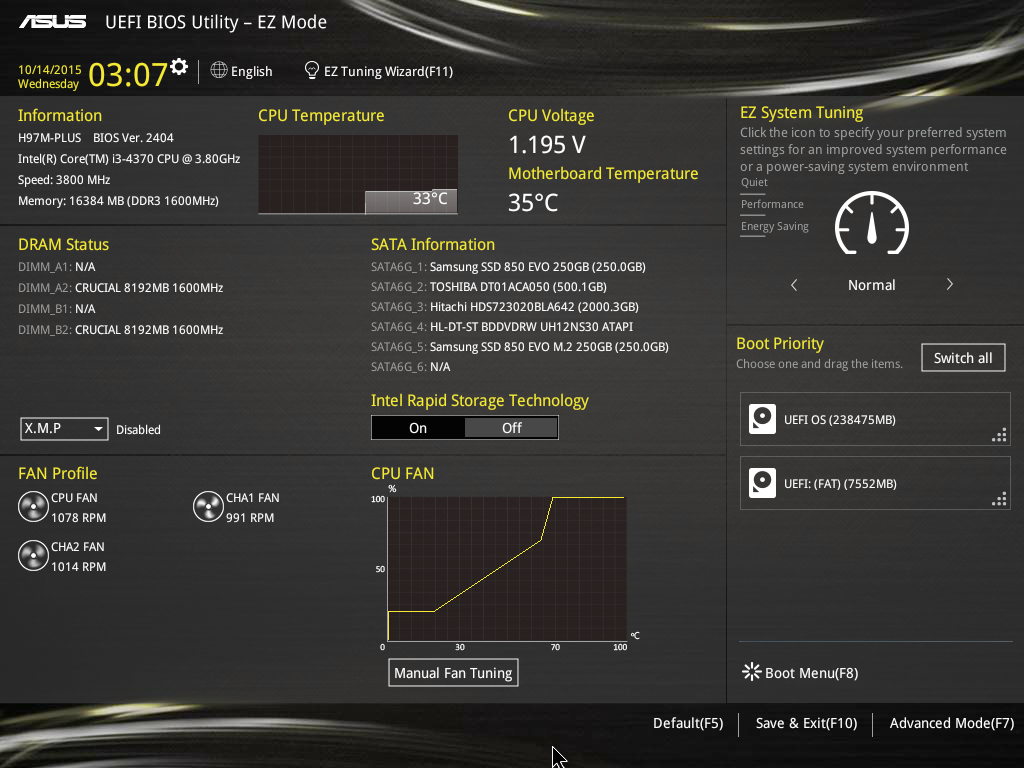

Look at the boot options list in your BIOS. If you see entries that are not physical drives, it is likely that you are encountering some form of this problem.

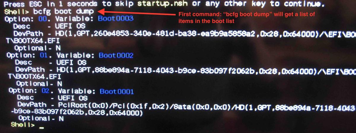

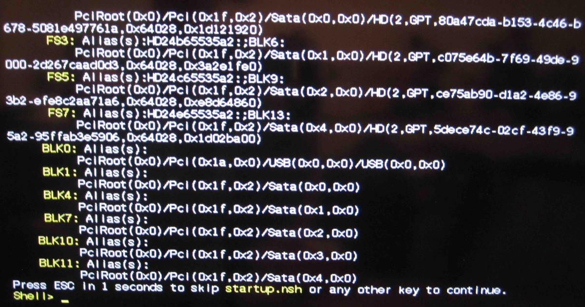

3. Use the right and left arrow keys to select the Clover UEFI Shell and hit enter. The following screen should appear, and either let it time out, or press a key:
4. At the Shell> prompt type

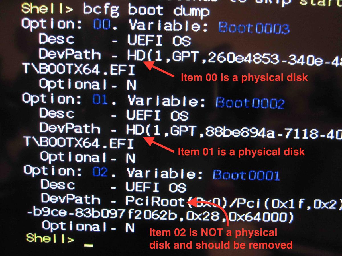

bcfg boot dump
the results should look something like this:
5. You need to remove any entry that is not a physical hard drive. As far as I know, if it is a real physical disk, it will list as DevPath - HD.

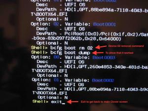

The code to remove an entry looks like this:
bcfg boot rm XX
where XX is the Option number. In this example, I remove Option 02 with
bcfg boot rm 02
If you have a LOT of bogus entries, it is best to do just a few, and then type the command
bcfg boot dump
again before repeating the process. When I first did this on my ASUS H97 board, I had at least 10 entries to clear so it took several iterations of this process.
6. When your have removed all entries that are not physical hard drives, type
exit
and press the return key. This will get you back to the main Clover screen. At this point, I would choose restart from the Clover choices and enter the BIOS to check if your work was successful.

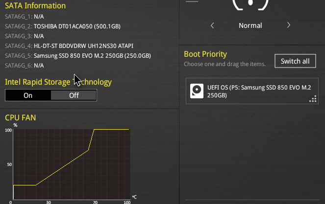

I think you misunderstood. You do not disable all of the internal hard drives except one in the BIOS. To make this work, you need to physically disconnect the drives, leaving only one drive with a boot loader connected to the system. Then you need to look at your boot list in the BIOS. If you still have entries there other than your hard disk, then remove them.
To make it stick, you need to remove the boot loaders from the other disks before you connect them back to your system. This probably means saving the data elsewhere, reformatting the disks and then restoring the data (probably other methods, but I am no expert on this). Or, you could put the drives in an external USB 2.0 or 3.0 case with the boot loaders intact and connect them only when you need them. You shouldn't have a problem with either method.

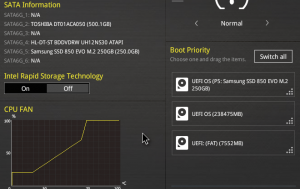

Here is what my BIOS looked like after doing this. The only real boot drive is my M.2 Samsung. [Well, except the other Samsung at the sata1 port - but this is and IDENTICAL CLONE to the boot M.2 drive at sata5, so I think the BIOS is ignoring it in the boot list.] The other "boot" entry is a blank MS-DOS formatted 8GB flash drive that the BIOS thinks for some reason is bootable - this does go away when it is removed. (The 2TB drive is about to be removed and the Samsung at sata1 normally sits in an external case now.)

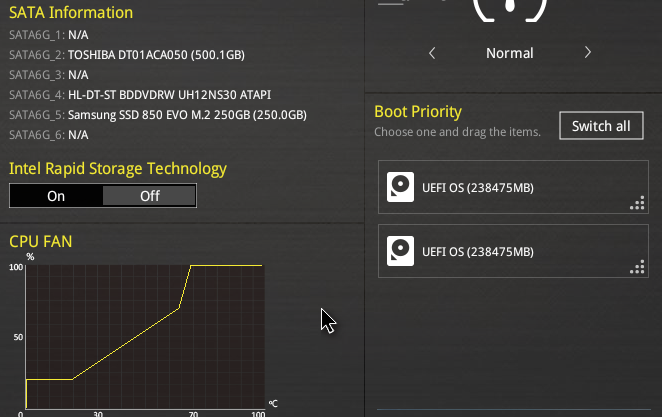

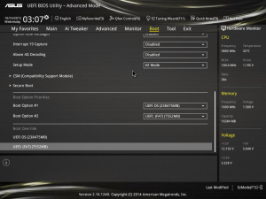

Great. Here is a bit more on this. After messing about with this, I noticed that the entries that I had on the above screen shots did not all look like physical disks. "UEFI OS(238475MB)" is not a physical disk. So I removed the Samsung SSD from sata1, and put it back in its external case. Since it is about to be removed anyway when I get the chance, I disconnected the SATA  and power connectors to the 2TB drive at the same time (it is blank at the moment anyway, and I do not need the storage space). After boot, here is what the relevant parts of the BIOS looked like:
After the first attempt to remove the offending items, it looked like this:
This time there was no physical drive listed with bcfg boot dump, so I deleted all entries and restarted. This is the final result:
Now the system is happy again and back to its stable state.
If I had kept everything connected on my system, it would have just kept adding another "UEFI OS(238475MB)" to the system every time I rebooted. Eventually (as happened before) it would "lock" the BIOS requiring me to go through the "reset CMOS" and then delete the extra entries.
