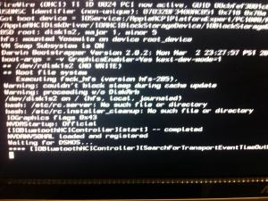

38nic Posted June 6, 2015 Author Share Posted June 6, 2015 Sostituita scheda video con la 9500gt, posto immagine Mi confermate se devo modificare la firma? Grazie Link to comment https://www.insanelymac.com/forum/topic/306272-sistema-compatibile/page/26/#findComment-2142367 Share on other sites More sharing options...
copil Posted June 6, 2015 Share Posted June 6, 2015 Ciao. EFI string la 9500 deve funzionare con le mazzate. Anche io ho tribolato con la mia config. ma forse sono stato fortunato. Link to comment https://www.insanelymac.com/forum/topic/306272-sistema-compatibile/page/26/#findComment-2142392 Share on other sites More sharing options...
38nic Posted June 6, 2015 Author Share Posted June 6, 2015 Come procedere? Grazie Link to comment https://www.insanelymac.com/forum/topic/306272-sistema-compatibile/page/26/#findComment-2142393 Share on other sites More sharing options...

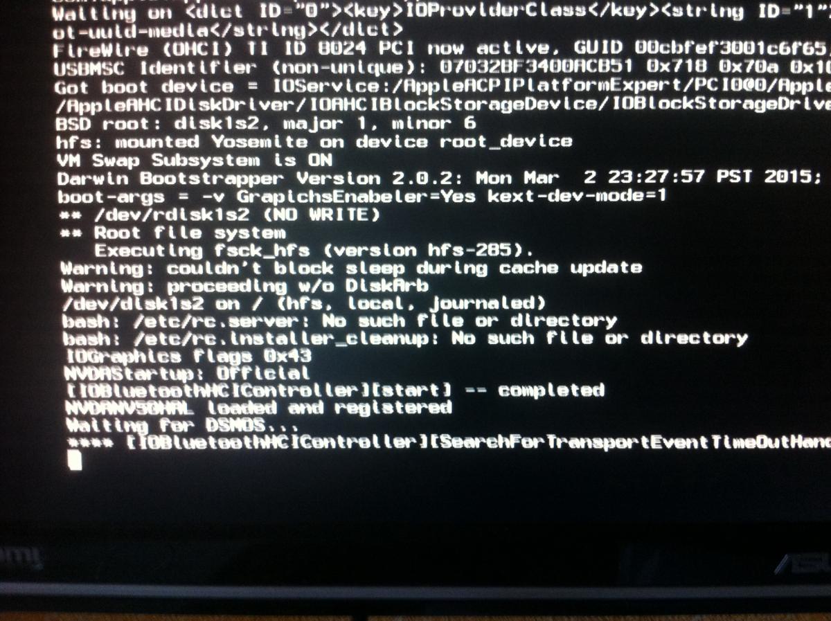

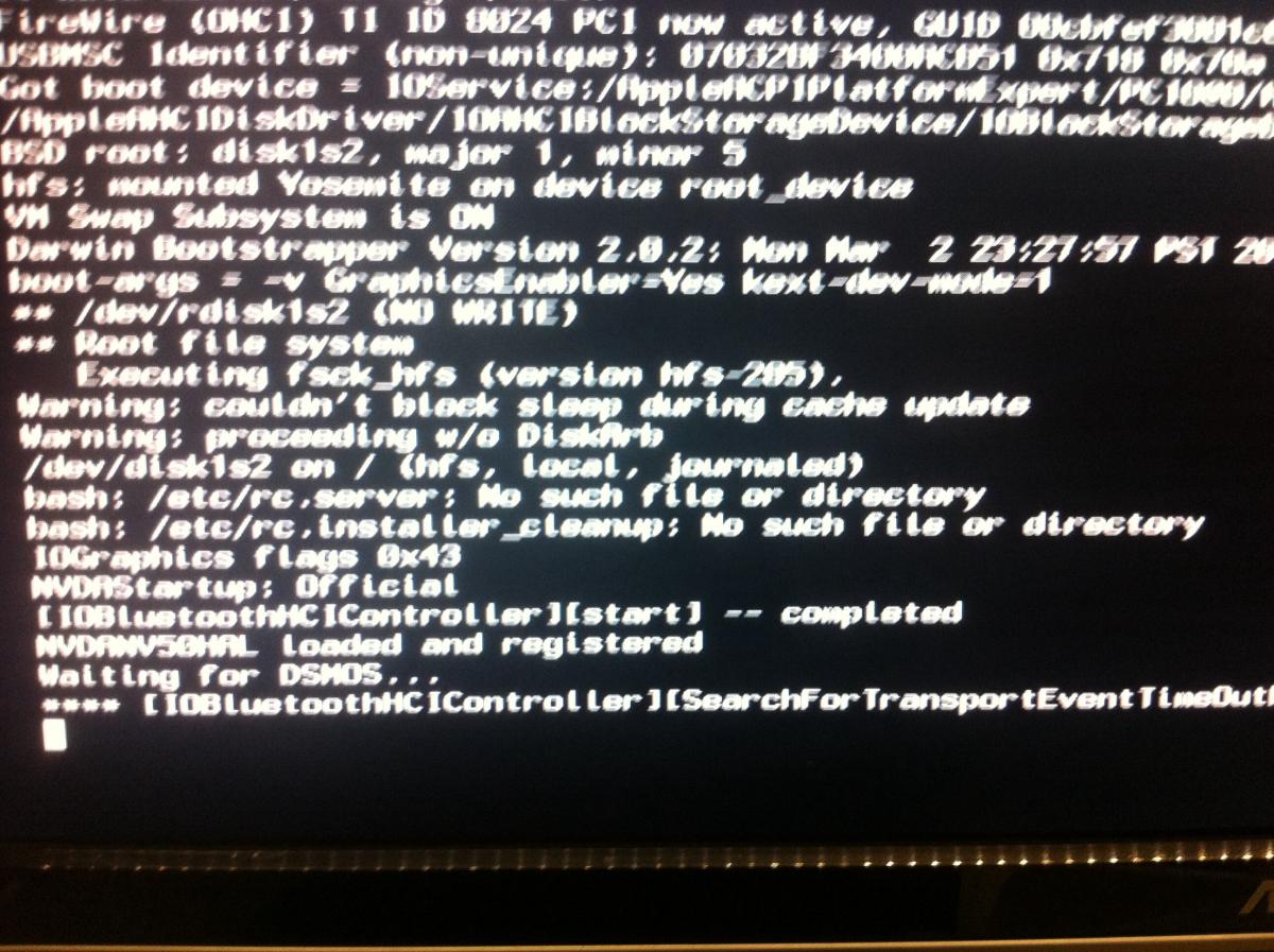

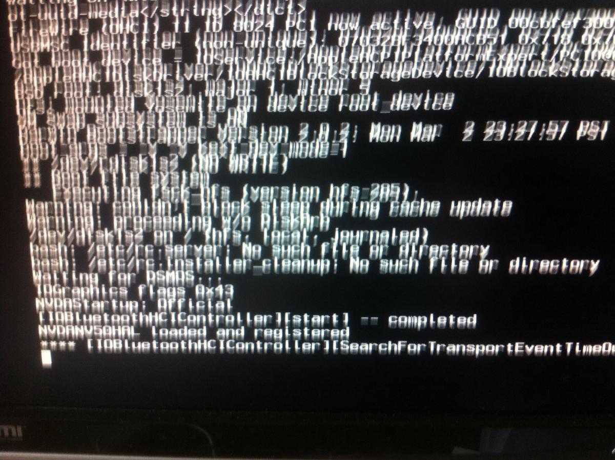

38nic Posted June 7, 2015 Author Share Posted June 7, 2015 In allegato immagine dopo avvio con GraphicsEnabler=Yes Link to comment https://www.insanelymac.com/forum/topic/306272-sistema-compatibile/page/26/#findComment-2142516 Share on other sites More sharing options...

38nic Posted June 7, 2015 Author Share Posted June 7, 2015 Allora, spostata ed avviato con GraphicsEnabler=Yes Solito errore Link to comment https://www.insanelymac.com/forum/topic/306272-sistema-compatibile/page/26/#findComment-2142527 Share on other sites More sharing options...
