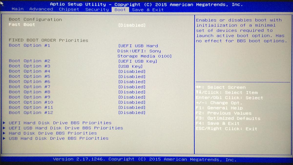

simsie Posted March 5, 2015 Share Posted March 5, 2015 Thanks for all your hard work. I tried to boot from a USB 3.0 drive in the top slot tonight and never could get it to start up. Any tricks (beyond the boot order settings you provided)? I know you had some trouble with slower drives, but even with everything disabled Link to comment Share on other sites More sharing options...
mactabletman Posted March 5, 2015 Author Share Posted March 5, 2015 hmm, no I just made sure the internals were all disabled safe boot was off and all that. The bios werent as picky as i first thought, it was more a matter of having a fast enough usb drive. here is the one im using, i thought it would be garbage when I first bought it, but its pretty much booted every time. Is your drive 3.0? http://www.amazon.com/Lexar-JumpDrive-Flash-LJDS73-16GASBNA-Purple/dp/B007B6YPNO/ref=sr_1_5?ie=UTF8&qid=1425568329&sr=8-5&keywords=lexar+usb+3.0 Link to comment Share on other sites More sharing options...

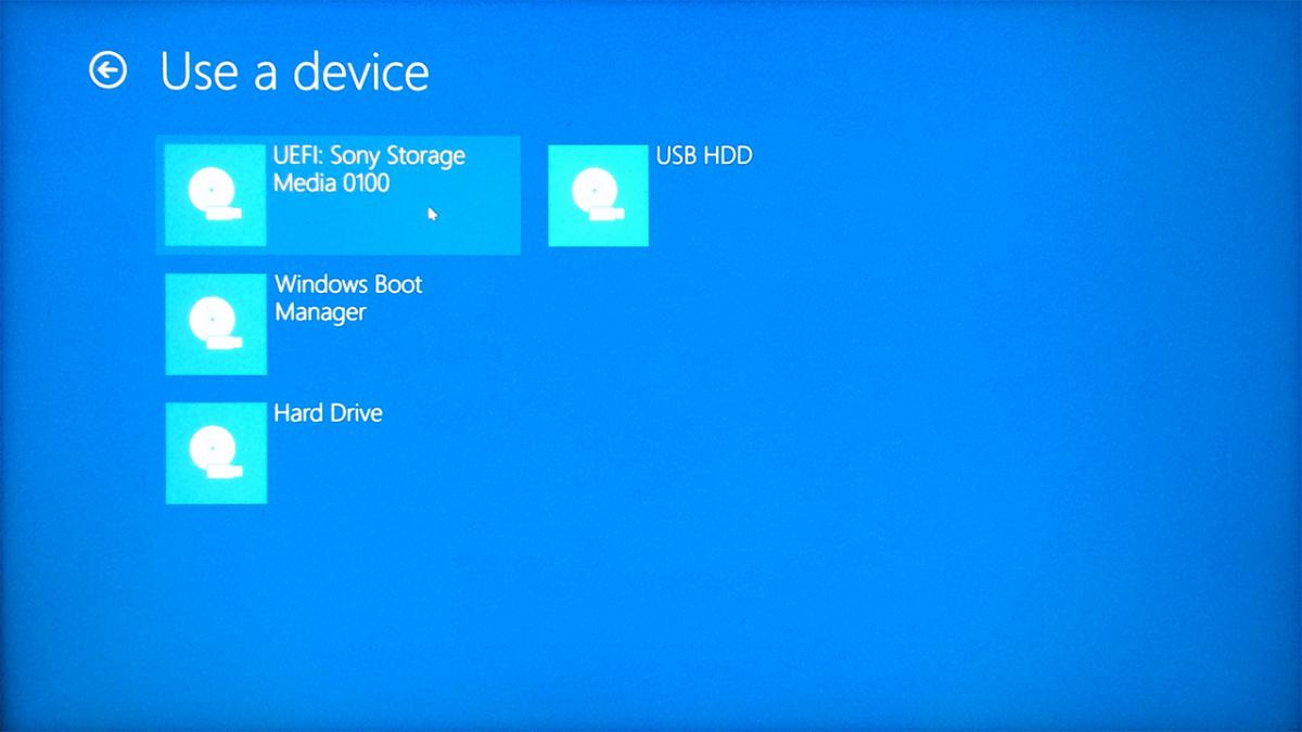

Rino Posted March 19, 2015 Share Posted March 19, 2015 Thank you for re-uploading kexts and updating installation guide. However I cannot make CC2 boot from USB key which is created by using OS X's createinstallmedia and Clover EFI Bootloader 2.3 r3193. In Windows 8.1, there is "Advanced startup" option in Recovery section of PC settings. After restarting by pressing the "restart" button, I selected "Use a device". Choosing appropriate volume of USB key should make CC2 boot from that volume. Unfortunately, CC2 goes to Windows immediately. Even setting fixed boot order priorities as shown in picture, no luck. CC2 goes to Windows. Changing USB key to the fastest one that I own does not change result. What would be missing do you think? PS. Anyway could this post be the cause of black screen after sleep? -- EDIT -- Now I found the install guide says "remove boot options except first one and disable Hard Disk Drive BBS Priorities". Also it mentions that the USB drive should be in the top port. After doing both, CC2 boots into Clover. 1 Link to comment Share on other sites More sharing options...
mactabletman Posted March 20, 2015 Author Share Posted March 20, 2015 Glad you figured out the boot issue, still learning all the ins and outs myself. Thanks for the suggestion on the wake, unfortunately I couldnt find those entries in the DSDT so that isnt it. We will figure it out. Ive been searching like crazy. Link to comment Share on other sites More sharing options...
