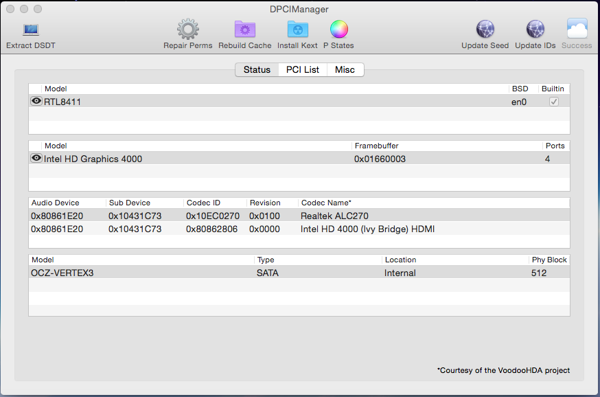

chriz74 Posted February 19, 2015 Author Share Posted February 19, 2015 I booted into Windows and checked from the driver, it says alc 277. DPCI manager with vanilla APPLEHDA kext and the DSDT from above shows this. Battery is now working however I get this boot warning: WARNING: IOPlatformPluginUtil : getCPUIDInfo: this is an unknown CPU model 0x3a -- power management may be incomplete or unsupported ACPI_SMC_PlatformPlugin::pushCPU_CSTData - _CST evaluation failed ACPI_SMC_PlatformPlugin::pushCPU_CSTData - _CST evaluation failed ACPI_SMC_PlatformPlugin::registerLPCDriver - WARNING - LPC device initialization failed: C-state power management not initialized Link to comment https://www.insanelymac.com/forum/topic/304623-battery-dsdt-patch-for-asus-x301a-rehabman/#findComment-2113060 Share on other sites More sharing options...
