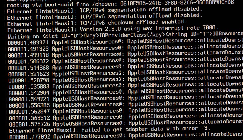

ACIDSkyRU Posted November 22, 2017 Share Posted November 22, 2017 @Mieze Please help i219V not working Mac OS 10.13.2 beta Kext version 2.3.0 log - https://www.dropbox.com/s/wld3161s3vn0prt/123.zip?dl=0 Link to comment https://www.insanelymac.com/forum/topic/304235-intelmausiethernetkext-for-intel-onboard-lan/page/30/#findComment-2538164 Share on other sites More sharing options...
Mieze Posted November 22, 2017 Author Share Posted November 22, 2017 @ACIDSkyRU: Looks like the Intel NIC has been disabled in UEFI setup. Mieze Link to comment https://www.insanelymac.com/forum/topic/304235-intelmausiethernetkext-for-intel-onboard-lan/page/30/#findComment-2538275 Share on other sites More sharing options...

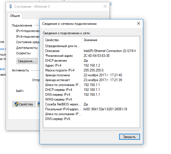

ACIDSkyRU Posted November 22, 2017 Share Posted November 22, 2017 @ACIDSkyRU: Looks like the Intel NIC has been disabled in UEFI setup. Mieze In the BIOS is enabled. Runs in Windows. Link to comment https://www.insanelymac.com/forum/topic/304235-intelmausiethernetkext-for-intel-onboard-lan/page/30/#findComment-2538290 Share on other sites More sharing options...

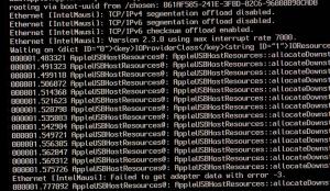

Mieze Posted November 22, 2017 Author Share Posted November 22, 2017 @ACIDSkyRU: Use the debug version of the driver to collect more detailed logs and report back with log data containing at least one complete boot sequence. Please don't upload the complete file as it's no fun to search for log messages in a > 500MB file. Mieze Link to comment https://www.insanelymac.com/forum/topic/304235-intelmausiethernetkext-for-intel-onboard-lan/page/30/#findComment-2538350 Share on other sites More sharing options...
ACIDSkyRU Posted November 22, 2017 Share Posted November 22, 2017 Link to comment https://www.insanelymac.com/forum/topic/304235-intelmausiethernetkext-for-intel-onboard-lan/page/30/#findComment-2538361 Share on other sites More sharing options...
Mieze Posted November 22, 2017 Author Share Posted November 22, 2017 IMG_3553.jpg The management engine is in control of the NIC so that the driver is unable to take control. Make sure that the UEFI network stack and any remote management function is disabled in UEFI setup. Mieze Link to comment https://www.insanelymac.com/forum/topic/304235-intelmausiethernetkext-for-intel-onboard-lan/page/30/#findComment-2538368 Share on other sites More sharing options...
TheRacerMaster Posted November 22, 2017 Share Posted November 22, 2017 This is probably a GbE firmware or ME issue. I encountered the same -3 error (with e1000e in Linux) when I was running coreboot (perhaps the GbE region wasn't being used?). You may want to try reflashing your firmware. 1 Link to comment https://www.insanelymac.com/forum/topic/304235-intelmausiethernetkext-for-intel-onboard-lan/page/30/#findComment-2538374 Share on other sites More sharing options...

ACIDSkyRU Posted November 22, 2017 Share Posted November 22, 2017 Nothing helped. Rolled back BIOS to older versions. On the website Tony, there are reports on the plant of my Board (ASUS Z170i gaming pro) and it works. There is a possibility of conflict with Lilu.kext and plugins? Link to comment https://www.insanelymac.com/forum/topic/304235-intelmausiethernetkext-for-intel-onboard-lan/page/30/#findComment-2538451 Share on other sites More sharing options...
Mieze Posted November 22, 2017 Author Share Posted November 22, 2017 Nothing helped. Rolled back BIOS to older versions. On the website Tony, there are reports on the plant of my Board (ASUS Z170i gaming pro) and it works. There is a possibility of conflict with Lilu.kext and plugins? Provided the BIOS updates also contain a ME firmware update, have you chosen to update the ME firmware too while installing the BIOS update? I don't think that a Lilu plugin is causing the driver failure, at least I have no reason to assume it might be but, as not all of them are open source, it's hard to rule out completely. Please post an IOReg dump. Use version 3.0.2 of IORegistryExplorer to create the dump. Mieze Link to comment https://www.insanelymac.com/forum/topic/304235-intelmausiethernetkext-for-intel-onboard-lan/page/30/#findComment-2538488 Share on other sites More sharing options...
ACIDSkyRU Posted November 23, 2017 Share Posted November 23, 2017 Provided the BIOS updates also contain a ME firmware update, have you chosen to update the ME firmware too while installing the BIOS update? I don't think that a Lilu plugin is causing the driver failure, at least I have no reason to assume it might be but, as not all of them are open source, it's hard to rule out completely. Please post an IOReg dump. Use version 3.0.2 of IORegistryExplorer to create the dump. Mieze dump attached iMac.zip Link to comment https://www.insanelymac.com/forum/topic/304235-intelmausiethernetkext-for-intel-onboard-lan/page/30/#findComment-2538562 Share on other sites More sharing options...
Slice Posted November 23, 2017 Share Posted November 23, 2017 @Mieze May be you already know this, may be no LAN Disable register A0h, bit0=1 -> disable LAN controller Is it causing such error? Link to comment https://www.insanelymac.com/forum/topic/304235-intelmausiethernetkext-for-intel-onboard-lan/page/30/#findComment-2538683 Share on other sites More sharing options...
Mieze Posted November 23, 2017 Author Share Posted November 23, 2017 (edited) @Mieze May be you already know this, may be no LAN Disable register A0h, bit0=1 -> disable LAN controller Is it causing such error? The driver fails with "Failed to get adapter data with error -3." which means that the NIC's flash region isn't mapped but I have no idea why. Mieze EDIT: Have you enabled FixRegions in your Clover config file? Edited November 23, 2017 by Mieze Link to comment https://www.insanelymac.com/forum/topic/304235-intelmausiethernetkext-for-intel-onboard-lan/page/30/#findComment-2538701 Share on other sites More sharing options...
ACIDSkyRU Posted November 23, 2017 Share Posted November 23, 2017 The driver fails with "Failed to get adapter data with error -3." which means that the NIC's flash region isn't mapped but I have no idea why. Mieze EDIT: Have you enabled FixRegions in your Clover config file? I blocked in the BIOS the option "IOAPIC 24-119 Entries" error was - "failed to get adapter data with error -2" Link to comment https://www.insanelymac.com/forum/topic/304235-intelmausiethernetkext-for-intel-onboard-lan/page/30/#findComment-2538835 Share on other sites More sharing options...
Mieze Posted November 23, 2017 Author Share Posted November 23, 2017 I blocked in the BIOS the option "IOAPIC 24-119 Entries" error was - "failed to get adapter data with error -2" The screenshot you posted yesterday shows error -3 but error -2 means that there is a problem with the PHY which is most likely still under control of the management engine (ME). Link to comment https://www.insanelymac.com/forum/topic/304235-intelmausiethernetkext-for-intel-onboard-lan/page/30/#findComment-2538838 Share on other sites More sharing options...
