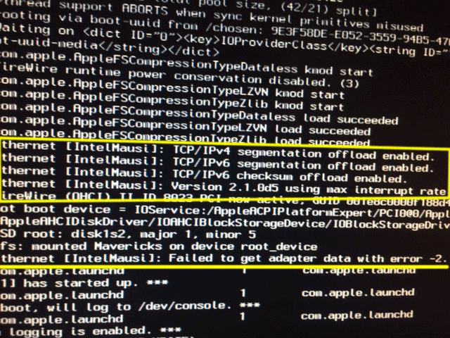

@Peerke: Please post your kernel logs showing the incident.
Mieze
Ok, this part comes from the console tool, as 'grep kernel /var/log/system.log' doesn't do a lot in 10.12.1.

default 22:53:50.260769 +0100 CommCenter #watchdog #I Callback Watchdog: checkin 16
default 22:53:50.260844 +0100 CommCenter #watchdog #I Server Watchdog: checkin 16
default 22:53:50.277618 +0100 kernel Ethernet [intelMausi]: Tx stalled? Resetting chipset. txDirtyDescIndex=0, STATUS=0x00080083, TCTL=0x3103f0fa.
default 22:53:50.277640 +0100 kernel Ethernet [intelMausi]: desc[1004]: lower=0xab100042, upper=0x00000301, addr=0x000000003bec37aa, mbuf=0x0000000000000000, len=66.
default 22:53:50.277644 +0100 kernel Ethernet [intelMausi]: desc[1005]: lower=0x23000000, upper=0x00000000, addr=0x000032220021180e, mbuf=0x0000000000000000, len=2.
default 22:53:50.277647 +0100 kernel Ethernet [intelMausi]: desc[1006]: lower=0x20100042, upper=0x00000300, addr=0x000000003becfcaa, mbuf=0x0000000000000000, len=66.
default 22:53:50.277649 +0100 kernel Ethernet [intelMausi]: desc[1007]: lower=0xab10001f, upper=0x00000301, addr=0x000000003bdaf7a8, mbuf=0x0000000000000000, len=31.
default 22:53:50.277652 +0100 kernel Ethernet [intelMausi]: desc[1008]: lower=0x23000000, upper=0x00000000, addr=0x000032220021180e, mbuf=0x0000000000000000, len=1.
default 22:53:50.277655 +0100 kernel Ethernet [intelMausi]: desc[1009]: lower=0xab100042, upper=0x00000301, addr=0x000000003bdaaeaa, mbuf=0x0000000000000000, len=66.
default 22:53:50.277658 +0100 kernel Ethernet [intelMausi]: desc[1010]: lower=0x23000000, upper=0x00000000, addr=0x000032220021180e, mbuf=0x0000000000000000, len=1.
default 22:53:50.277660 +0100 kernel Ethernet [intelMausi]: desc[1011]: lower=0xab100042, upper=0x00000301, addr=0x000000003becddaa, mbuf=0x0000000000000000, len=66.
default 22:53:50.277663 +0100 kernel Ethernet [intelMausi]: desc[1012]: lower=0x23000000, upper=0x00000000, addr=0x000032220021180e, mbuf=0x0000000000000000, len=1.
default 22:53:50.277665 +0100 kernel Ethernet [intelMausi]: desc[1013]: lower=0xab100042, upper=0x00000301, addr=0x000000003beccdaa, mbuf=0x0000000000000000, len=66.
default 22:53:50.277668 +0100 kernel Ethernet [intelMausi]: desc[1014]: lower=0x23000000, upper=0x00000000, addr=0x000032220021180e, mbuf=0x0000000000000000, len=1.
default 22:53:50.277670 +0100 kernel Ethernet [intelMausi]: desc[1015]: lower=0xab100042, upper=0x00000301, addr=0x000000003becb1aa, mbuf=0x0000000000000000, len=66.
default 22:53:50.277673 +0100 kernel Ethernet [intelMausi]: desc[1016]: lower=0x23000000, upper=0x00000000, addr=0x000032220021180e, mbuf=0x0000000000000000, len=2.
default 22:53:50.277690 +0100 kernel Ethernet [intelMausi]: desc[1017]: lower=0x20100042, upper=0x00000300, addr=0x000000003c0080aa, mbuf=0x0000000000000000, len=66.
default 22:53:50.277692 +0100 kernel Ethernet [intelMausi]: desc[1018]: lower=0xab10001f, upper=0x00000301, addr=0x000000003bdadba8, mbuf=0x0000000000000000, len=31.
default 22:53:50.277695 +0100 kernel Ethernet [intelMausi]: desc[1019]: lower=0x23000000, upper=0x00000000, addr=0x000032220021180e, mbuf=0x0000000000000000, len=1.
default 22:53:50.277710 +0100 kernel Ethernet [intelMausi]: desc[1020]: lower=0xab100042, upper=0x00000301, addr=0x000000003c0080aa, mbuf=0x0000000000000000, len=66.
default 22:53:50.277712 +0100 kernel Ethernet [intelMausi]: desc[1021]: lower=0x23000000, upper=0x00000000, addr=0x000032220021180e, mbuf=0x0000000000000000, len=1.
default 22:53:50.277715 +0100 kernel Ethernet [intelMausi]: desc[1022]: lower=0xab100042, upper=0x00000301, addr=0x000000003bdadbaa, mbuf=0x0000000000000000, len=66.
default 22:53:50.277718 +0100 kernel Ethernet [intelMausi]: desc[1023]: lower=0x23000000, upper=0x00000000, addr=0x000032220021180e, mbuf=0x0000000000000000, len=1.
default 22:53:50.277733 +0100 kernel Ethernet [intelMausi]: desc[0]: lower=0x8b00002a, upper=0x00000000, addr=0x000000003bec5ba8, mbuf=0xffffff820f3ccb00, len=42.
default 22:53:50.277735 +0100 kernel Ethernet [intelMausi]: desc[1]: lower=0x8b000156, upper=0x00000000, addr=0x000000003bfcd000, mbuf=0xffffff820f3d7c00, len=342.
default 22:53:50.277737 +0100 kernel Ethernet [intelMausi]: desc[2]: lower=0x8b000056, upper=0x00000000, addr=0x000000003c015802, mbuf=0xffffff820f3cbb00, len=86.
default 22:53:50.277740 +0100 kernel Ethernet [intelMausi]: desc[3]: lower=0x8b00003e, upper=0x00000000, addr=0x000000003befe4c2, mbuf=0xffffff820f405400, len=62.
default 22:53:50.277742 +0100 kernel Ethernet [intelMausi]: desc[4]: lower=0x8b00002a, upper=0x00000000, addr=0x000000003bec6ca8, mbuf=0xffffff820f3cdc00, len=42.
default 22:53:50.277744 +0100 kernel Ethernet [intelMausi]: desc[5]: lower=0x8b00002a, upper=0x00000000, addr=0x000000003beeeba8, mbuf=0xffffff820f3f5b00, len=42.
default 22:53:50.277746 +0100 kernel Ethernet [intelMausi]: desc[6]: lower=0x8b00002a, upper=0x00000000, addr=0x000000003bec29a8, mbuf=0xffffff820f3c9900, len=42.
default 22:53:50.277763 +0100 kernel Ethernet [intelMausi]: desc[7]: lower=0x20000000, upper=0x00000000, addr=0x00003c360000000e, mbuf=0x0000000000000000, len=2.
default 22:53:50.277766 +0100 kernel Ethernet [intelMausi]: desc[8]: lower=0x2010003e, upper=0x00000200, addr=0x000000003beef5c2, mbuf=0x0000000000000000, len=62.
default 22:53:50.277768 +0100 kernel Ethernet [intelMausi]: desc[9]: lower=0xab100040, upper=0x00000200, addr=0x000000003bec69c0, mbuf=0xffffff820f3f6500, len=64.
default 22:53:50.277770 +0100 kernel Ethernet [intelMausi]: packet size=42, header size=42.
default 22:53:50.277781 +0100 kernel Ethernet [intelMausi]: Link down on en0
default 22:53:50.277828 +0100 kernel Ethernet [intelMausi]: Flushing tx descriptor ring.
default 22:53:50.278859 +0100 kernel Ethernet [intelMausi]: Flushing rx descriptor ring.

default 22:53:54.873770 +0100 kernel Ethernet [intelMausi]: checkLinkStatus() returned 1.
default 22:53:54.874837 +0100 kernel Ethernet [intelMausi]: EEE mode = 0x0000, adv=0x0006, lpa=0x0000
default 22:53:54.874910 +0100 kernel Ethernet [intelMausi]: pollIntervalTime: 170us
default 22:53:54.874915 +0100 kernel Ethernet [intelMausi]: Link up on en0, 1-Gigabit, Full-duplex, No flow-control
default 22:53:54.874918 +0100 kernel Ethernet [intelMausi]: requireMaxBusStall(75000ns).
default 22:53:54.874920 +0100 kernel Ethernet [intelMausi]: CTRL=0x40180240
default 22:53:54.874922 +0100 kernel Ethernet [intelMausi]: CTRL_EXT=0x995a1026
default 22:53:54.874924 +0100 kernel Ethernet [intelMausi]: STATUS=0x00080083
default 22:53:54.874930 +0100 kernel Ethernet [intelMausi]: RCTL=0x04008002
default 22:53:54.874932 +0100 kernel Ethernet [intelMausi]: PSRCTL=0x00040402
default 22:53:54.874934 +0100 kernel Ethernet [intelMausi]: FCRTL=0x80005048
default 22:53:54.874938 +0100 kernel Ethernet [intelMausi]: FCRTH=0x00005c20
default 22:53:54.874940 +0100 kernel Ethernet [intelMausi]: RDLEN(0)=0x00002000
default 22:53:54.874942 +0100 kernel Ethernet [intelMausi]: RDTR=0x00000000
default 22:53:54.874944 +0100 kernel Ethernet [intelMausi]: RADV=0x00000000
default 22:53:54.874946 +0100 kernel Ethernet [intelMausi]: RXCSUM=0x00002300
default 22:53:54.874948 +0100 kernel Ethernet [intelMausi]: RFCTL=0x000380c0
default 22:53:54.874950 +0100 kernel Ethernet [intelMausi]: RXDCTL(0)=0x00010000
default 22:53:54.874952 +0100 kernel Ethernet [intelMausi]: RAL(0)=0xa49950d0
default 22:53:54.874954 +0100 kernel Ethernet [intelMausi]: RAH(0)=0x8000a0b1
default 22:53:54.874956 +0100 kernel Ethernet [intelMausi]: MRQC=0x00370001
default 22:53:54.874958 +0100 kernel Ethernet [intelMausi]: TARC(0)=0x0d800403
default 22:53:54.874960 +0100 kernel Ethernet [intelMausi]: TARC(1)=0x45000403
default 22:53:54.874963 +0100 kernel Ethernet [intelMausi]: TCTL=0x3103f0fa
default 22:53:54.874965 +0100 kernel Ethernet [intelMausi]: TXDCTL(0)=0x01410000
default 22:53:54.874967 +0100 kernel Ethernet [intelMausi]: TXDCTL(1)=0x01410000
default 22:53:54.874969 +0100 kernel Ethernet [intelMausi]: TADV=0x0000001c
default 22:53:54.874971 +0100 kernel Ethernet [intelMausi]: TIDV=0x0000001c
default 22:53:54.874973 +0100 kernel Ethernet [intelMausi]: MANC=0x00e20000
default 22:53:54.874975 +0100 kernel Ethernet [intelMausi]: MANC2H=0x81020580
default 22:53:54.874977 +0100 kernel Ethernet [intelMausi]: LTRV=0x88b988b9
default 22:53:54.874979 +0100 kernel Ethernet [intelMausi]: PBA=0x0006001a
default 22:53:54.874985 +0100 kernel getPacketFilters() ===>
default 22:53:54.874986 +0100 kernel getPacketFilters() <===
default 22:53:54.877462 +0100 symptomsd SCDynamicStore config_callback: k: State:/Network/Interface/en0/Link
default 22:53:54.877597 +0100 kernel setMulticastList() ===>
default 22:53:54.877611 +0100 kernel setMulticastList() <===
default 22:53:54.877624 +0100 kernel setMulticastList() ===>
default 22:53:54.877635 +0100 kernel setMulticastList() <===
default 22:53:54.877642 +0100 kernel setMulticastList() ===>
default 22:53:54.877653 +0100 kernel setMulticastList() <===
default 22:53:54.879545 +0100 symptomsd SCDynamicStore config_callback: k: State:/Network/Interface/en0/IPv6
default 22:53:54.909844 +0100 mDNSResponder mDNS_RegisterInterface: Frequent transitions for interface en0 (FE80:0000:0000:0000:1807:4B0C:A1BF:DC82)
default 22:53:54.909637 +0100 kernel setMulticastList() ===>
default 22:53:54.909653 +0100 kernel setMulticastList() <===
default 22:53:54.909681 +0100 kernel setMulticastList() ===>
default 22:53:54.909693 +0100 kernel setMulticastList() <===
default 22:53:55.875146 +0100 kernel Ethernet [intelMausi]: Check tx ring for progress. txNumFreeDesc=1012
default 22:53:55.880096 +0100 symptomsd SCDynamicStore config_callback: k: State:/Network/Interface/en0/IPv6
default 22:53:55.948530 +0100 deleted Not sending notification.
default 22:53:55.948554 +0100 deleted persistence timer fired
default 22:53:56.875639 +0100 kernel Ethernet [intelMausi]: Tx stalled? Resetting chipset. txDirtyDescIndex=0, STATUS=0x00080083, TCTL=0x3103f0fa.
default 22:53:56.875664 +0100 kernel Ethernet [intelMausi]: desc[1004]: lower=0xab100042, upper=0x00000301, addr=0x000000003bec37aa, mbuf=0x0000000000000000, len=66.
default 22:53:56.875676 +0100 kernel Ethernet [intelMausi]: desc[1005]: lower=0x23000000, upper=0x00000000, addr=0x000032220021180e, mbuf=0x0000000000000000, len=2.
default 22:53:56.875687 +0100 kernel Ethernet [intelMausi]: desc[1006]: lower=0x20100042, upper=0x00000300, addr=0x000000003becfcaa, mbuf=0x0000000000000000, len=66.
default 22:53:56.875698 +0100 kernel Ethernet [intelMausi]: desc[1007]: lower=0xab10001f, upper=0x00000301, addr=0x000000003bdaf7a8, mbuf=0x0000000000000000, len=31.

At the moment I have not worked on my MB intel DP55WB when i try Mavericks and it generates this error. I need a hand, thank you.
The UEFI network stack or some kind of remote management software is still in control of the NIC preventing the driver from taking control. Check you UEFI settings and disable it.
Mieze
