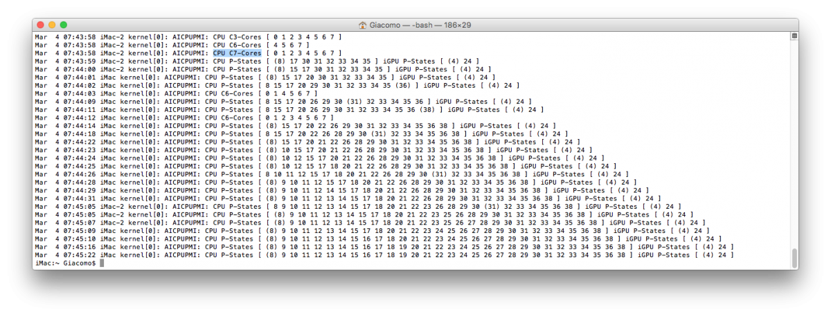

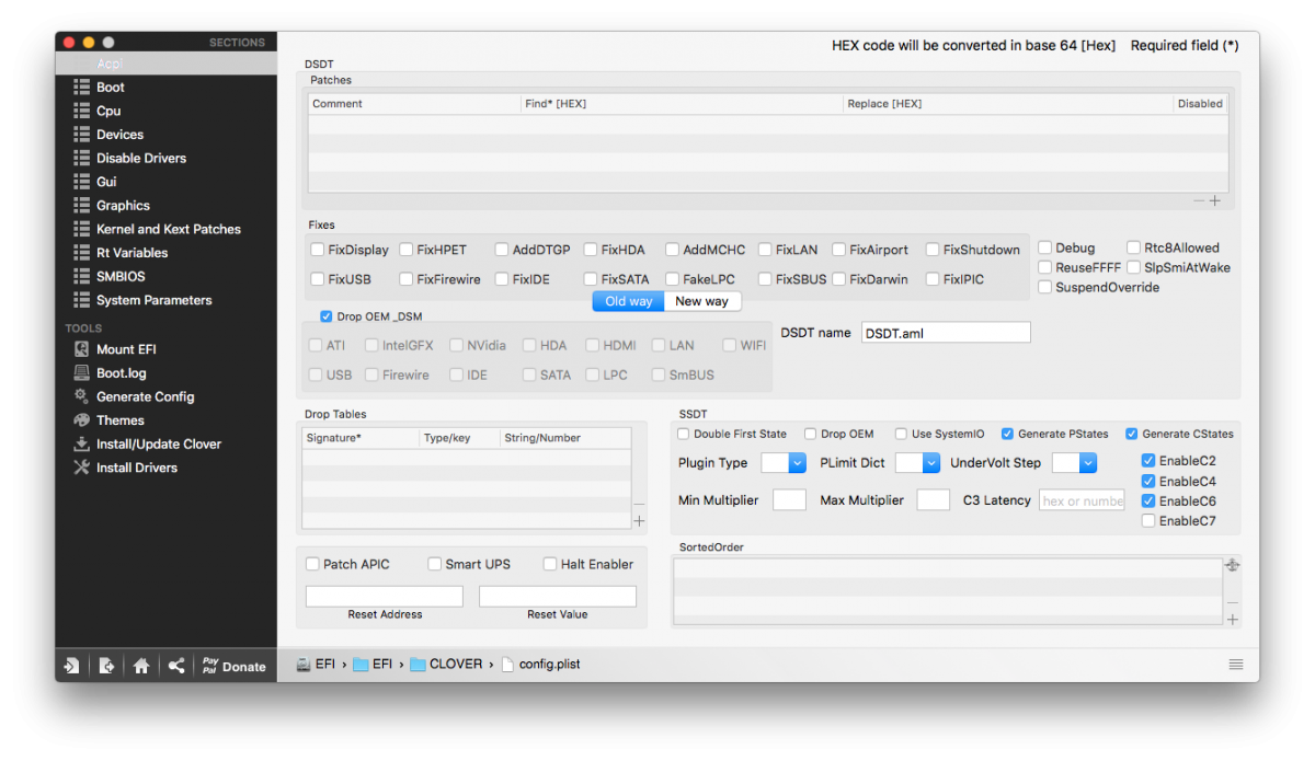

giacomoleopardo Posted March 4, 2016 Share Posted March 4, 2016 Using Clover to create the C-states seems to work better than using ssdtPRGen.sh because it uses higher values for the C-state exit lantencies. You mean something like this in config.plist? Still, C7 is present, though Link to comment https://www.insanelymac.com/forum/topic/304235-intelmausiethernetkext-for-intel-onboard-lan/page/19/#findComment-2220449 Share on other sites More sharing options...

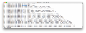

Mieze Posted March 4, 2016 Author Share Posted March 4, 2016 Yes, but it isn't that easy to get rid of C7. My knowledge about CPU power management is limited, I'm still learning too but even removing it from the SSDT doesn't prevent the CPU from entering C7. For detailed statistics of C-State residency every 5 seconds, open Terminal and type: sudo powermetrics --hide-cpu-duty-cycle Mieze Link to comment https://www.insanelymac.com/forum/topic/304235-intelmausiethernetkext-for-intel-onboard-lan/page/19/#findComment-2220501 Share on other sites More sharing options...

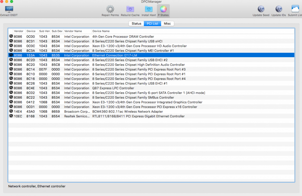

Kiphaas7 Posted March 27, 2016 Share Posted March 27, 2016 Hi Mieze, for some reason my intel I217LM controller is not even showing up in system report/ethernet cards. (Ethernet is part of the Asus Q87T mobo). network boot and UEFI network stack is disabled not running any of the npc bootflags running the latest v2.1.0d3 from your posts, and placed it in EFI/CLOVER/kexts/10.11 deleted my netwerk preferences multiple times deleted kext caches multiple times (using kext wizard) log from one boot up is attached. Kext seems to be loading, but exits with error: Mar 27 00:42:36 localhost kernel[0]: Ethernet [IntelMausi]: maxSnoop: 0x0846, maxNoSnoop: 0x0000. Mar 27 00:42:36 localhost kernel[0]: Ethernet [IntelMausi]: TCP/IPv4 segmentation offload enabled. Mar 27 00:42:36 localhost kernel[0]: Ethernet [IntelMausi]: TCP/IPv6 segmentation offload enabled. Mar 27 00:42:36 localhost kernel[0]: Ethernet [IntelMausi]: TCP/IPv6 checksum offload enabled. Mar 27 00:42:36 localhost kernel[0]: Ethernet [IntelMausi]: Version 2.1.0d3 using max interrupt rate 7000. Please don't support tonymacx86.com! Mar 27 00:42:36 localhost kernel[0]: Ethernet [IntelMausi]: intrThrValue=557 Mar 27 00:42:36 localhost kernel[0]: Ethernet [IntelMausi]: PCI power management capabilities: 0xc822. Mar 27 00:42:36 localhost kernel[0]: Ethernet [IntelMausi]: PME# from D3 (cold/hot) supported. Mar 27 00:42:36 localhost kernel[0]: Ethernet [IntelMausi]: Failed to get adapter data with error -2.I'm at a loss why this isn't working...test.log.zip Link to comment https://www.insanelymac.com/forum/topic/304235-intelmausiethernetkext-for-intel-onboard-lan/page/19/#findComment-2227577 Share on other sites More sharing options...
Mieze Posted March 27, 2016 Author Share Posted March 27, 2016 @Kiphaas7: I've already seen this problem some time ago and I think that's it has got to do with the ME blocking access to the PHY due to enabled AMT. Have you tried to disable AMT in BIOS? Mieze Link to comment https://www.insanelymac.com/forum/topic/304235-intelmausiethernetkext-for-intel-onboard-lan/page/19/#findComment-2227706 Share on other sites More sharing options...
Kiphaas7 Posted March 27, 2016 Share Posted March 27, 2016 @Kiphaas7: I've already seen this problem some time ago and I think that's it has got to do with the ME blocking access to the PHY due to enabled AMT. Have you tried to disable AMT in BIOS? Mieze Thanks for your quick reply! Unfortunately, that did not help. I just disabled AMT in BIOS and I still get the same IntelMausi messages in my system log. Link to comment https://www.insanelymac.com/forum/topic/304235-intelmausiethernetkext-for-intel-onboard-lan/page/19/#findComment-2227728 Share on other sites More sharing options...
Kiphaas7 Posted March 28, 2016 Share Posted March 28, 2016 Not sure if it will help, but I ran DPCIManager, and it does show my intel ethernet connection (see screenshot). (For what it's worth, the Realtek shows up just fine with its third party kext.) Link to comment https://www.insanelymac.com/forum/topic/304235-intelmausiethernetkext-for-intel-onboard-lan/page/19/#findComment-2227976 Share on other sites More sharing options...
Mieze Posted March 28, 2016 Author Share Posted March 28, 2016 Not sure if it will help, but I ran DPCIManager, and it does show my intel ethernet connection (see screenshot). No, it doesn't help because the problem is that the driver can't access the NIC's PHY because the ME is still in control of it. That's why the initialization fails. Mieze 1 Link to comment https://www.insanelymac.com/forum/topic/304235-intelmausiethernetkext-for-intel-onboard-lan/page/19/#findComment-2227993 Share on other sites More sharing options...
Kiphaas7 Posted March 28, 2016 Share Posted March 28, 2016 After scouring the motherboard manual a few times, I did find a physical jumper related to Intel ME. However, setting that to disabled makes OS X unbootable, not even my usb stick I used to install. Aside from that, can you nudge me in a direction how to fix this myself? Try different BIOS versions? DSDT fixes? Or is it pretty much unfixable? Link to comment https://www.insanelymac.com/forum/topic/304235-intelmausiethernetkext-for-intel-onboard-lan/page/19/#findComment-2228155 Share on other sites More sharing options...

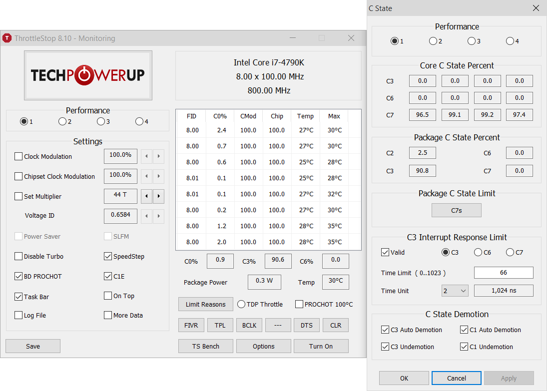

Quadie Posted April 13, 2016 Share Posted April 13, 2016 ...Ok, let's go into the details. As already mentioned, the real reason for the problems the driver is experiencing sometimes is the fact that the NIC's DMA operations may fail due to exceeded latency tolerance requirements when the CPU is in C7 sleep state. Most devices handle this in hardware using a standard PCIe mechanism to avoid problems but the Intel onboard NICs are different. See https://lwn.net/Articles/384146/ for an in deep explanation. Unfortunately, El Capitan’s power management is quite aggressive, it tries to put the cores into the deepest sleep state C7 whenever possible and this is the reason why it became worse with El Capitan, in particular with powerful Core i7 CPUs because they spend much more time in a sleep state than a poor Core i3. I ran a few tests under Windows 10 on my machine and found out that it doesn’t use C7 at all. The deepest state the CPU ever reaches running Win 10 is C6 so that stable operation of the NIC is guaranteed. Unfortunately OS X never seems to put the CPU into C6, it only chooses between C3 and C7... Are you sure about this? More importantly are we talking Core States or Package States? Under Windows 8, 8.1 and 10 my CPU cores (4790K) regularly hit C7 when idle/low load, but my package state only hits C3. Also I remember reading somewhere (might have been a Intel doc) that the CPU will only drop into Package C7 if using the iGPU, else it will use Package C6. Link to comment https://www.insanelymac.com/forum/topic/304235-intelmausiethernetkext-for-intel-onboard-lan/page/19/#findComment-2231948 Share on other sites More sharing options...
Mieze Posted April 13, 2016 Author Share Posted April 13, 2016 Are you sure about this? More importantly are we talking Core States or Package States? Under Windows 8, 8.1 and 10 my CPU cores (4790K) regularly hit C7 when idle/low load, but my package state only hits C3. Also I remember reading somewhere (might have been a intel doc) that the CPU will only drop into Package C7 if using the iGPU, else it will use Package C6. Yes, I am and I was talking about Core C-States as these are selected by OS directed power management according to the configuration in the SSDT whereas Package C-States are selected by the hardware itself whenever possible, provided they haven't been disabled completely. By the way, Windows has a kernel API which allows drivers to communicate their latency requirements, which is something that OS X lacks. Mieze 1 Link to comment https://www.insanelymac.com/forum/topic/304235-intelmausiethernetkext-for-intel-onboard-lan/page/19/#findComment-2231951 Share on other sites More sharing options...
Quadie Posted April 13, 2016 Share Posted April 13, 2016 Fair enough, I was just confused by you saying Windows will only hit C6. Keep up the good work and stop by the hoob chat sometime. 1 Link to comment https://www.insanelymac.com/forum/topic/304235-intelmausiethernetkext-for-intel-onboard-lan/page/19/#findComment-2231952 Share on other sites More sharing options...
