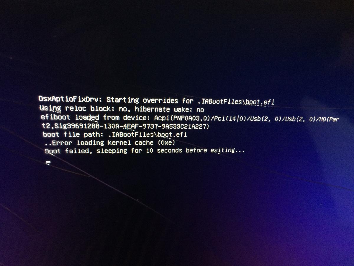

calreid Posted January 30, 2015 Share Posted January 30, 2015 I've tried now with both a USB 2.0 drive and a USB 3.0, with the correct 10.10 installer and the result is in the attached image. The result is the same with Injected kexts and cache with or without -x safe boot. Had a google around other threads but haven't managed to find a way around it yet, as i mentioned earlier i have tried the suggested alternate config file. Using the latest version of Clover for the USB drives. Link to comment https://www.insanelymac.com/forum/topic/301884-guide-surface-pro-1st-gen-yosemite-clean-installation/page/8/#findComment-2107025 Share on other sites More sharing options...

Ayane Posted February 4, 2015 Share Posted February 4, 2015 Same issues here, as calreid, I've used two different USB drives, and the genericusbXHCI from the pack and from third party and nothing. EDIT: Is it possible that the Yosemite download from the store is not good for use as installer? Link to comment https://www.insanelymac.com/forum/topic/301884-guide-surface-pro-1st-gen-yosemite-clean-installation/page/8/#findComment-2108513 Share on other sites More sharing options...
calreid Posted February 4, 2015 Share Posted February 4, 2015 I have two versions of the installer, 10.10.1 and 10.10. Funnily enough I actually initally had minor progress with the 10.10.1 version, but it hanged during the install. With 10.10 I get nothing, has an immediate issue with the kernel. Up until now I had created my install drives on a mountain lion machine, will try making it on a Yosemite machine tomorrow. Will also try the 10.10.1 installer again and see what stopped that install. I have two versions of the installer, 10.10.1 and 10.10. Funnily enough I actually initally had minor progress with the 10.10.1 version, but it hanged during the install. With 10.10 I get nothing, has an immediate issue with the kernel. Up until now I had created my install drives on a mountain lion machine, will try making it on a Yosemite machine tomorrow. Will also try the 10.10.1 installer again and see what stopped that install. Link to comment https://www.insanelymac.com/forum/topic/301884-guide-surface-pro-1st-gen-yosemite-clean-installation/page/8/#findComment-2108532 Share on other sites More sharing options...
Ayane Posted February 4, 2015 Share Posted February 4, 2015 I tried to create the USB installer following the Mavericks guide (the mach_kernel changed to kernel) and it is a fail. I guess it is something with the Yosemite Installer (1.6.10 version here). this is the error Im getting: Error loading kernel cache (0xe) boot failed, sleeping for 10 seconds before exiting. Link to comment https://www.insanelymac.com/forum/topic/301884-guide-surface-pro-1st-gen-yosemite-clean-installation/page/8/#findComment-2108540 Share on other sites More sharing options...
calreid Posted February 4, 2015 Share Posted February 4, 2015 I tried to create the USB installer following the Mavericks guide (the mach_kernel changed to kernel) and it is a fail. I guess it is something with the Yosemite Installer (1.6.10 version here). this is the error Im getting: Error loading kernel cache (0xe) boot failed, sleeping for 10 seconds before exiting. Thats the same issue I am getting with Yosemite installs, cant get around it. Link to comment https://www.insanelymac.com/forum/topic/301884-guide-surface-pro-1st-gen-yosemite-clean-installation/page/8/#findComment-2108674 Share on other sites More sharing options...

GazGaz76 Posted February 4, 2015 Share Posted February 4, 2015 I did use the "old" Yosemite installer I had on one of my disks, version 1.6.5. Looks like guys with problems are using version 1.6.10. I'll download a recent Yosemite installer & make a pen drive out of it. I'll report what it gives. Link to comment https://www.insanelymac.com/forum/topic/301884-guide-surface-pro-1st-gen-yosemite-clean-installation/page/8/#findComment-2108795 Share on other sites More sharing options...
calreid Posted February 4, 2015 Share Posted February 4, 2015 I did use the "old" Yosemite installer I had on one of my disks, version 1.6.5. Looks like guys with problems are using version 1.6.10. I've used 1.6.5 and 1.6.7 and had no luck. Think I actually got furthest with 1.6.7. I'd be super interested to see how you manage dude. Link to comment https://www.insanelymac.com/forum/topic/301884-guide-surface-pro-1st-gen-yosemite-clean-installation/page/8/#findComment-2108796 Share on other sites More sharing options...
Ayane Posted February 5, 2015 Share Posted February 5, 2015 I'll try with 1.6.5. EDIT: 1.6.5 is working, after a long boot (with many warnings) Yosemite installer is working. 1 Link to comment https://www.insanelymac.com/forum/topic/301884-guide-surface-pro-1st-gen-yosemite-clean-installation/page/8/#findComment-2108847 Share on other sites More sharing options...

Ayane Posted February 5, 2015 Share Posted February 5, 2015 @calreid: - I used the surface 5.1 files and the latest clover version - The first time it took a lot of time and I tried with -v but I got the error, the same with "no cache and injected", the only way it worked is without the -v and "injected kexts". - I can boot to Yosemite, but only after redoing all the partitions scheme, I lost my Windows partition. - no sound, no Bluetooth, and I had issues with graphics and USB. EDIT: Everything is working now (except wifi), sound (output only), bluetooth, display, etc... I used the latest fakesmc and genericUSBxhci. Link to comment https://www.insanelymac.com/forum/topic/301884-guide-surface-pro-1st-gen-yosemite-clean-installation/page/8/#findComment-2108940 Share on other sites More sharing options...
