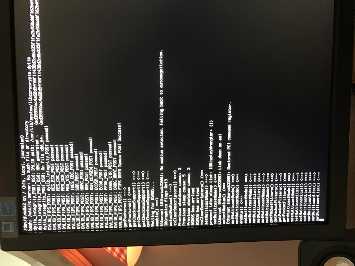

Hey,
I keep getting the attached error whenever I try to boot. It just hangs on -v at SetMulticastList(). I have installed the AtherosE2200 kext which worked perfectly but sometimes it is randomly stopping me from booting.
This happens whether I have my Ethernet plugged in or taken out. Booking into -x also fails so I am at a loss!
After a few restarts it just goes away and boots as normal. Once in Mac OS, speed is great and there are no issues.
Thanks for any help!
Hey,
According to the problem description and the screenshot it's most likely a messed up system, maybe a wrong BIOS setting or a problem with the DSDT but there is only one thing I can rule out at almost 100%: a driver issue!

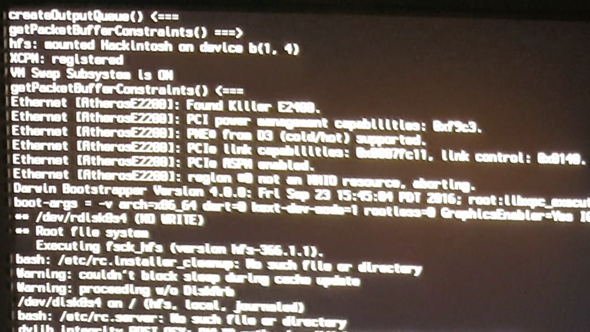

Hello Mieze, I have been having trouble with my hackintosh. My laptop has a killer e2400 integrated nic and I installed your e2200.kext so that it would work, but at startup I get this error:
Ethernet [AtherosE2200] region #0 is not an MMIO resource, aborting
I have tried everything that I can think of, but I can not get it to work to save my life!! I also PM'd you. Any help would be greatly aplreciated!
Please post complete kernel logs including at least on boot sequence.

I am running Sierra, and have attatched my Kernel Log to this post. Thank you for any help that you can give me!
There is not a single message from the driver in your log file. Either way the driver isn't installed properly or there is no supported NIC in your system. By the way, your ACPI tables seem to be messed up too, but that's another topic.
Mieze
Mieze
I am sorry, that was my fault. My Build of Sierra crashed today when I was trying to get the nework drivers to work and I had to rebuild the OS. I forgot to install the kext into the system. I installed your kext and reuploaded a new kernel log. Sorry, the file was 10.5 mb and I can only upload 10. <_< I also uploaded a picture of the error I keep getting that I assume is why I don't get network... What about my ACPI Tables now?

Get the prebuilt binary of the driver from Insanelymac.com's download area and try it. Please check the log file first before you report back.
Mieze
@Zelda_link64: Ok, the driver is installed properly but doesn't load, most likely because there is no compatible hardware found. I doubt that there is a Killer NIC at all in your system, even if the manufacturer's specification says so. Sorry!
Mieze
Mieze
OK, I am glad that it is installed correctly. I am very frustrated that it thinks it's not there. I know it is there, and clover even sees it when I boot to Mac! I just get this stupid error:
Ethernet [AethrosE2200]: region #0 not an MMIO resource, aborting
I know it sees the killer e2400 because it says so before that error. I attached a picture of the boot sequence. Is there any way to log the clover boot?
The error message is a strong indication that there is something wrong with the hardware, i.e. it's not a chip which is supported by the driver or maybe, the BIOS does something strange with the hardware I'm not aware of.
