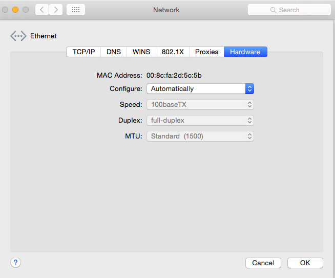

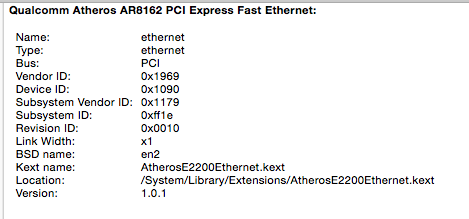

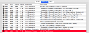

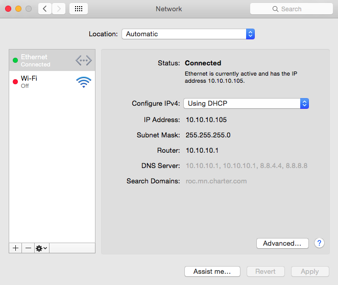

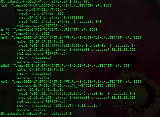

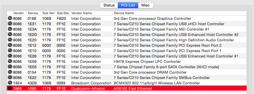

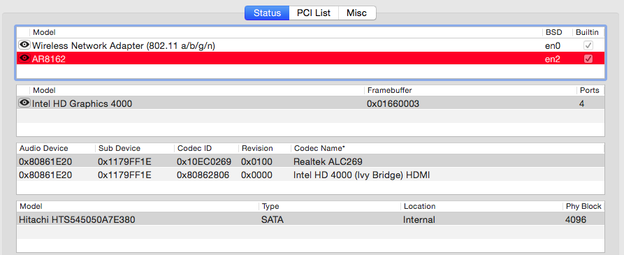

Tested out the version mentioned above (thanks!) here are some details.
Note this is a Toshiba C850 that was having the error of the NIC being disabled by the BIOS when it was actually enabled by the BIOS.
Feb 23 12:55:32 Elizabeths-MacBook-Pro kernel[0]: Ethernet [AtherosE2200]: Found AR8162.
Feb 23 12:55:32 Elizabeths-MacBook-Pro kernel[0]: Ethernet [AtherosE2200]: PCI power management capabilities: 0xf9c3.
Feb 23 12:55:32 Elizabeths-MacBook-Pro kernel[0]: Ethernet [AtherosE2200]: PME# from D3 (cold/hot) supported.
Feb 23 12:55:32 Elizabeths-MacBook-Pro kernel[0]: Ethernet [AtherosE2200]: PCIe link capabilities: 0x0007fc11, link control: 0x0142.
Feb 23 12:55:32 Elizabeths-MacBook-Pro kernel[0]: Ethernet [AtherosE2200]: PCIe ASPM enabled.
Feb 23 12:55:32 Elizabeths-MacBook-Pro kernel[0]: Ethernet [AtherosE2200]: TCP/IPv4 segmentation offload enabled.
Feb 23 12:55:32 Elizabeths-MacBook-Pro kernel[0]: Ethernet [AtherosE2200]: TCP/IPv6 segmentation offload enabled.
Feb 23 12:55:32 Elizabeths-MacBook-Pro kernel[0]: Ethernet [AtherosE2200]: TCP/IPv6 checksum offload enabled.
Feb 23 12:55:32 Elizabeths-MacBook-Pro kernel[0]: Ethernet [AtherosE2200]: Got MAC address from efuse.
Feb 23 12:55:32 Elizabeths-MacBook-Pro kernel[0]: Ethernet [AtherosE2200]: AR8162: (Rev. 16) at 0xffffff81211e5000,  0:8c:fa:2d:5c:5b
Feb 23 12:55:32 Elizabeths-MacBook-Pro kernel[0]: Ethernet [AtherosE2200]: Version 1.0.1 using max interrupt rate 5000.
Feb 23 12:55:32 Elizabeths-MacBook-Pro kernel[0]: Ethernet [AtherosE2200]: MSI interrupt index: 1
Feb 23 12:55:32 Elizabeths-MacBook-Pro kernel[0]: Ethernet [AtherosE2200]: kIOEthernetWakeOnMagicPacket added to filters.
Feb 23 12:55:32 Elizabeths-MacBook-Pro kernel[0]: Ethernet [AtherosE2200]: Already in power state 1.
Feb 23 12:55:35 Elizabeths-MacBook-Pro kernel[0]: Ethernet [AtherosE2200]: No medium selected. Falling back to autonegotiation.
Feb 23 12:55:35 Elizabeths-MacBook-Pro kernel[0]: Ethernet [AtherosE2200]: Link down on en2
Feb 23 12:55:35 Elizabeths-MacBook-Pro kernel[0]: Ethernet [AtherosE2200]: Restored PCI command register.
Feb 23 12:56:41 Elizabeths-MacBook-Pro kernel[0]: Ethernet [AtherosE2200]: Link up on en2, 100-Megabit, Full-duplex, Rx/Tx flow-control
Elizabeth’s MacBook Pro-working-atheros-LAN.zip

The reason why I am so sure is that you are using the same NIC as I do for development and I never had an issue since release of version 1.0.0d7 (7 month).
Please take a look at the BIOS settings and make sure that network boot and the UEFI network stack is disabled. You'll have to find out what is disabling the NIC in order to prevent the issue.
Mieze
Any ideas where to look for whatever might be disabling the NIC? I have confirmed that network boot and the UEFI network stack are disabled. Also, I have no problems with the NIC with Windows, so I'm thinking this may be a software rather than BIOS issue (maybe something besides your driver is trying to access the NIC).
The Windows driver developer had one advantage: full access to all information regarding the chips, which is something I don't have. By the way, are you using a beta BIOS? Gigabyte seems to do strange things with the NICs in their BIOSes and I recently had a guy who experienced such a problem with a Realtek NIC on a Gigabyte board. Downgrading solved the issue. See for yourself: http://www.insanelymac.com/forum/topic/287161-new-driver-for-realtek-rtl8111/?p=2123485
Mieze
Here is version 2.0.0d1 of the driver which uses Apple's private driver interface and supports packet scheduling with QFQ preventing loss of network connectivity due to congestion which seems to be a common problem on Yosemite. I'm using this driver on my server for several days now and can confirm that it is working as expected.
