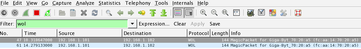

samtt Posted April 28, 2015 Share Posted April 28, 2015 Thank you Mieze, I try this driver and it works with my GA-Z97X-UD5H-BK (Atheros E2201), OS: 10.10.3. There is only one question regarding the Wake on LAN function. I turn on the WoL support from BIOS, enable the Wake for network access in "Energy Saver" tag, send the magic packet from another server in the same LAN. But the system didn't wake up. Attached is the wireshark snapshot that shows the magic packet arrived when system is up. Would you please give me a hint that where should I check to debug the WoL function? Link to comment https://www.insanelymac.com/forum/topic/300056-solution-for-qualcomm-atheros-ar816x-ar817x-and-killer-e220x/page/6/#findComment-2131713 Share on other sites More sharing options...
Mieze Posted April 28, 2015 Author Share Posted April 28, 2015 Would you please give me a hint that where should I check to debug the WoL function? Bios settings or DSDT. Mieze Link to comment https://www.insanelymac.com/forum/topic/300056-solution-for-qualcomm-atheros-ar816x-ar817x-and-killer-e220x/page/6/#findComment-2131719 Share on other sites More sharing options...
samtt Posted April 28, 2015 Share Posted April 28, 2015 this seems too difficult to me to edit the DSDT. Is there any good example to show the modification or patch of the WoL support? Link to comment https://www.insanelymac.com/forum/topic/300056-solution-for-qualcomm-atheros-ar816x-ar817x-and-killer-e220x/page/6/#findComment-2131909 Share on other sites More sharing options...
Mieze Posted April 28, 2015 Author Share Posted April 28, 2015 this seems too difficult to me to edit the DSDT. Is there any good example to show the modification or patch of the WoL support? Start with the BIOS settings and check them again as this is the solution in most cases. Sometimes the solution is not as obvious as expected and hard to find. That's why you should dig deeper. Mieze Link to comment https://www.insanelymac.com/forum/topic/300056-solution-for-qualcomm-atheros-ar816x-ar817x-and-killer-e220x/page/6/#findComment-2131911 Share on other sites More sharing options...
samtt Posted April 29, 2015 Share Posted April 29, 2015 Hello Mieze, Eventually I got the system wake up! The ErP should be set to Disable. Thanks for your hint! Link to comment https://www.insanelymac.com/forum/topic/300056-solution-for-qualcomm-atheros-ar816x-ar817x-and-killer-e220x/page/6/#findComment-2132015 Share on other sites More sharing options...

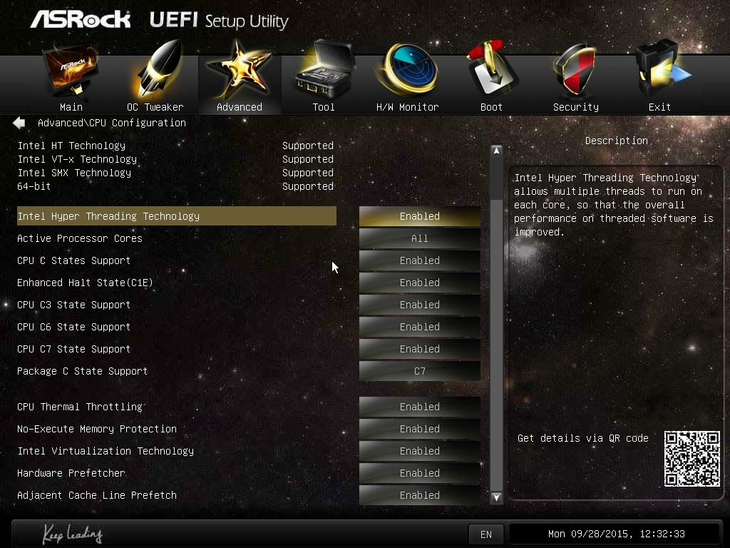

Huberer Posted September 28, 2015 Share Posted September 28, 2015 Hello Mieze, first of all I want to say thank you for your hard and perfect work. I really enjoy using your network drivers (which I did before with the Realtek and the Intel ones). Everything runs great but I found an issue. Don't know if it is driver or bios related. As you can see in my sig I'm using an Asrock B85M-ITX like you do (and this was also a reason why I've bought it). I use this mobo because of it's good power savings settings. One of my tests are if I could get the C7 state of the CPU (i7-4770S). Therefore I've enabled everything in Bios (Advanced=> CPU Configuration). You can see it on the screen shot. With this settings, and some undervolting, I can get an idle power consumption of around 9,1 watts (with monitor off). It looks like that Yosemite is able to use C7 state. But unfortunatelly download speed falls down to around 300-400 KBit/s. Normally I've around 3000 KBit's (I only have a 30Mbit internet connection). It looks like that the onboard lan is only using 100Mbit instead of Gigabit. To find a reason why it is like that it's the "Package C State Support" under CPU Configuration/Advance in Bios. When I change this option to "disable" or to "Auto" I've the full download speed again. Unfortunately the power consumption rises to around 15 watts in idle and monitor off. Even when I change from C7 to C6 in "Package C State Support" the same issue remain. Only idle is around 11 watts. Do you knwo why it is like that and is there a chance to use both (C7 and fast download)? Thanks in advance Huberer Link to comment https://www.insanelymac.com/forum/topic/300056-solution-for-qualcomm-atheros-ar816x-ar817x-and-killer-e220x/page/6/#findComment-2170954 Share on other sites More sharing options...
Mieze Posted September 28, 2015 Author Share Posted September 28, 2015 Hello Mieze, first of all I want to say thank you for your hard and perfect work. I really enjoy using your network drivers (which I did before with the Realtek and the Intel ones). Everything runs great but I found an issue. Don't know if it is driver or bios related. As you can see in my sig I'm using an Asrock B85M-ITX like you do (and this was also a reason why I've bought it). I use this mobo because of it's good power savings settings. One of my tests are if I could get the C7 state of the CPU (i7-4770S). Therefore I've enabled everything in Bios (Advanced=> CPU Configuration). You can see it on the screen shot. With this settings, and some undervolting, I can get an idle power consumption of around 9,1 watts (with monitor off). It looks like that Yosemite is able to use C7 state. But unfortunatelly download speed falls down to around 300-400 KBit/s. Normally I've around 3000 KBit's (I only have a 30Mbit internet connection). It looks like that the onboard lan is only using 100Mbit instead of Gigabit. To find a reason why it is like that it's the "Package C State Support" under CPU Configuration/Advance in Bios. When I change this option to "disable" or to "Auto" I've the full download speed again. Unfortunately the power consumption rises to around 15 watts in idle and monitor off. Even when I change from C7 to C6 in "Package C State Support" the same issue remain. Only idle is around 11 watts. Do you knwo why it is like that and is there a chance to use both (C7 and fast download)? Thanks in advance Huberer First of all it's a well known fact that power management can degrade I/O performance so that I assume that your problem is due to your PM settings in particular as the download speed is affected. Second, I can't reproduce this behavior on my machine. Although I've got all C-states enabled too, I haven't experienced any negative side effects with regard to I/O performance. The only difference is that I didn't undervolt the machine but left all voltage related settings at their defaults because undervolting can have a serious impact on system stability if it's done improperly. On the other hand, my machine is a server so that it's never really idle at all. Mieze Link to comment https://www.insanelymac.com/forum/topic/300056-solution-for-qualcomm-atheros-ar816x-ar817x-and-killer-e220x/page/6/#findComment-2171043 Share on other sites More sharing options...
Huberer Posted September 28, 2015 Share Posted September 28, 2015 Hello Mieze, thanks for the answer and testing. I'm pretty sure that I've tested the C-states-settings without undervolting and the result was the same. I will do this test again (without uv) to be 100% sure. I know that uv can cause stability issues but I do it just with small steps to be at the safe side. My system is not a real server because most time my hackintosh idles around and that's why did this testing. Nethertheless it's not a big issue I just wanted to know how I can resolve this matter. Thanks again Huberer Link to comment https://www.insanelymac.com/forum/topic/300056-solution-for-qualcomm-atheros-ar816x-ar817x-and-killer-e220x/page/6/#findComment-2171049 Share on other sites More sharing options...
