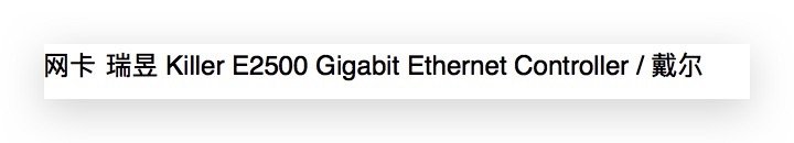

Mieze Posted July 6, 2019 Author Share Posted July 6, 2019 @Mison Looks like you are confusing something because Killer Ethernet Controllers are Qualcomm Atheros products but the device ID you posted seems to be one of a completely different device. What's wrong? Is it a Killer NIC or a Realtek device? Link to comment https://www.insanelymac.com/forum/topic/300056-solution-for-qualcomm-atheros-ar816x-ar817x-and-killer-e220x/page/11/#findComment-2680449 Share on other sites More sharing options...
Mison Posted July 8, 2019 Share Posted July 8, 2019 On 7/7/2019 at 4:16 AM, Mieze said: @Mison Looks like you are confusing something because Killer Ethernet Controllers are Qualcomm Atheros products but the device ID you posted seems to be one of a completely different device. What's wrong? Is it a Killer NIC or a Realtek device? I'm really confused! But the id is true. I have a laptop DELL G7 7590 with Killer E2500 Gigabit Ethernet Controller. Link to comment https://www.insanelymac.com/forum/topic/300056-solution-for-qualcomm-atheros-ar816x-ar817x-and-killer-e220x/page/11/#findComment-2680595 Share on other sites More sharing options...
