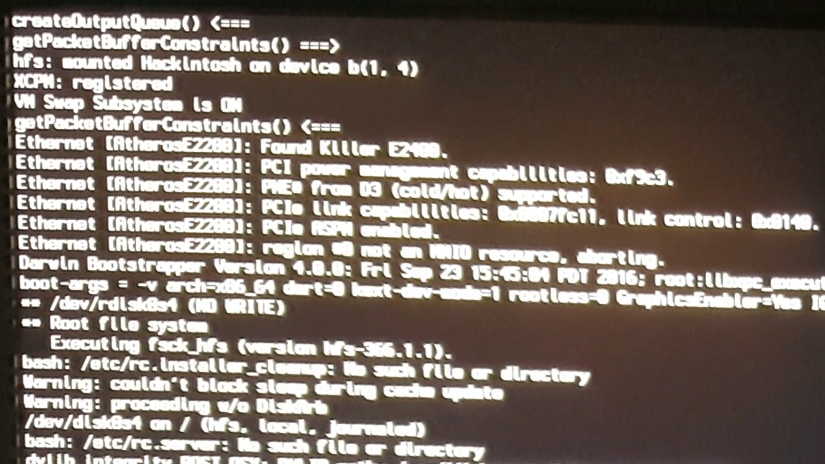

The error message is a strong indication that there is something wrong with the hardware, i.e. it's not a chip which is supported by the driver or maybe, the BIOS does something strange with the hardware I'm not aware of.
Mieze
Well, according to clover when I boot in verbose mode, it does recognize that I have killer e2400. it just errors out when loading your kext. Is there anything that you know of that might screw with it?
Unfortunately no, because I have no documentation and the OS's function to enable the NIC's memory area for access fails for unknown reasons. There is nothing I can do about it.

@DriveTheOne: Disable the UEFI network stack and network boot. this kind of errors occur when something is still in control of the NIC preventing the driver from accessing it.

Read the instructions in post#1 of this thread. Enter the BIOS settings and make sure that the UEFI network stack as well as network boot are disabled both. Reading through the thread you will find several users which had the same problem and solved it this way.
