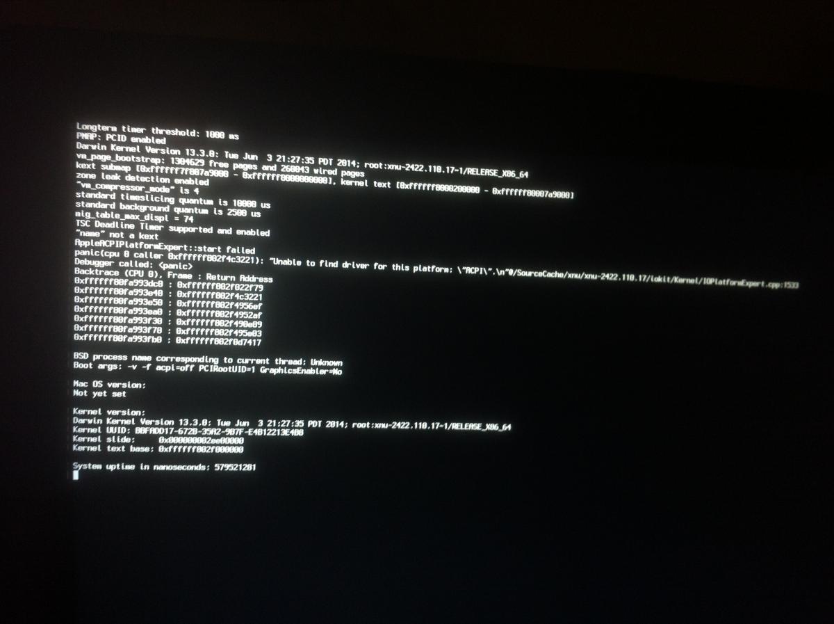

Erik-Eberhardt Posted August 4, 2014 Share Posted August 4, 2014 Hi all, i have got a problem booting OSX Mavericks. Everytime I boot I get the error you can see in the picture. I am not sure which bootflags i could use to fix it. I have got an Asus N53 SN Motherboard and i use Clover as my Bootloader. Have I to flash my BIOS? I hope you can help me and if u want to have other informations just ask. Erik-Eberhardt Link to comment https://www.insanelymac.com/forum/topic/300053-kernel-panic/ Share on other sites More sharing options...
styrian Posted August 4, 2014 Share Posted August 4, 2014 Hello! Could be a config problem with your Clover config.plist. Correct SMBios configured? Boot up to Clover bootscreen and look in options - SMBios - which platform clover is recognizing for your hardware. Then generate your fake SMBios for this platform. AsusPMpatch activated in Clover? Are you injecting your system specs with Clover? You can also try to add nullcpupm.kext in clover kext folder to inject it with the other necessary kexts at boottime. Have fun. Link to comment https://www.insanelymac.com/forum/topic/300053-kernel-panic/#findComment-2048309 Share on other sites More sharing options...
artur_pt Posted August 4, 2014 Share Posted August 4, 2014 hello u can try also boot with the installer and try to see if u have any hd problem with disk utility .. good hack Link to comment https://www.insanelymac.com/forum/topic/300053-kernel-panic/#findComment-2048322 Share on other sites More sharing options...
Erik-Eberhardt Posted August 4, 2014 Author Share Posted August 4, 2014 Hello, I watched pretty close to Clover config.plist and everything seems to be ok. I've now built another SMBios with the recognized Software of Clover. AsusPMpatch is activated also and the kexts are booting with Clover. The Error stays the same... I'm not sure about what it is. I think if it won't work in a few days I'll be formating my HDD and try to install OSX on a empty HDD. Thanks for your help and do you have any other ideas for me to fix it? Maybe another Bootloader (but I think Clover is the best one because you can set everything along your own wishes) Thank you all, Erik-Eberhardt Link to comment https://www.insanelymac.com/forum/topic/300053-kernel-panic/#findComment-2048407 Share on other sites More sharing options...
styrian Posted August 4, 2014 Share Posted August 4, 2014 Hello! Is your device a laptop with switchable gfx? Which gfx? Which system version do you want to install? Hdd in GUID? Switched Bios to AHCI? Have fun. Link to comment https://www.insanelymac.com/forum/topic/300053-kernel-panic/#findComment-2048409 Share on other sites More sharing options...
carbo178 Posted August 4, 2014 Share Posted August 4, 2014 Bios settings: Sata in AHCI mode In Clover boot options delete or change from "true" to "false" all string in DSDT-ACPI section. Delete string "PCIRootUID=1", not necessary for your system and retry. Good Hack Link to comment https://www.insanelymac.com/forum/topic/300053-kernel-panic/#findComment-2048468 Share on other sites More sharing options...

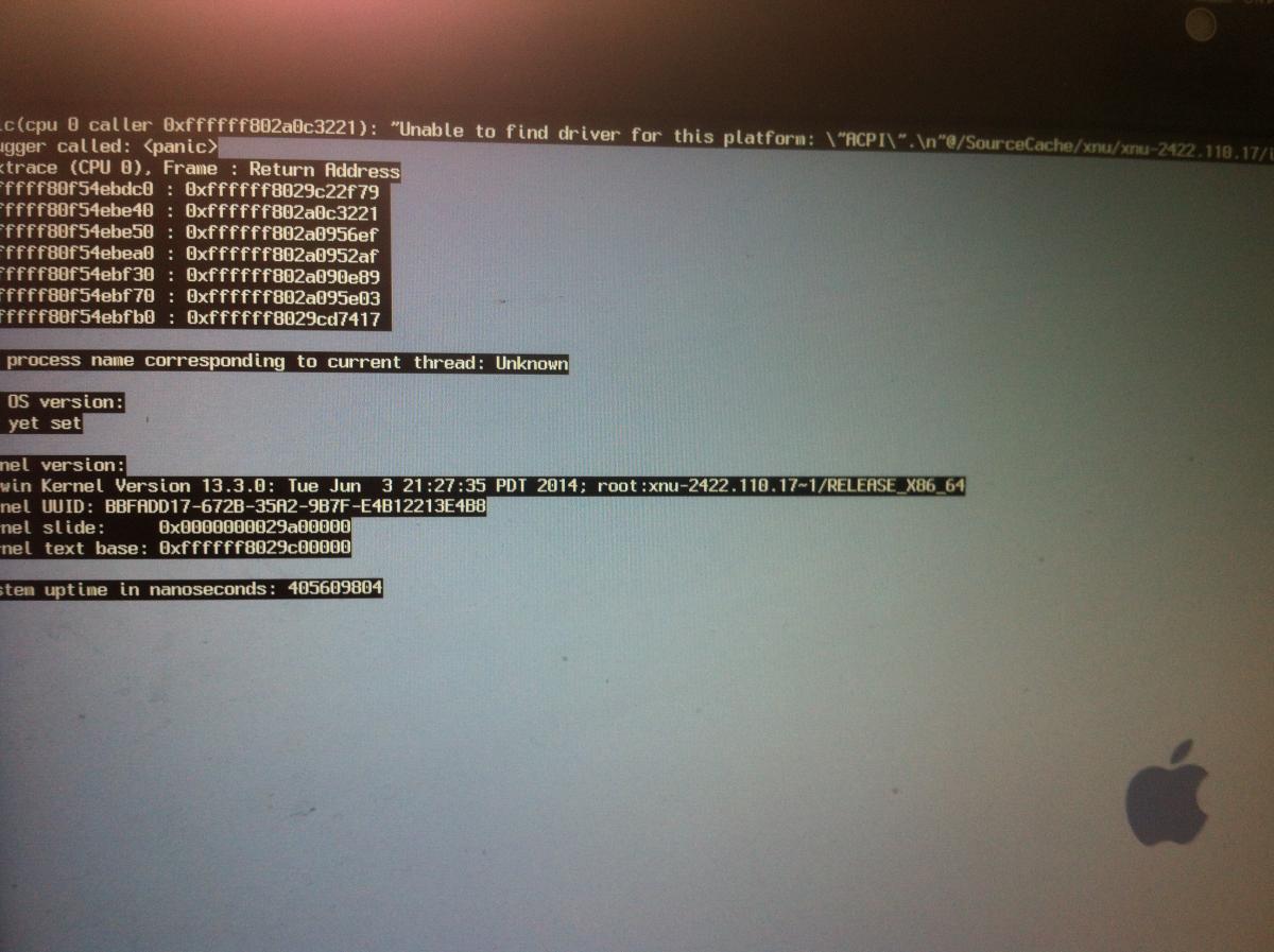

Erik-Eberhardt Posted January 2, 2015 Author Share Posted January 2, 2015 hello guys thank you all for the help^^ after a long pause i tried again to install osx. this time i tried it with osx yosemite on a bootable usb stick wich was created with diskmakerx. everything worked very good until i wanted to boot with it. i started booting in verbose and safe mode and got this error which was nearly the same error as at the beginning. if anyone has an idea, that would be great. BTW i used [url="http://www.insanelymac.com/forum/topic/279450-why-insanelymac-does-not-support-tonymacx86/"]#####[/url] as Bootloader. https://www.dropbox.com/s/raht6hws2lt1t4x/Foto.JPG?dl=0 Link to comment https://www.insanelymac.com/forum/topic/300053-kernel-panic/#findComment-2099857 Share on other sites More sharing options...

Erik-Eberhardt Posted January 6, 2015 Author Share Posted January 6, 2015 hello, i tried this with these boot flags (see the picture) and also only in verbose mode but both times i got this error. what could this be? in bios the controller is set to ahci and intel virtualization technology is disabled. By the way when i inserted my usb with osx yosemite to my pc clover said can not read (something..i cant remember). but anyway i was able to start from the usb. https://www.dropbox.com/sh/3603vi5tbz7pe1m/AAAExtwD_sdWnB0uu_HSl9bva?dl=0 thanks for your help Link to comment https://www.insanelymac.com/forum/topic/300053-kernel-panic/#findComment-2101188 Share on other sites More sharing options...
rednous Posted January 6, 2015 Share Posted January 6, 2015 The first kernel panics you're experiencing are CPU Power Management related. Your laptop must run Mavericks flawlessly Use the default Clover config.plist settings set by the installation! and install Mavericks. Clover automatically will chose SMBIOS profile based on your hardware. Then play with the Clover settings. Link to comment https://www.insanelymac.com/forum/topic/300053-kernel-panic/#findComment-2101207 Share on other sites More sharing options...
Erik-Eberhardt Posted January 16, 2015 Author Share Posted January 16, 2015 hello all, i just installed clover on a usb drive and i booted from it. in clover menu i disabled nvidia and enabled intel graphics card and inserted another mavericks usb drive. same error... then i inserted snow leopard. same error... then i inserted mountain lion. same error... waht can i do... i booted in verbose mode and another bootflag "debug=0x100" which showed me a longer error text. any ideas how to fix this problem? i think its about my laptop and not about the apple software. here the link to some pictures. https://www.dropbox.com/sh/d952yf9ydfzvl2l/AABLUVmI7H3qzTLwWVFQttIRa?dl=0 thank you all for the help btw: i was succesfull in installing os x mavericks on a virtual machine on my laptop. works perfectly but if i insert a usb drive on which is a os x installation i get also an error and the system shows this black screen with the normal baclground and the machine freezes... any idea why this happens? Link to comment https://www.insanelymac.com/forum/topic/300053-kernel-panic/#findComment-2103431 Share on other sites More sharing options...
