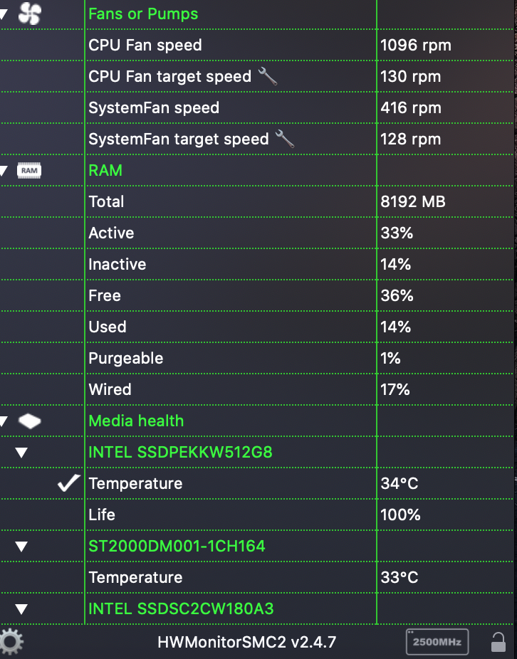

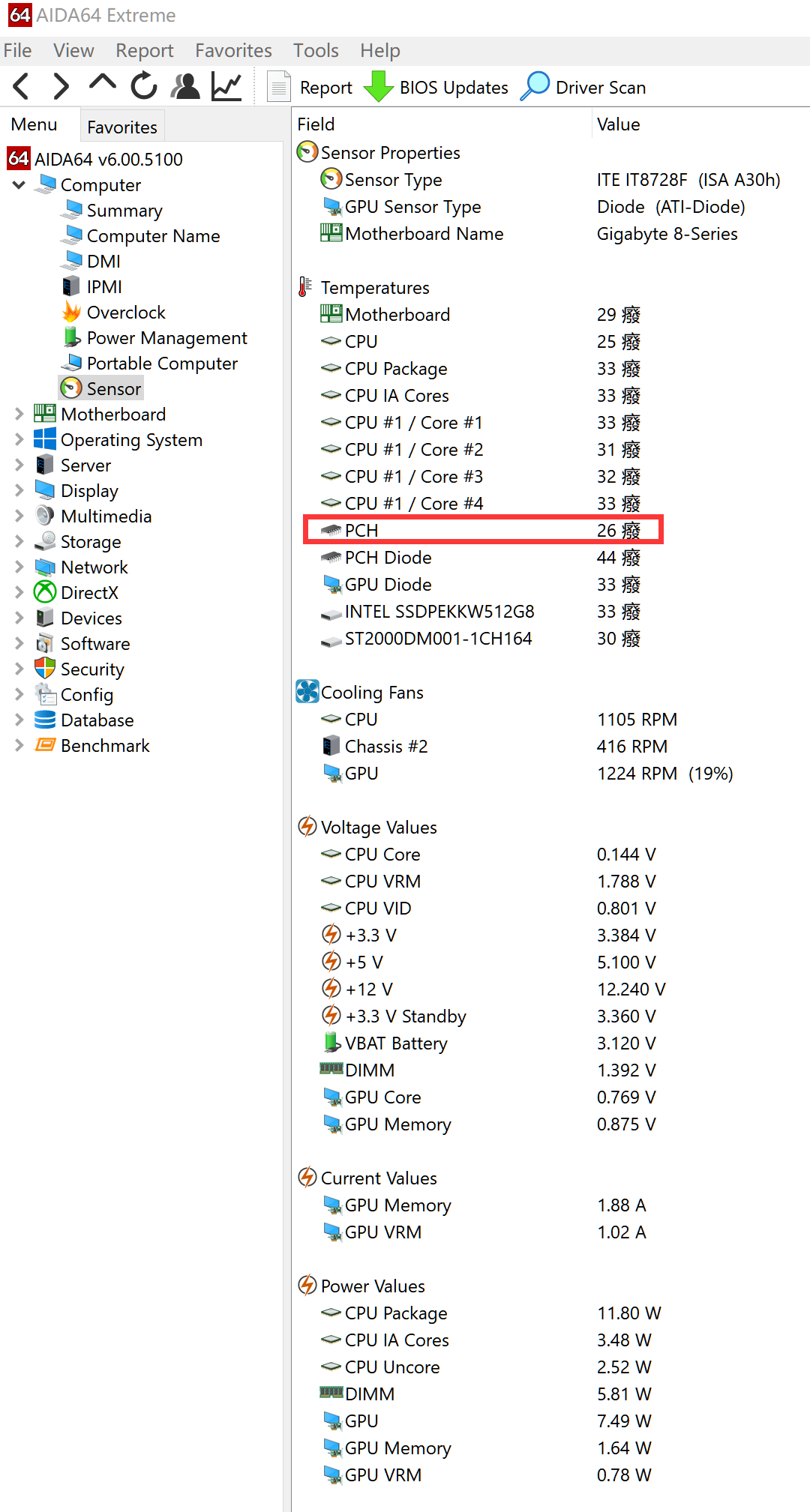

vector sigma Posted June 17, 2019 Share Posted June 17, 2019 9 hours ago, jinbingmao said: Existence before sleep, loss after awakening. Try this: ITEIT87x.kext.zip and let me know. Link to comment https://www.insanelymac.com/forum/topic/299861-hwsensors3/page/75/#findComment-2678062 Share on other sites More sharing options...
jinbingmao Posted June 17, 2019 Share Posted June 17, 2019 (edited) 2小时前,矢量西格玛说: 试试这个: ITEIT87x.kext.zip 并告诉我。 Should be my own problem, I upgraded the development version, now normal. Edited June 17, 2019 by jinbingmao 1 Link to comment https://www.insanelymac.com/forum/topic/299861-hwsensors3/page/75/#findComment-2678070 Share on other sites More sharing options...
vector sigma Posted June 19, 2019 Share Posted June 19, 2019 On 6/17/2019 at 9:53 PM, jinbingmao said: Should be my own problem, I upgraded the development version, now normal. Is it ok also with the standard version at sourceforge? Link to comment https://www.insanelymac.com/forum/topic/299861-hwsensors3/page/75/#findComment-2678342 Share on other sites More sharing options...
vector sigma Posted June 19, 2019 Share Posted June 19, 2019 On 6/17/2019 at 11:04 AM, Slice said: Suppose you have this controller with an input pin where you expected to see an ambient temperature value. To do this you have to be sure there is an thermodiod which actually measures the temperature of environment and is connected to this input pin. I am not sure if the thermodiod exists. Can be any, I cannot not be sure is it the "Ambient" sensor, but I guess @jinbingmao already ensure this... anyway for sure some thing is connected at ITE_TEMPERATURE_BASE_REG + index 2. Link to comment https://www.insanelymac.com/forum/topic/299861-hwsensors3/page/75/#findComment-2678345 Share on other sites More sharing options...

jinbingmao Posted June 20, 2019 Share Posted June 20, 2019 (edited) 16小时前,矢量西格玛说: 可以是任何,我不能肯定它是“环境”传感器,但我想@jinbingmao 已经确保了这一点......无论如何 肯定有一些东西在ITE_TEMPERATURE_BASE_REG +索引2连接。 Platform Controller Hub( South Bridge) Edited June 20, 2019 by jinbingmao Link to comment https://www.insanelymac.com/forum/topic/299861-hwsensors3/page/75/#findComment-2678444 Share on other sites More sharing options...
jinbingmao Posted June 20, 2019 Share Posted June 20, 2019 Link to comment https://www.insanelymac.com/forum/topic/299861-hwsensors3/page/75/#findComment-2678447 Share on other sites More sharing options...

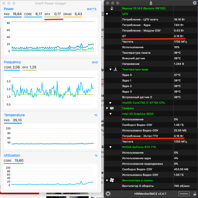

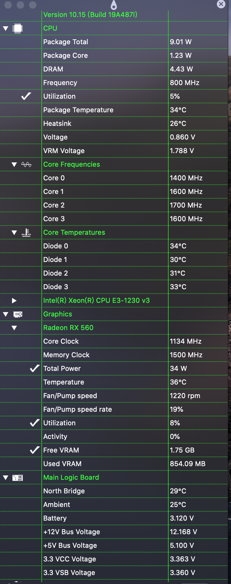

Andrey1970 Posted July 5, 2019 Share Posted July 5, 2019 @vector sigma Intel updated IPG. Attention, version number 3.5.5 did not change, but it is the new program. https://software.intel.com/en-us/articles/intel-power-gadget Good news: Now there is a IGPU Power. I use VirtualSMC and now I see duplicating. I think that now there is no need to receive CPU/IGPU Power from smc keys. 2 Link to comment https://www.insanelymac.com/forum/topic/299861-hwsensors3/page/75/#findComment-2680351 Share on other sites More sharing options...
vector sigma Posted July 5, 2019 Share Posted July 5, 2019 4 minutes ago, Andrey1970 said: Intel updated IPG. Attention, version number 3.5.5 did not change, but it is the new program. https://software.intel.com/en-us/articles/intel-power-gadget Good news: Now there is a IGPU Power. I use VirtualSMC and now I see duplicating. I think that now there is no need to receive CPU/IGPU Power from smc keys. Tomorrow I'll handle this by looking at the new public header. Thanks for the info! Link to comment https://www.insanelymac.com/forum/topic/299861-hwsensors3/page/75/#findComment-2680352 Share on other sites More sharing options...
Slice Posted July 6, 2019 Author Share Posted July 6, 2019 HWMonitor2 works with updated IPG. Link to comment https://www.insanelymac.com/forum/topic/299861-hwsensors3/page/75/#findComment-2680362 Share on other sites More sharing options...
vector sigma Posted July 6, 2019 Share Posted July 6, 2019 1 hour ago, Slice said: HWMonitor2 works with updated IPG. Just adjusting the translation for "GT". More I want to see if isGTAvailable() now works .. as in the old framework wasn't ..and avoid scanning for sensors when is not necessary. a smcopen() in less. Link to comment https://www.insanelymac.com/forum/topic/299861-hwsensors3/page/75/#findComment-2680367 Share on other sites More sharing options...

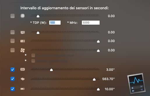

Slice Posted July 19, 2019 Author Share Posted July 19, 2019 Hi @vector sigma, is it possible to make somehow HWMonitorSMC2 to NOT autostarted at system launch? I checkout its preferences. I exclude in from Login Items. I checked Luach Daemons. Anyway after restart the monitor is started again... I need this to debug SMC keys without monitor. Link to comment https://www.insanelymac.com/forum/topic/299861-hwsensors3/page/75/#findComment-2682160 Share on other sites More sharing options...
vector sigma Posted July 19, 2019 Share Posted July 19, 2019 (edited) 4 hours ago, Slice said: Hi @vector sigma, is it possible to make somehow HWMonitorSMC2 to NOT autostarted at system launch? I checkout its preferences. I exclude in from Login Items. I checked Luach Daemons. Anyway after restart the monitor is started again... I need this to debug SMC keys without monitor. Hi Slice, that already happened to me... but later I've realize that I hade more the one HWMonitorSMC2.app that wanted to load at login (due to some tests with various copies of the source code), and since at app initialization each app unload itself if another HWMonitorSMC2.app is already running ..at next reboot, again, another app was showing up. Please ensure this is not the problem, anyway I'll revise the code. EDIT For the moment, a simple way to ensure no smc calls are made, just go to the settings and uncheck each sensor group that reads smc keys: media, ram and battery groups doesn't use the smc. Settings are shared between each app, so this way we can ensure smc doesn't get opened. On 7/7/2019 at 9:40 AM, zkingtut said: Thank you all Please I got this result but I am not sure !!! Please see my GPU Sensors ; is it correct ? looks ok to me Edited July 19, 2019 by vector sigma 3 Link to comment https://www.insanelymac.com/forum/topic/299861-hwsensors3/page/75/#findComment-2682190 Share on other sites More sharing options...
Slice Posted July 19, 2019 Author Share Posted July 19, 2019 3 hours ago, vector sigma said: Hi Slice, that already happened to me... but later I've realize that I hade more the one HWMonitorSMC2.app that wanted to load at login (due to some tests with various copies of the source code), and since at app initialization each app unload itself if another HWMonitorSMC2.app is already running ..at next reboot, again, another app was showing up. Please ensure this is not the problem, anyway I'll revise the code. EDIT For the moment, a simple way to ensure no smc calls are made, just go to the settings and uncheck each sensor group that reads smc keys: media, ram and battery groups doesn't use the smc. Settings are shared between each app, so this way we can ensure smc doesn't get opened. looks ok to me This moment I am sure having only one app. But I don't know if macOS remembered it twice. I resolved the problem deleting the app. Next time I will restore it from archive. I have many news about using SMC keys so FakeSMC and plugins will be updated. 3 1 Link to comment https://www.insanelymac.com/forum/topic/299861-hwsensors3/page/75/#findComment-2682208 Share on other sites More sharing options...
