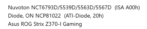

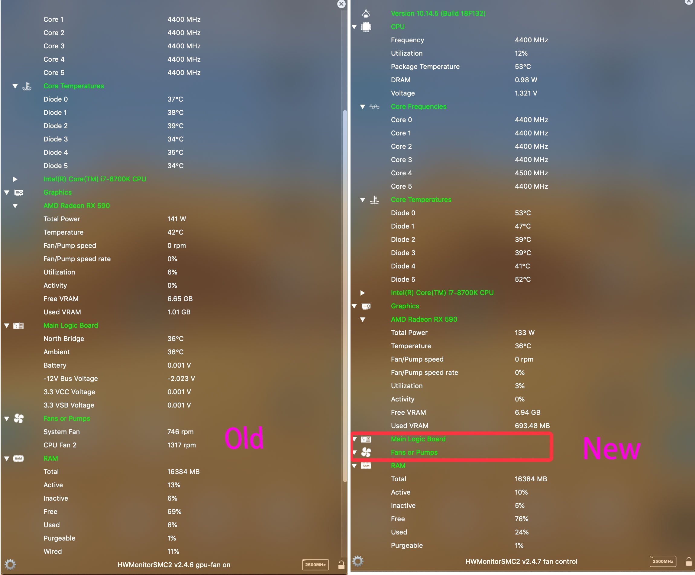

Hi,@vector sigma, I downloaded the 199 version of hwsensors, replacing the old sensor file, but did not display the fan content after rebooting into the system, even the motherboard related content is not displayed.
nvram and cache have been cleaned up the problem remains.
Switching back to the old sensor file and Fakesmc will display the fan speed and motherboard temperature.
I uploaded my ioieg file, please help me to see where the problem is? Thank you!
My motherboard sensor model
New and old contrast
iMacPro 1,1-Ioieg.zip
Hi and thanks for testing. From your ioreg I'm sure W836x.kext is not even loaded so it is normal that fans didn't show up. Causes? Not sure, wrong FakeSMC version (require FakeSMC.kext v3.5.2 from the same dmg), a bug or any. Please post a DarwinDumper log with only the kernel  log (kernel buffer messages).

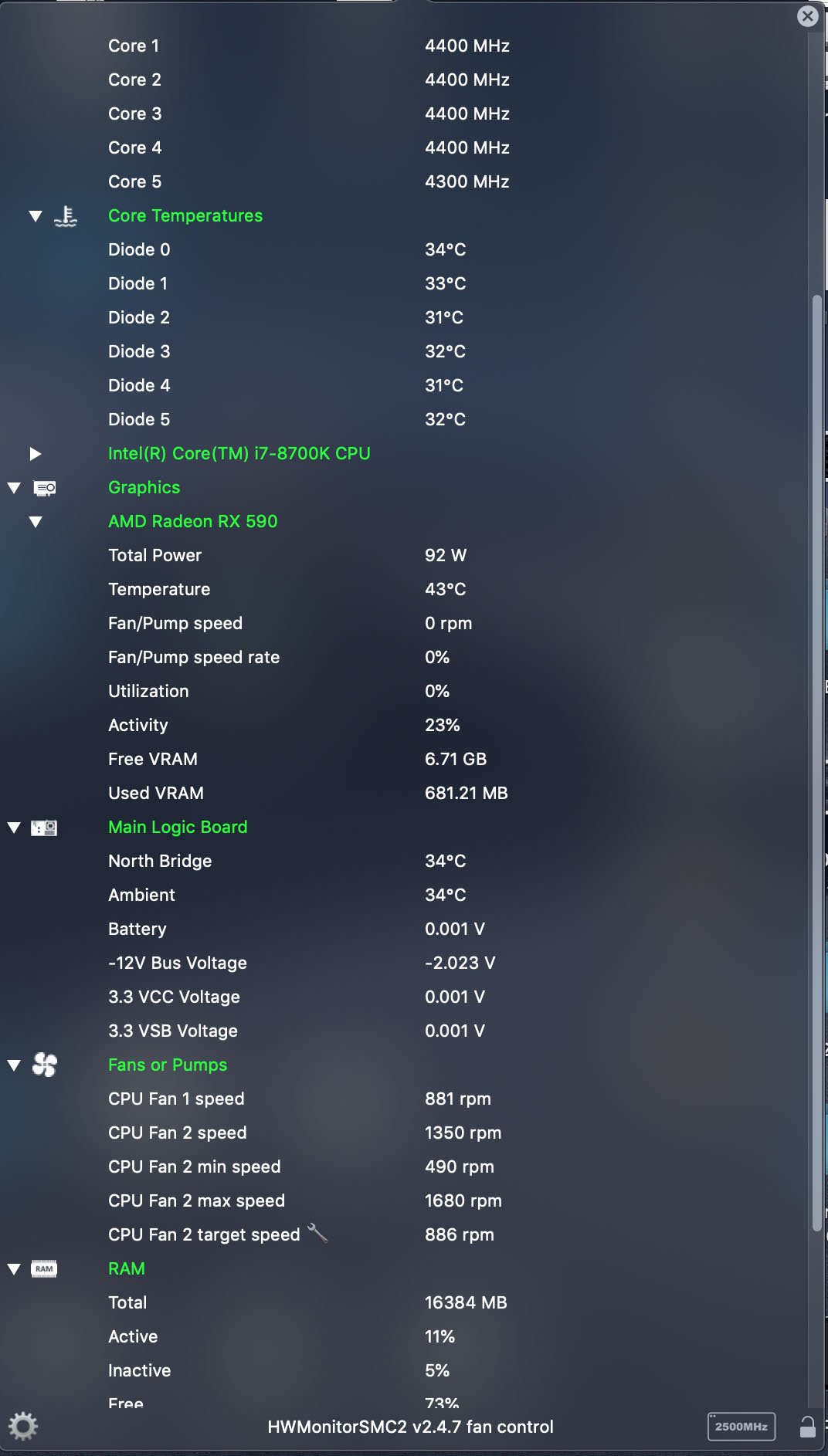

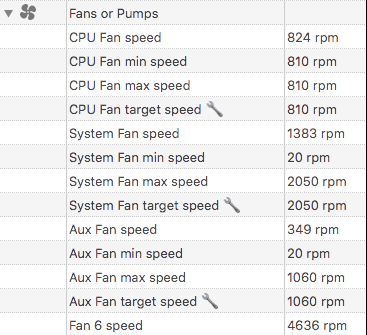

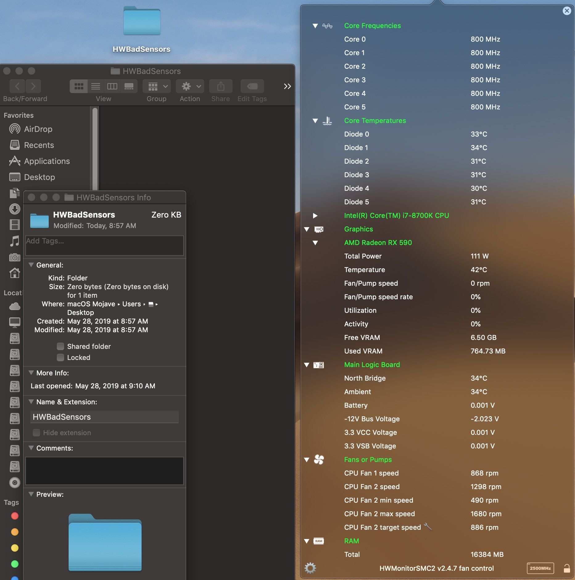

I reset the HWMonitorSMC2, then restarted the computer and it showed up. But only CPU Fan 2 has a display setting Target, CPU Fan 1 does not? My CPU cooler is connected to two fans, and both fans are PWM. How to solve it?
Edited by fryysyd
They are just wrong values? Create a folder to your Desktop called HWBadSensors and restart the app. Show me a picture. Also I need a ioreg if possible, thanks.

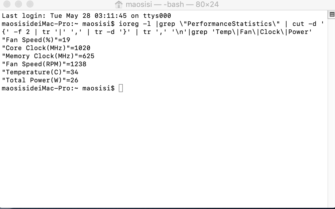

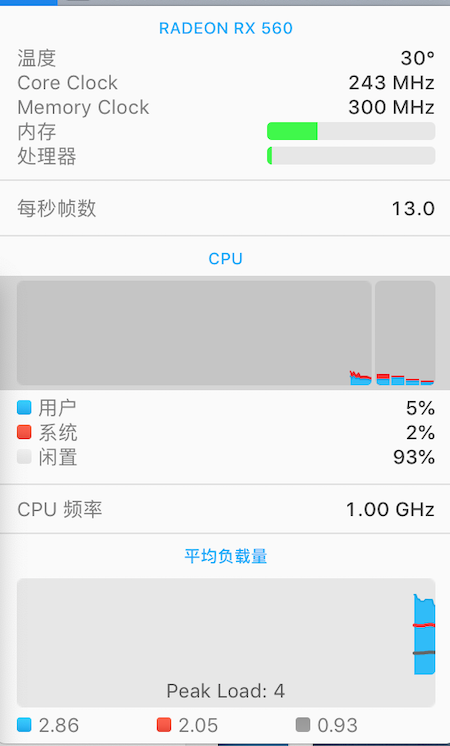

3 minutes ago, jinbingmao said:
“GPU Memory Clock”  “GPU Core Clock“
What do you mean?:ph34r:
6 minutes ago, vector sigma said:
他们只是错误的价值观?创建一个名为HWBadSensors的桌面文件夹, 然后重新启动应用程序。给我看一张照片 如果可能的话我也需要一个ioreg,谢谢。
你什么意思?:ph34r:
Hope to add these two
Core Clock is already present if published by the Apple drivers, usually for NVIDIA. Doing it for every gpu in commerce is hard. Who knows
3 minutes ago, Pavo said:
Can someone link the latest build of HWMonitorSMCv2 please?
already in this page, just some posts above :).

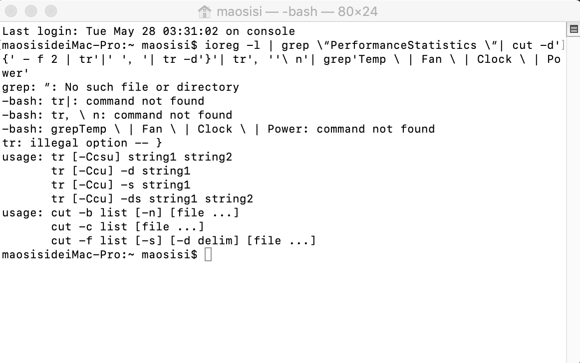

18 minutes ago, jinbingmao said:
ioreg -l |grep \"PerformanceStatistics\" | cut -d '{' -f 2 | tr '|' ',' | tr -d '}' | tr ',' '\n'|grep 'Temp\|Fan\|Clock\|Power'
Ok, now I've understood you :angel:,. In the mean time you can try to create this two folders inside your Desktop and restart the application?
HWBadSensors                 HWGraphics
See if values show up and please, post a ioreg and the "HWGraphics" folder only.
Edited by vector sigma
typo

12 minutes ago, jinbingmao said:
NO
I think that I've understood why. In the source code is written:
if let coreclock = PerformanceStatistics.object(forKey: "Core Clock(MHz)") as? NSNumber {
and looks ok, but there's an hidden character, so "Core Clock(MHz)" is not the same as "Core Clock(MHz)".  Tomorrow I'll give you a modified one. Now I need to sleep, see you.
2 minutes ago, vector sigma said:
我想我明白了为什么。我的来源写道:
但是有一个隐藏的字符,因此“核心时钟(MHz)”  与“核心时钟(MHz)”不同。明天我会给你一个修改过的。现在我需要睡觉,看到你。
Hi,vector sigma,As you said, I created the HWBadSensors folder on my desktop, then closed and reopened the app, as follows:
This is the ioieg file, please check!
iMacPro 1,1.zip
