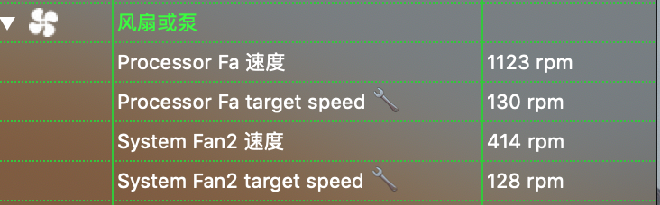

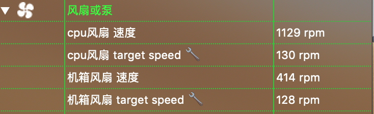

At present, the South Bridge temperature of the main board Z87 chipset is not monitored. Everything else is complete. It's really comprehensive. It's a great job to go beyond history.
target speed= 目标速度
Byte Limitation
I need to know more about temperature for your chips. Maybe a dump made in windows or linux can help me?
Byte Limitation
Yep, only 12 bytes allowed and your is longer:
50 72 6F 63 65 73 73 6F 72 20 46 61 6E 27
... but we can fix it by giving a shorter name and let the app translate it to any. Example:
"CPU" = "My cool processor's Fan"; :angel:
Edited by vector sigma
6 minutes ago, jinbingmao said:
When the temperature is below the critical temperature, the fan is the target speed.
I'm not sure to understand you, but in W836x.kext you can choose to let the motherboard doing its job automatically. An 'alarm' will always work if temperature is accurate. Usually I set to the low level possible even if the cpu increase 2 or 3 degrees as I love silence, but others that play with overclocking may need the possibility to go at max during their test stress. For all others.... imho just let the bios decide!
Just now, jinbingmao said:
fan=风扇
no need for this. Just CPU as fan name will be enough. The app knows is it a fan, so the app will show a more descriptive string. To be implemented, but is so easy to be done...
6 minutes ago, vector sigma said:
我不太了解你,但在W836x.kext中你可以选择让主板自动完成它的工作。如果温度准确,“警报”将始终有效。通常我设置为低级别,即使cpu增加2或3度因为我喜欢沉默,但其他玩超频可能需要在测试压力期间达到最大值。对于所有其他人...... imho只是让bios决定!
不需要这个。只需CPU作为粉丝名称即可。该应用程序知道它是一个粉丝,因此该应用程序将显示更具描述性的字符串。要实施,但很容易做到......

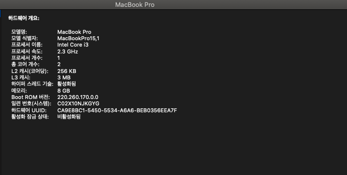

@vector sigma
i checked latest build.
need to change like this
MacBookPro15,1 : REV RBr RPlt
MacBookPro15,2 : REV RBr RPlt
MacBookAir8,1  : REV RBr RPlt
Macmini8,1     : REV RBr RPlt
iMacPro1,1     : REV RBr RPlt
to
MacBookPro15,1 : REV RBr EPCI
MacBookPro15,2 : REV RBr EPCI
MacBookAir8,1  : REV RBr EPCI
Macmini8,1     : REV RBr EPCI
iMacPro1,1     : REV RBr EPCI
Edited by Sherlocks
