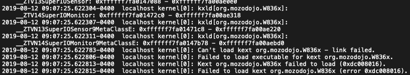

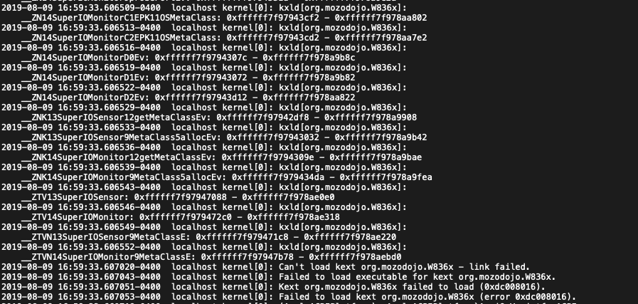

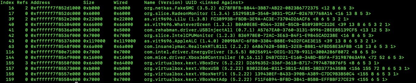

curtistn73 Posted August 9, 2019 Share Posted August 9, 2019 17 hours ago, Slice said: OK, I will add it. @Slice I built a new pkg based on r227 (I see you added code for the NCT6797D chip). However, the W836x.kext fails to load. See attachment. What can I do to help get this working? Link to comment https://www.insanelymac.com/forum/topic/299861-hwsensors3/page/77/#findComment-2685332 Share on other sites More sharing options...
Slice Posted August 12, 2019 Author Share Posted August 12, 2019 On 8/9/2019 at 9:22 PM, curtistn73 said: @Slice I built a new pkg based on r227 (I see you added code for the NCT6797D chip). However, the W836x.kext fails to load. See attachment. What can I do to help get this working? The kext must be compiled with SDK10.11. And FakeSMC must be version 3.5.2, not 6, not 1800. Take release package from sf.net. Link to comment https://www.insanelymac.com/forum/topic/299861-hwsensors3/page/77/#findComment-2685627 Share on other sites More sharing options...
curtistn73 Posted August 12, 2019 Share Posted August 12, 2019 14 hours ago, Slice said: The kext must be compiled with SDK10.11. And FakeSMC must be version 3.5.2, not 6, not 1800. Take release package from sf.net. Hi @Slice, I used the r227 release package from SourceForge, and (unfortunately) have the same results: W836x kext does not load and the same error is present in the logs. Link to comment https://www.insanelymac.com/forum/topic/299861-hwsensors3/page/77/#findComment-2685721 Share on other sites More sharing options...
Slice Posted August 13, 2019 Author Share Posted August 13, 2019 Take package 234. Link to comment https://www.insanelymac.com/forum/topic/299861-hwsensors3/page/77/#findComment-2685743 Share on other sites More sharing options...
curtistn73 Posted August 13, 2019 Share Posted August 13, 2019 12 hours ago, Slice said: Take package 234. I tried r234. However, it didn't help and W836x still doesn't load. Link to comment https://www.insanelymac.com/forum/topic/299861-hwsensors3/page/77/#findComment-2685887 Share on other sites More sharing options...

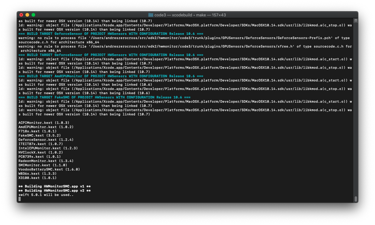

Andres ZeroCross Posted August 13, 2019 Share Posted August 13, 2019 How to compile HWSensor3?? Got stuck in this line... Link to comment https://www.insanelymac.com/forum/topic/299861-hwsensors3/page/77/#findComment-2685896 Share on other sites More sharing options...
Slice Posted August 13, 2019 Author Share Posted August 13, 2019 52 minutes ago, Andres ZeroCross said: How to compile HWSensor3?? Got stuck in this line... svn up 1 hour ago, curtistn73 said: I tried r234. However, it didn't help and W836x still doesn't load. Can you provide some logs for more info? Or I have to propose that you just using wrong version of FakeSMC? Link to comment https://www.insanelymac.com/forum/topic/299861-hwsensors3/page/77/#findComment-2685904 Share on other sites More sharing options...

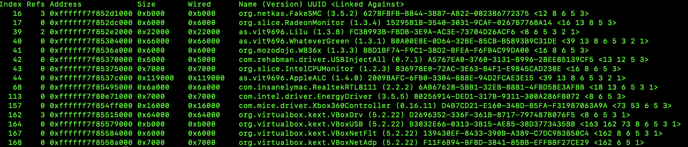

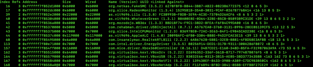

curtistn73 Posted August 14, 2019 Share Posted August 14, 2019 17 hours ago, Slice said: Can you provide some logs for more info? Or I have to propose that you just using wrong version of FakeSMC? Thanks for your help @Slice. I hope the attached information will be useful. boot-log.txt system-log.txt Link to comment https://www.insanelymac.com/forum/topic/299861-hwsensors3/page/77/#findComment-2686088 Share on other sites More sharing options...
Slice Posted August 14, 2019 Author Share Posted August 14, 2019 1 hour ago, curtistn73 said: Thanks for your help @Slice. I hope the attached information will be useful. boot-log.txt system-log.txt Thanks for detailed logs. Test this version. If OK then I have to replace default downloaded package. W836x.kext.zip Link to comment https://www.insanelymac.com/forum/topic/299861-hwsensors3/page/77/#findComment-2686112 Share on other sites More sharing options...
vector sigma Posted August 14, 2019 Share Posted August 14, 2019 21 hours ago, Andres ZeroCross said: How to compile HWSensor3?? Got stuck in this line... Not sure for the cause, here takes += 50 seconds while in Xcode IDE takes only 18. mmmh Link to comment https://www.insanelymac.com/forum/topic/299861-hwsensors3/page/77/#findComment-2686118 Share on other sites More sharing options...

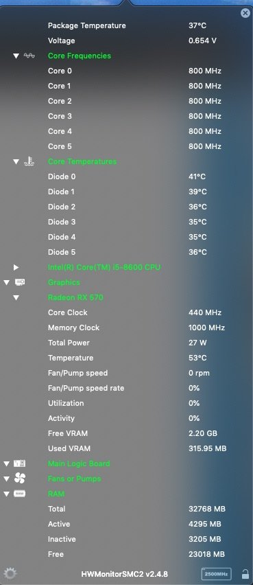

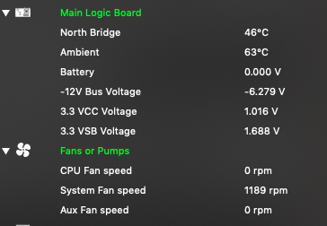

curtistn73 Posted August 14, 2019 Share Posted August 14, 2019 5 hours ago, Slice said: Thanks for detailed logs. Test this version. If OK then I have to replace default downloaded package. W836x.kext.zip We are making progress! This kext loads and information is shown in HWMonitorSMC2. However, the voltages do not appear to be correct (see attached pic). Also, CPU Fan and System Fan seem to be swapped. new-systemlog-w836x.txt Link to comment https://www.insanelymac.com/forum/topic/299861-hwsensors3/page/77/#findComment-2686165 Share on other sites More sharing options...
Slice Posted August 15, 2019 Author Share Posted August 15, 2019 You have to make a profile for your motherboard and write here Fan names and voltages dividers. Looks like default values are not good for you. 1 Link to comment https://www.insanelymac.com/forum/topic/299861-hwsensors3/page/77/#findComment-2686198 Share on other sites More sharing options...
vector sigma Posted August 16, 2019 Share Posted August 16, 2019 On 8/9/2019 at 3:29 PM, Andrey1970 said: Strange, but I had a problem of build of the last versions. On 8/13/2019 at 8:16 PM, Andres ZeroCross said: How to compile HWSensor3?? Got stuck in this line... Hi guys, not sure where the problem reside for you, but can you try debug version? just make a copy of ./hwconf.profile in your Home directory (or just edit it in place) from Release to Debug: export PREFERRED_CONF_APPS='Debug' let me know Link to comment https://www.insanelymac.com/forum/topic/299861-hwsensors3/page/77/#findComment-2686287 Share on other sites More sharing options...
Slice Posted August 16, 2019 Author Share Posted August 16, 2019 For additional information. I have 10.13.6 with XCode 10.1 and swift 4.2. The build process told me that "swift 4.2.1 is not found, back to 4.2" and then compilation is successful. Just take a whole minute to do. Link to comment https://www.insanelymac.com/forum/topic/299861-hwsensors3/page/77/#findComment-2686308 Share on other sites More sharing options...
vector sigma Posted August 16, 2019 Share Posted August 16, 2019 9 minutes ago, Slice said: For additional information. I have 10.13.6 with XCode 10.1 and swift 4.2. The build process told me that "swift 4.2.1 is not found, back to 4.2" and then compilation is successful. Just take a whole minute to do. Thanks. Swift 4.2.1 is ok, I'll fix it. But I guess a minute for building from scratch (make fresh) is just fine, the problem is with some Xcode and the shipped parser that goes crazy solving very easy statements like is too complicated, for example this alone took 3 seconds to be resolved (strings concatenation using +): return String(describing: UnicodeScalar(self >> 24 & 0xff)!) + String(describing: UnicodeScalar(self >> 16 & 0xff)!) + String(describing: UnicodeScalar(self >> 8 & 0xff)!) + String(describing: UnicodeScalar(self & 0xff)!) while this just took few ms: return "\(String(describing: UnicodeScalar(self >> 24 & 0xff)!))\(String(describing: UnicodeScalar(self >> 16 & 0xff)!))\(String(describing: UnicodeScalar(self >> 8 & 0xff)!))\(String(describing: UnicodeScalar(self & 0xff)!))" ... to do just the same. Also they have problems with "concurrency building" vs "one by one", why I suggested to use "Debug" because use the second. Hope Apple fix it soon. No problems here with Xcode 10.2.1. Link to comment https://www.insanelymac.com/forum/topic/299861-hwsensors3/page/77/#findComment-2686316 Share on other sites More sharing options...
