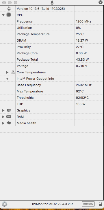

Guest Posted November 23, 2018 Share Posted November 23, 2018 6 minutes ago, vector sigma said: I have another idea: HWMonitorSMC2.app.zip Bro, they are as they are declared by Intel, nothing you can do. Thank you bro..but here are the specs https://ark.intel.com/products/126699/Intel-Core-i9-7980XE-Extreme-Edition-Processor-24-75M-Cache-up-to-4-20-GHz- and I can see it @92° if I do not OC cpu multiplier on bios..so can't say why it happens if those value are only read from app Link to comment https://www.insanelymac.com/forum/topic/299861-hwsensors3/page/62/#findComment-2649392 Share on other sites More sharing options...
vector sigma Posted November 23, 2018 Share Posted November 23, 2018 (edited) 29 minutes ago, fabiosun said: Thank you bro..but here are the specs https://ark.intel.com/products/126699/Intel-Core-i9-7980XE-Extreme-Edition-Processor-24-75M-Cache-up-to-4-20-GHz- and I can see it @92° if I do not OC cpu multiplier on bios..so can't say why it happens if those value are only read from app It says 94°, but there is also a clickable question mark where it says "Junction Temperature is the maximum temperature allowed at the processor die." The die have always lower temperature because is a heatsink itself. And if you did not understand, the value reported by the app are taken from IntelPowerGadget.framework (Intel support: https://software.intel.com/en-us/forum) and they are just easy, ready.. with no way to be wrong. Most of them are also reported exactly the same by sysctl, example for frequency: sysctl hw.cpufrequency so that you that you go to Apple to report wrong values as well and receive the same answer. Edited November 23, 2018 by vector sigma typo 1 Link to comment https://www.insanelymac.com/forum/topic/299861-hwsensors3/page/62/#findComment-2649400 Share on other sites More sharing options...

Guest Posted November 23, 2018 Share Posted November 23, 2018 21 minutes ago, vector sigma said: It says 94°, but there is also a clickable question mark where it says "Junction Temperature is the maximum temperature allowed at the processor die." The die have always lower temperature because is a heatsink itself. And if you did not understand, the value reported by the app are taken from IntelPowerGadget.framework (Intel support: https://software.intel.com/en-us/forum) and they are just easy, ready.. with no way to be wrong. Most of them are also reported exactly the same by sysctl, example for frequency: sysctl hw.cpufrequency so that you that you go to Apple to report wrong values as well and receive the same answer. Link to comment https://www.insanelymac.com/forum/topic/299861-hwsensors3/page/62/#findComment-2649408 Share on other sites More sharing options...

Guest Posted November 23, 2018 Share Posted November 23, 2018 (edited) 24 minutes ago, vector sigma said: @fabiosun, 始終是來自IntelPowerGadget.framework的數據,您決定發布的任何照片。 funny..but I am here to understand and now I know why app say 92° and in other situation 110° in IPG tab Maybe you are understanding in other ways my way to debug or help..so I stop here to be clear is not an app problem..but more deepest Edited November 23, 2018 by Guest Link to comment https://www.insanelymac.com/forum/topic/299861-hwsensors3/page/62/#findComment-2649416 Share on other sites More sharing options...
vector sigma Posted November 23, 2018 Share Posted November 23, 2018 2 minutes ago, fabiosun said: is not an app problem..but more deepest Agreed, but not my fault. there were two hours to explain that these values are under the control of IntelPowerGadget.framework 5 minutes ago, fabiosun said: funny Yep, tried with chinese, last resource to capture your attention ...but no offenses 1 Link to comment https://www.insanelymac.com/forum/topic/299861-hwsensors3/page/62/#findComment-2649418 Share on other sites More sharing options...

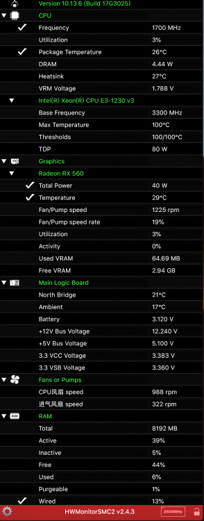

jinbingmao Posted November 24, 2018 Share Posted November 24, 2018 (edited) 2018/11/24 PM12点00分,e14883362说: 嗨,大家好。 蓝宝石脉冲RX 560 4GOC(45W)无法看到风扇速度(0rpm)和百分比(0%)。但是图形风扇实际上正在旋转(机箱打开),大约1200 rpm -1400 rpm。待机也在旋转,好像没有官方的自动启停功能。如果在非待机状态下温度达到55-60摄氏度,您将看到风扇速度和百分比。当温度降至30-35时,数据将返回其先前的状态(风扇仍在旋转)。怎样才能解决这个问题? 哦,顺便说一下,你偶尔可以看到待机模式下的速度(没有百分比)。 另一个问题是,在唤醒后,您无法看到CPU和机箱中的风扇的速度。睡觉前是正常的,例如840转。但是当它醒来时,它变为0转。但是,风扇并没有停止。它仍在旋转,但没有数据。 hehe Edited November 25, 2018 by jinbingmao Link to comment https://www.insanelymac.com/forum/topic/299861-hwsensors3/page/62/#findComment-2649584 Share on other sites More sharing options...
