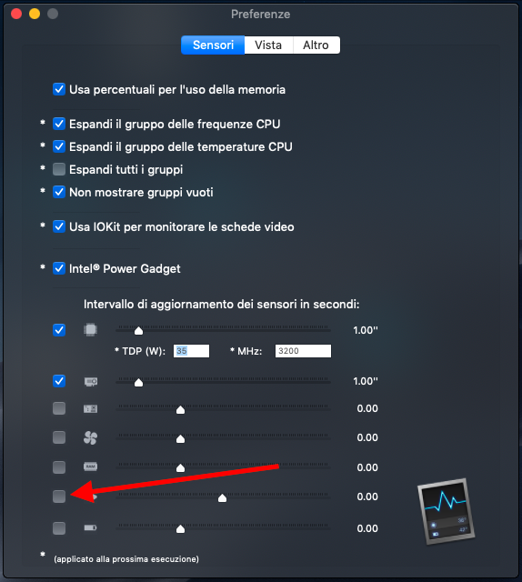

vector sigma Posted March 4, 2019 Share Posted March 4, 2019 4 minutes ago, unixb0y said: Any chance you know how to disable specific entries like in my case: battery and hdd status? If you use one of the latest betas I posted here since last saturday you can disable each group you want by disabling the relative checkbox: I'll do a commit in a short time, maybe tomorrow. 1 Link to comment https://www.insanelymac.com/forum/topic/299861-hwsensors3/page/67/#findComment-2666016 Share on other sites More sharing options...

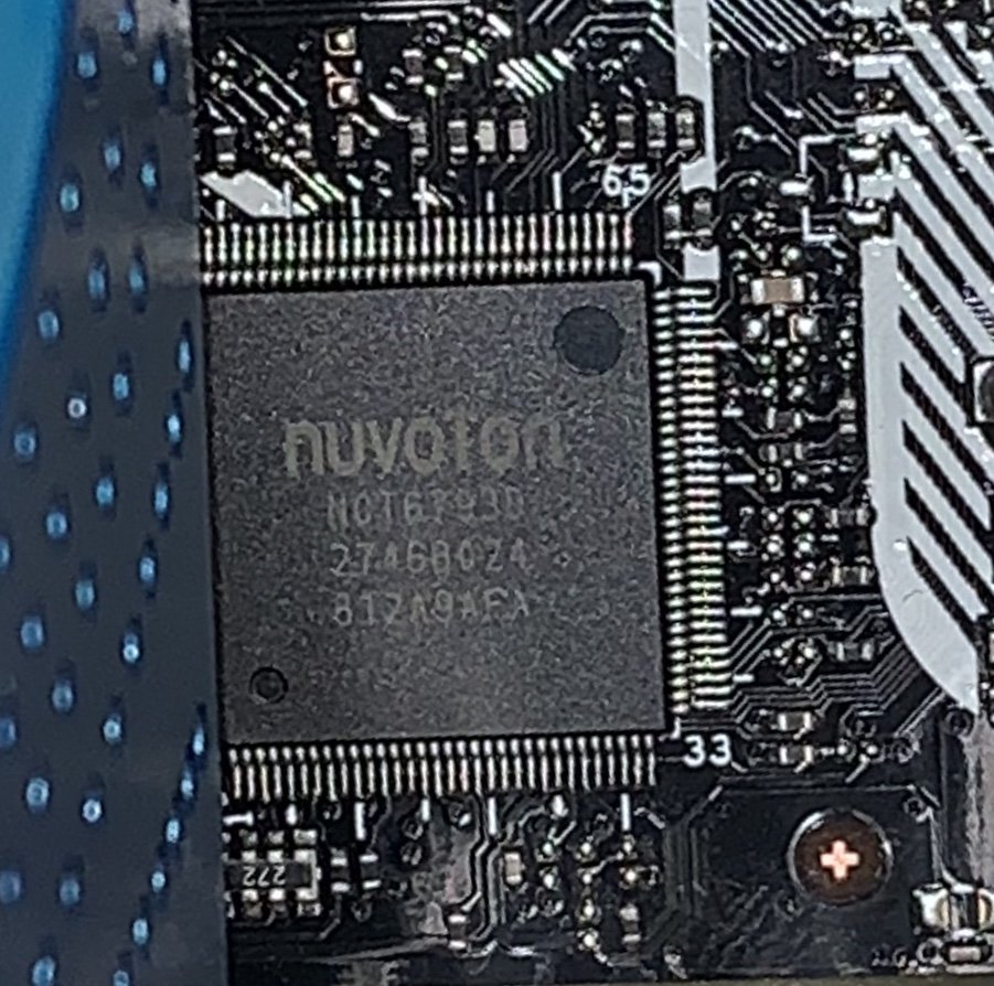

unixb0y Posted March 5, 2019 Share Posted March 5, 2019 (edited) 25 minutes ago, Rodion2010 said: it is possible with Linux or Google about your MB details... You need to install kext for YOUR SuperIO to measure RPM and TEMP I was able to take this image of the chip: Looks like a "Nuvoton NCT6793D". Nuvoton NCT6793D 274680Z4 817A9AFA Edited March 5, 2019 by unixb0y Link to comment https://www.insanelymac.com/forum/topic/299861-hwsensors3/page/67/#findComment-2666034 Share on other sites More sharing options...
vector sigma Posted March 5, 2019 Share Posted March 5, 2019 9 hours ago, unixb0y said: I was able to take this image of the chip: Looks like a "Nuvoton NCT6793D". Nuvoton NCT6793D 274680Z4 817A9AFA Yes, didn't already told you that here? 15 hours ago, vector sigma said: model NCT6793D, supported. In your pastebin log we found: Trying family `VIA/Winbond/Nuvoton/Fintek'... Yes Found unknown chip with ID 0xd121 (logical device B has address 0x290, could be sensors) id 0xd121 that is already supported in WindbondW836x.h: NCT6793D = 0xD121, Link to comment https://www.insanelymac.com/forum/topic/299861-hwsensors3/page/67/#findComment-2666065 Share on other sites More sharing options...

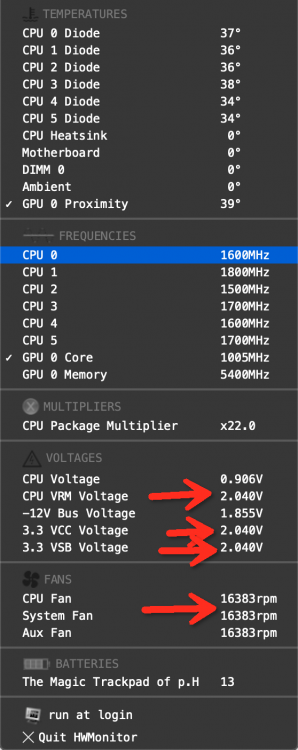

unixb0y Posted March 6, 2019 Share Posted March 6, 2019 On 12/19/2018 at 12:16 PM, p.H said: Hi, I'd like to know what I could do to improve those readings. No doubt those reading are wrong. Here're some info from HWMonitor dump. My config: Asus Prime Z370A + 8700K + GTX650Ti Mainboard Model PRIME Z370-A LPCIO ------------------------------------------------------------------------- LPCIO Vendor Nuvoton LPCIO Model NCT6793/NCT5563 LPCIO Vendor ID 0x5CA3 LPCIO Chip ID 0xD1 LPCIO Revision ID 0x21 Hardware monitor Nuvoton NCT6791D Voltage 0 5.08 Volts [0x7F] (+5V) Voltage 1 3.38 Volts [0xD3] (+3.3V) Voltage 2 12.29 Volts [0x80] (+12V) Voltage 3 1.07 Volts [0x86] (VIN3) Voltage 4 1.94 Volts [0x79] (VIN4) Voltage 5 0.67 Volts [0x2A] (VCORE) Temperature 0 28 degC (82 degF) [0x1C] (Mainboard) Temperature 1 30 degC (86 degF) [0x1E] (CPU) Temperature 2 28 degC (82 degF) [0x1C] (TMPIN2) Temperature 3 30 degC (86 degF) [0x1E] (TMPIN3) Temperature 5 50 degC (122 degF) [0x32] (TMPIN5) Temperature 6 22 degC (71 degF) [0x16] (TMPIN6) Fan 1 830 RPM [0x33E] (CPU) Hey, were you able to fix the Fan RPMs? Link to comment https://www.insanelymac.com/forum/topic/299861-hwsensors3/page/67/#findComment-2666187 Share on other sites More sharing options...
