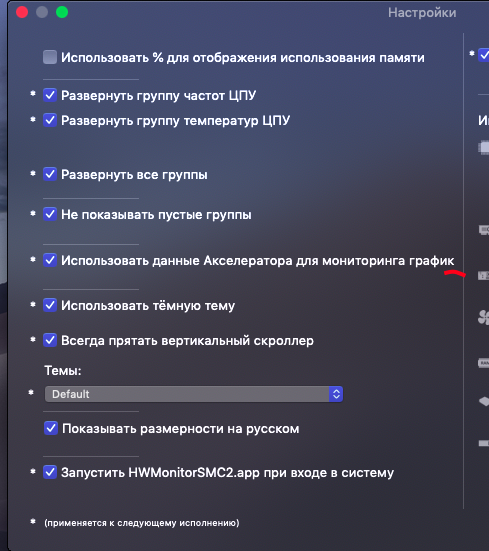

14 minutes ago, Andrey1970 said:
@vector sigma
Make here slightly more place. The last letter in the word "графики" was not located.
Spoiler
I've already made it larger and tested it and I thought it was all right... but my Russian is bad :hysterical:
Fixed in r188.

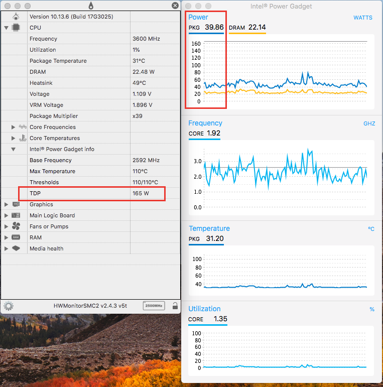

2 hours ago, fabiosun said:
Is it possible to have this value exposed dynamically as we have in Intel Power Gadget?
thank you
Sorry but is not the same thing, TDP is static (meant as TDP base.. as design). What do you seek is "Totale Package" (Pakage Total):
It is a good question for Intel why our apps show different things and or why same things are called differently. "Pakage Total" will work if you install VirtualSMC, but there is no way to get it from the IntelPowerGadget.framework as in the header there's no a public way to do that.
IPG 3.5.5 vs HWMonitorSMC2 v2.4.3 (r188)
Edited by vector sigma
23 minutes ago, vector sigma said:
Sorry but is not the same thing, TDP is static (meant as TDP max.. as design). What do you seek is "Core Package":
It is a good question for Intel why our apps show different things and or why same things are called differently. "Core Package" will work if you install VirtualSMC, but there is no way to get it from the IntelPowerGadget.framework as in the header there's no a public way to do that.
Thank you for your answer
I am using for now fakesmc and its plugin sets because I have strange hang on my system with virtualsmc. Core package when I have used it does not reach higher wattage as I caould see in IPG graph..here I have to check better  checked with virtualSMC Core PKG value is the same in both app
Edited by Guest

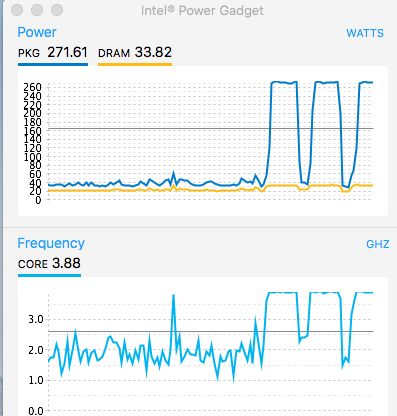

5 minutes ago, fabiosun said:
No Andrey
Take a look on flat line in my IPG graph (around 160 it is 165 (TDP for my CPU) and this could be greater under stress test)
Fabio, IPG place a gray line exactly at 165W to let you understand that this is the max
as for me the max is 35W

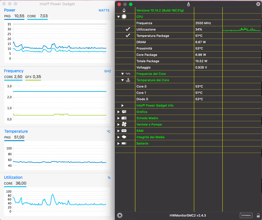

Just now, vector sigma said:
Fabio, look better, the TDP is always 165 (gray line)
I see and I understand your point but maybe I do not understand well relationship between TDP and Package power..
Back to my wish I was asking because PKG power (or TDP ) is important when you Overclock your cpu to find a right compromise between performance/stability
I am trying to install virtualSMC set again to see if Power PKG is growing also in HWSMC2
Thank you for your time
ok @vector sigma, with VirtualSMC I see dynaminacally increase core package wattage (very useful for me)

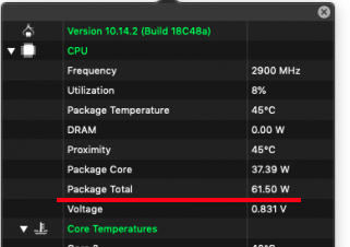

I at all did not know that these keys are not present in FakeSMC. :)
It is necessary to ask @Slice, to add keys:
CPU Package Core
CPU Package GPU
CPU Package Total
11 minutes ago, Andrey1970 said:
@vector sigma
That there was no confusion, it is necessary to rename group "IPG info" in "Reference info".
I have another idea: HWMonitorSMC2.app.zip
35 minutes ago, fabiosun said:
Max Temperature and thresholds are not good in this case
I think are influenced in a bad way from my multiplier overclock on bios (put manually at 39 instead of auto)
In auto value I see correct values in that IPG tab
Bro, they are as they are declared by Intel, nothing you can do.
