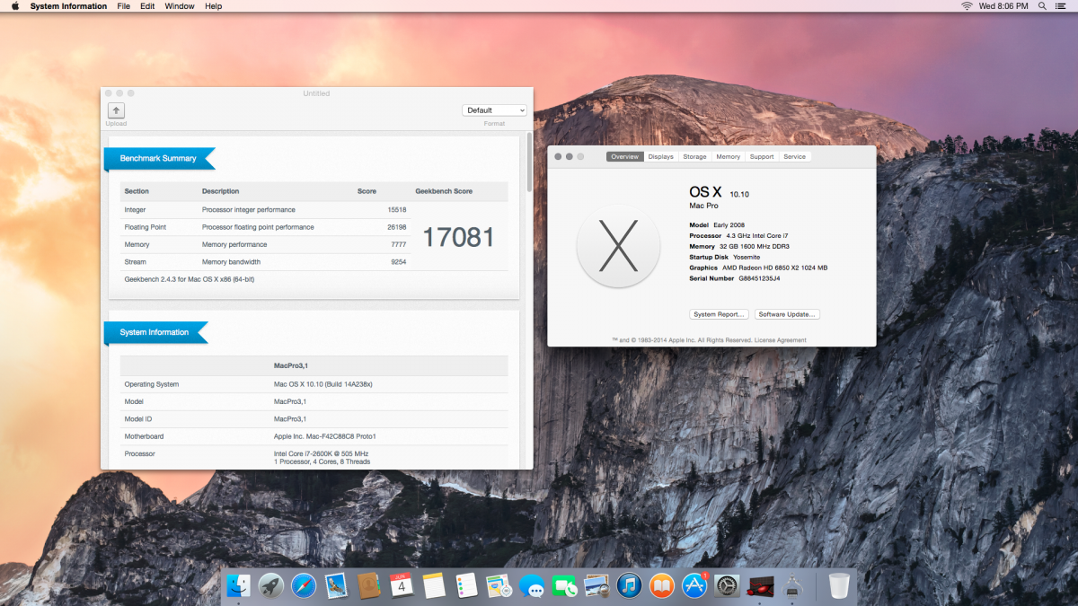

jamiethemorris Posted June 5, 2014 Share Posted June 5, 2014 Working well here on my Z68 build. 1 Link to comment https://www.insanelymac.com/forum/topic/298424-boot-guide/page/4/#findComment-2025481 Share on other sites More sharing options...

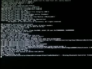

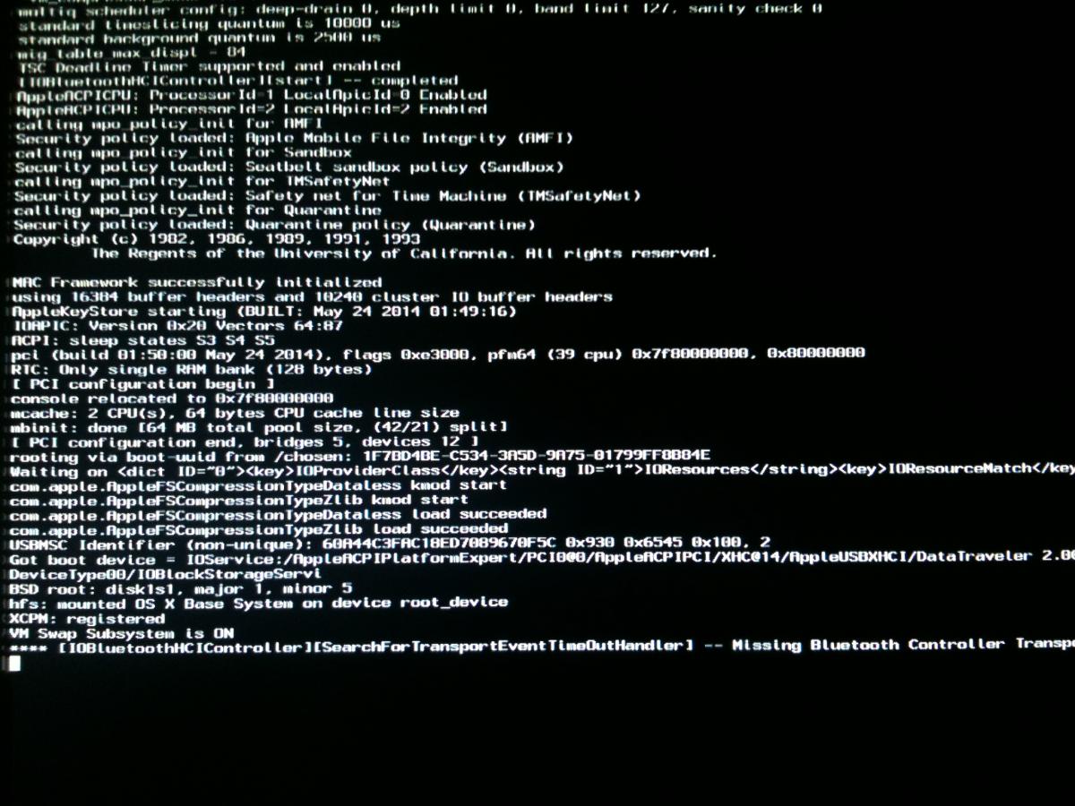

hafudo Posted June 5, 2014 Share Posted June 5, 2014 Nothing updates whatever I type/enter, it just hangs up and then "missing bluetooth controller transport" appeared, that's all. unplug and then plug in again from usb port after showin IOBluetooth it was worked for me. but after processing FakeSMC, my computer always reboot Link to comment https://www.insanelymac.com/forum/topic/298424-boot-guide/page/4/#findComment-2025486 Share on other sites More sharing options...
hafudo Posted June 5, 2014 Share Posted June 5, 2014 removing graphic kext from USB installer booting using -v -x -f -s kext-dev-mode=1 lading FakeSMC.kext and NullCPUPowerManagement.kext then exit. now getting light grey screen and then change to dark grey screen and nothin load. the cursor is not showing spinning beach ball Link to comment https://www.insanelymac.com/forum/topic/298424-boot-guide/page/4/#findComment-2025498 Share on other sites More sharing options...

hafudo Posted June 5, 2014 Share Posted June 5, 2014 Which your graphic card.GeForce or AMD? it's AMD. boom... its working now. 1. unplug ethernet cable 2. booting using -v -x -s kext-dev-mode=1 3. unplug and replug usb keyboard when hang reaching the bash 4. loading FakeSMC.kext then exit 5. boom..... getting to installer menu Link to comment https://www.insanelymac.com/forum/topic/298424-boot-guide/page/4/#findComment-2025554 Share on other sites More sharing options...
