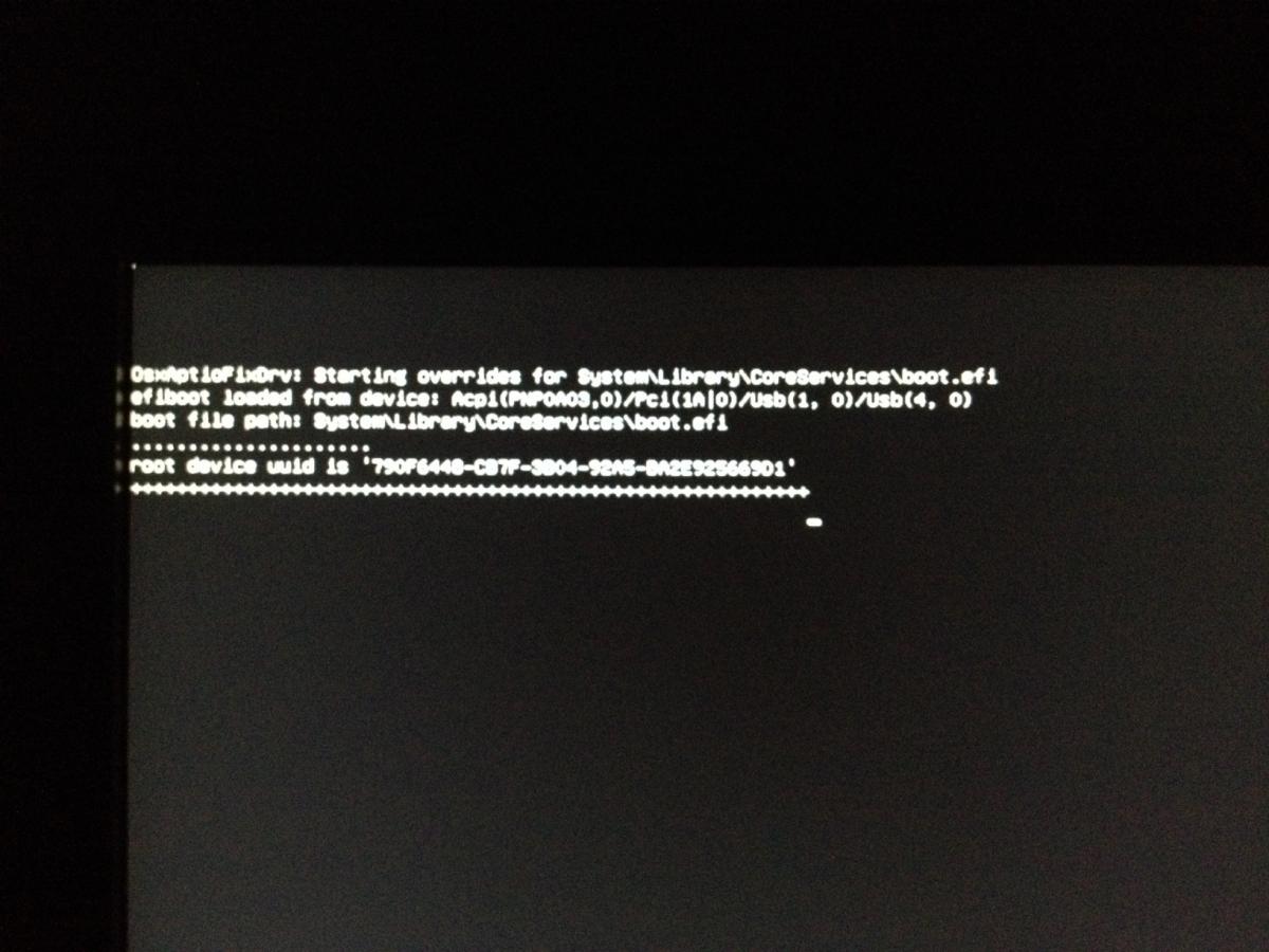

Download the 2693 update files for clover and manually update it. I'm guessing it's looking for mach_kernel in the wrong place (because the location has changed since mavericks)

Edit: Still getting the "can't find mach_kernel" but it was worth a shot!
I don't have the installer open now, but are you able to open the Log Viewer? That would be an easy way to see what is going on.

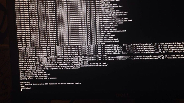

I rebuilt my USB and actually got through the install successfully, now I just can't boot. Instant reboot when I should be hitting GUI. Any suggestions?
make sure your fakesmc is installed to S/L/E and is loading (force load it in single user mode if necessary)

What could be the problem if I don't get beyond that??? System complete hangs up...
I have the same issue, instead of hanging, I only got instant reboot.

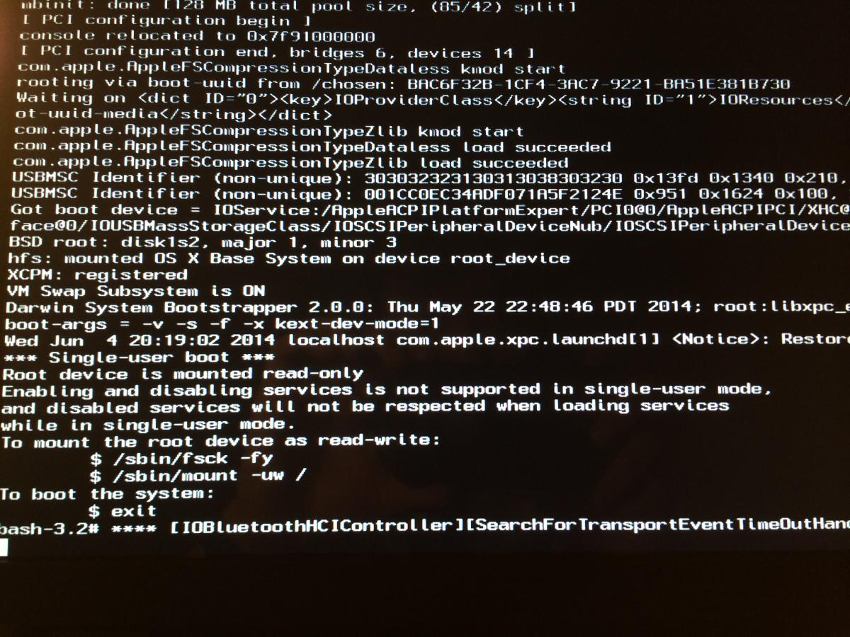

If you're at the single user prompt, hit enter. You'll be taken to the next line.

Thought I read somewhere about a Haswell/Clover conflict? I'm new to Clover, but I think I saw something about Haswell processors. Might be worth looking into.
I can only assume your keyboard isn't working lol cuz mine does the exact same thing, it's just log messaged rolling over into the bash command line, but as soon as I hit enter, I get a new bash prompt. Try a different keyboard? I have no idea.
I know my keyboard won't work in a USB 3.0 port with clover....?
Yeah, I think it's the keyboard too, because none of the keys worked. Usually at least caps lock should work.
Thanks ADHDMedia, you are being helpful.
Do you have to click your way through clover? Keystrokes should work there too. And ya, if your caps lock light doesn't light, I bet u the keyboard just isn't working man.
That's what confused me, because my keyboard worked perfectly in the Clover menu, maybe I should try the usb3 driver.
