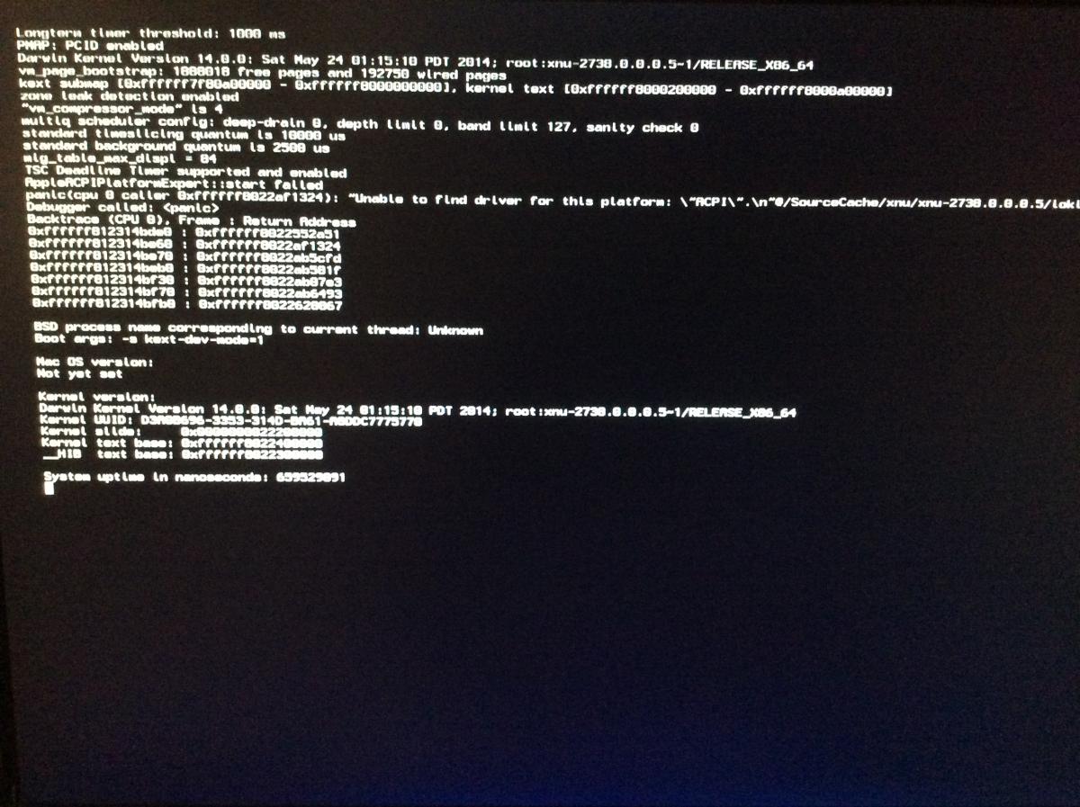

perl -pi -e 's|(\x3B\x05\xAE\xFC\x69\x00)\x74\x11|${1}\xEB\x11|g' kernel
RehabMan, you rock!!!
I could not use that terminal command on the kernel while it resided in System/Library/Kernels.  But I copied the kernel to my desktop and patched it there. Then I moved it back to System/Library/Kernels and rebooted.  I did not use cpus=1 and had no Lapic KP and, upon boot up, had both of my cores working.  Many thanks.
Modifying things in /System requires 'sudo'. I updated the post to clarify.
Although... hopefully, people who don't know that aren't attempting to run a DP...

Now that the initial excitement about multi-core function is over, can you explain what this patch does?  I didn't find anything when I searched it in Google.  I know that Donovan6000's Lapic patch replaced the KP line of code with a no operation code so that when APIC initializes differently on an HP laptop than on a mac, instead of calling for a KP, it calls a no op and continues booting.  What does this one do?
Good update on the original suggestion.  Others might not have thought to make a back up of their kernel before attempting the patch.
This one jumps around the KP. Changes a conditional jump (74) to unconditional (EB).
