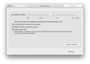

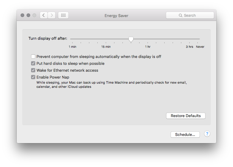

Franckhoeger Posted December 3, 2015 Share Posted December 3, 2015 It restart even on Login window when unit goes in sleep mode. AppleLPC is not loaded from the beginning (El Capitan setup's date 7th november) The is a screenshot of my Power Manager settings. Link to comment https://www.insanelymac.com/forum/topic/295587-power-management-for-sandyivy-bridgehaswell-cpus/page/19/#findComment-2193874 Share on other sites More sharing options...
Allan Posted December 4, 2015 Share Posted December 4, 2015 Uncheck all this options. 1 Link to comment https://www.insanelymac.com/forum/topic/295587-power-management-for-sandyivy-bridgehaswell-cpus/page/19/#findComment-2193914 Share on other sites More sharing options...

Franckhoeger Posted December 4, 2015 Share Posted December 4, 2015 Ok, there are some good news. @Allan, when I use your config.plist and DSDT.aml, I got unit restarted when it goes to sleep if almost all options in Power management settings are checked. I tried without checked options, I can wake up unit. @artur_pt, I got AppleLPC loaded thanks to your DSDT file I am testing these settings : "Put HD to sleep when possible and PowerNAP", I hope it will work. To be continued 1 Link to comment https://www.insanelymac.com/forum/topic/295587-power-management-for-sandyivy-bridgehaswell-cpus/page/19/#findComment-2194070 Share on other sites More sharing options...

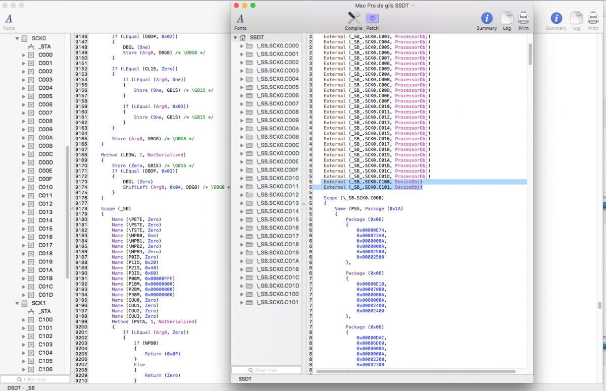

gils83 Posted January 4, 2016 Share Posted January 4, 2016 hello all no problem power management (works very good) but no turbo . (3930k/ASRock Rack) one idea ? thanks Mac Pro de gils.acpi.zip Link to comment https://www.insanelymac.com/forum/topic/295587-power-management-for-sandyivy-bridgehaswell-cpus/page/19/#findComment-2202898 Share on other sites More sharing options...
Allan Posted January 4, 2016 Share Posted January 4, 2016 U use Piker's script? Link to comment https://www.insanelymac.com/forum/topic/295587-power-management-for-sandyivy-bridgehaswell-cpus/page/19/#findComment-2202905 Share on other sites More sharing options...

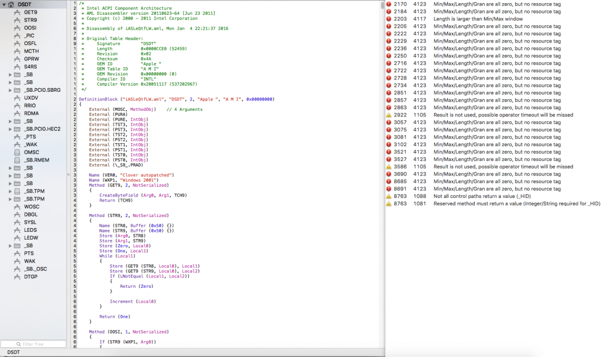

gils83 Posted January 4, 2016 Share Posted January 4, 2016 hello MaciASIL , but impossible compile lot of error Link to comment https://www.insanelymac.com/forum/topic/295587-power-management-for-sandyivy-bridgehaswell-cpus/page/19/#findComment-2202913 Share on other sites More sharing options...
tyufhl Posted January 4, 2016 Share Posted January 4, 2016 hello MaciASIL , but impossible compile lot of error Hey. These nuclei not DSDT. Therefore errors. Link to comment https://www.insanelymac.com/forum/topic/295587-power-management-for-sandyivy-bridgehaswell-cpus/page/19/#findComment-2202924 Share on other sites More sharing options...

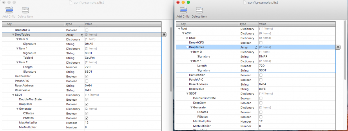

tyufhl Posted January 5, 2016 Share Posted January 5, 2016 gils83, it can do so, disable DropTables, DropOem, Generate enclose SSDT. Patch from this thread http://www.insanelymac.com/forum/topic/306734-sandy-bridge-e-ivy-bridge-e-power-management-1011-final-app-store-realease/?hl=+sandy%20+bridge#8208e SSDT-6.aml.zip Link to comment https://www.insanelymac.com/forum/topic/295587-power-management-for-sandyivy-bridgehaswell-cpus/page/19/#findComment-2203002 Share on other sites More sharing options...

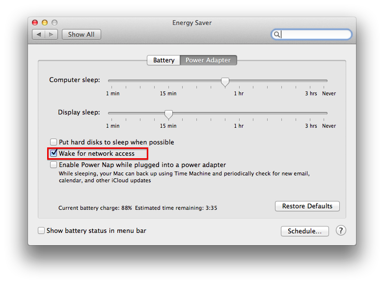

Allan Posted February 15, 2016 Share Posted February 15, 2016 I get these problems from terminal. Can someone help me? syslog |grep -i "sleep" These errors are normal. syslog | grep -i "Wake Reason" Uncheck this option, and try again: Link to comment https://www.insanelymac.com/forum/topic/295587-power-management-for-sandyivy-bridgehaswell-cpus/page/19/#findComment-2215759 Share on other sites More sharing options...
menman Posted February 15, 2016 Share Posted February 15, 2016 I already had this option unchecked The problem is that I'll sleep the pc, and it'll wake right back up within seconds. The screen will stay off but the fans will start up again. Link to comment https://www.insanelymac.com/forum/topic/295587-power-management-for-sandyivy-bridgehaswell-cpus/page/19/#findComment-2215799 Share on other sites More sharing options...
