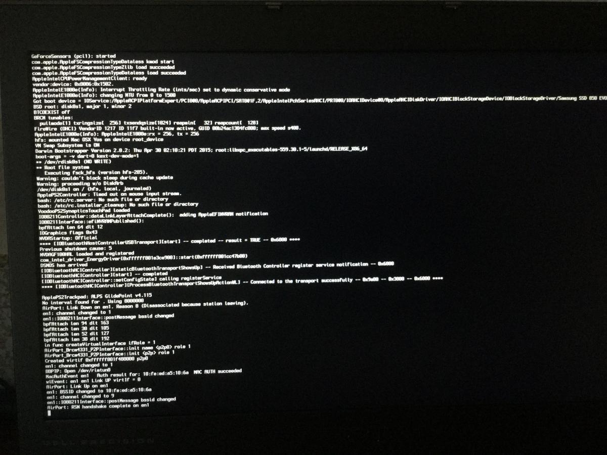

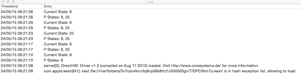

howoarang Posted May 24, 2015 Share Posted May 24, 2015 Boot your OS X again, and if stop, take a photo and put here. Hi, there are two photos: 1. PStates with NullCPU 2. Screenshot of booting system without NullCPU, when the system hangs on: PS: AppleIntelCPUPower is patched, SSDT.aml I have generated for my CPU, in Clover DropOEM are checked. But without NullCPU system won't boot. Link to comment https://www.insanelymac.com/forum/topic/295587-power-management-for-sandyivy-bridgehaswell-cpus/page/16/#findComment-2138234 Share on other sites More sharing options...
Allan Posted May 24, 2015 Share Posted May 24, 2015 Use this option in your config.plist: http://clover-wiki.zetam.org/Configuration/KernelAndKextPatches#AsusAICPUPM In this pic, the AICPM is not loaded. Link to comment https://www.insanelymac.com/forum/topic/295587-power-management-for-sandyivy-bridgehaswell-cpus/page/16/#findComment-2138267 Share on other sites More sharing options...
