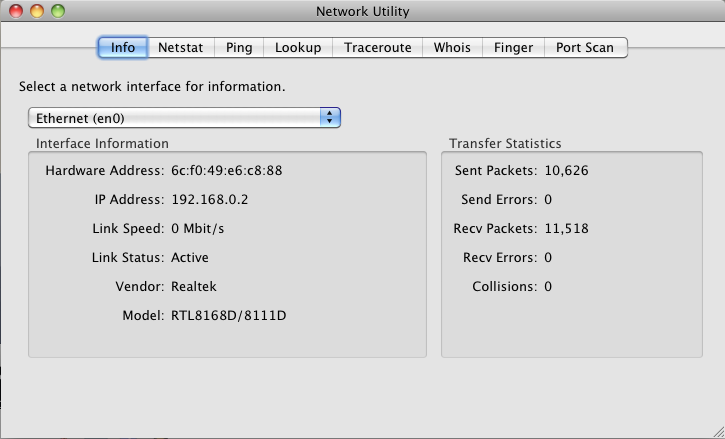

m71 Posted May 25, 2010 Share Posted May 25, 2010 Hi there, I followed the kakewalk installation to get my x58A-UD3R set up and everything works...except the network is very slow, transferring at about 10MBps. The strange thing is tha tthe network utility doesn't show the actual link speed: Is there some setting somewhere I can try to get this running at gig-e? Link to comment https://www.insanelymac.com/forum/topic/29436-realtek-81688111-solution/page/31/#findComment-1475257 Share on other sites More sharing options...
MacUser2525 Posted May 25, 2010 Share Posted May 25, 2010 Is there some setting somewhere I can try to get this running at gig-e? System Preferences -> Network select the nic from the list then press Advanced button -> Ethernet -> Configure to set Manually -> Speed to select it from the list and may as well make sure it is Full Duplex in the list box below that one. Link to comment https://www.insanelymac.com/forum/topic/29436-realtek-81688111-solution/page/31/#findComment-1475533 Share on other sites More sharing options...
