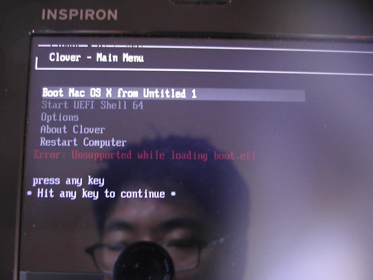

blaznc Posted August 24, 2016 Share Posted August 24, 2016 Attempting to install 10.10.2 on n4110 Intel HD3000 graphics. BIOS updated (from first post), Clover (files from first post) boots install USB media, drive partitions (is a CF to SATA adapter, drive reports as removable if this matters) and OS install runs but Clover will not load from internal drive post install. Results in attached error. Thoughts? Link to comment https://www.insanelymac.com/forum/topic/293246-osx-on-dell-vostro-3450-inspiron-n4110-xps-l702x-uefi-clover/page/44/#findComment-2269520 Share on other sites More sharing options...

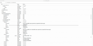

thesuffering Posted August 24, 2016 Share Posted August 24, 2016 I was able to get 10.11.6 to successfully install and boot, and have eliminated most problems with it. This is my specific hardware. USB3 and Ethernet were tracked down in ioreg. I cant guarantee this will work for any other model, but this should help at least some people. Intel Core i7-2640m - Series 6 - HM67 chipset - 6GB DDR3 - HD3000 1366x768- Realtek RTL8105 Ethernet - Fresco Logic FL1009 USB3 - Azureware Broadcom BCM94352HMB wifi/bluetooth (this is replaced from the OEM Intel Centrino card) Rehabman was a HUGE help in figuring this all out. First off, previous posts state that if you had Realtek 8100 ethernet you had Renesas/NEC USB3, and if you had Realtek 8111 Gigabit you had Fresco Logic USB3. Turns out, this particular laptop has 8100 Fast Ethernet with Fresco Logic FL1009 USB3. Im not going to write a guide on how to put the El Capitan installer from appstore onto a usb stick. There are plenty of guides out there. I used a 16GB USB 2.0 stick. USB stick is GUID and formatted HFS+J Ill give the specific details on what I did unique to make this all work: Clover r3625 Options checked on clover install customize: Install for UEFI only Bluemac theme OsxAptioFixDrv-64 from Drivers64UEFI After install, download HFSPlus.efi from https://github.com/JrCs/CloverGrowerPro/raw/master/Files/HFSPlus/X64/HFSPlus.efiand copy it to copy it to /EFI/Clover/drivers64UEFI Remove the folders EFI/CLOVER/kexts/10.6, 10.7, 10.8, 10.9, 10.10, leaving just 'Other' In the Other folder install the following Kexts: https://github.com/RehabMan/OS-X-FakeSMC-kozlek https://github.com/RehabMan/OS-X-Voodoo-PS2-Controller https://bitbucket.org/RehabMan/os-x-usb-inject-all/downloads In google, type injector kext + FL1009 + rehabman. Choose the first result from google. In the 2nd post download the file USBXHCI_FL1009.kext . Place this file in the Other folder as well. Next we need to install a config.plist file that matches our hardware. https://github.com/RehabMan/OS-X-Clover-Laptop-Config/archive/master.zip From the file, we need config_HD3000_1366x768.plist. Copy it to your desktop and rename it config.plist Before putting it in our EFI/Clover folder, we need to modify it, or we will get a kernel panic in AppleIntelCPUPowerManagement. Use a plist editor, like Xcode or similar to open the .plist file. In conflig.plist/ACPI rename DropTables to ##DropTables and then rename #DropTables to DropTables Next under config.plist/ACPI/SSDT/Generate, change CStates and PStates to true for both (YES in Xcode) Save the changes and place the config.plist file on your desktop in /EFI/Clover/ overwriting the file thats there. Done, boot from USB, select the installer and it should do its magic. From this point update Clover onto the HDD, and install all kexts to the system volume. You'll still need to install kexts and/or DSDT edits for wifi, battery, audio, ethernet, bluetooth, brightness slider, etc. Im not going to get into these. There are several guides out there for these and they are straight forward. 1 Link to comment https://www.insanelymac.com/forum/topic/293246-osx-on-dell-vostro-3450-inspiron-n4110-xps-l702x-uefi-clover/page/44/#findComment-2269536 Share on other sites More sharing options...

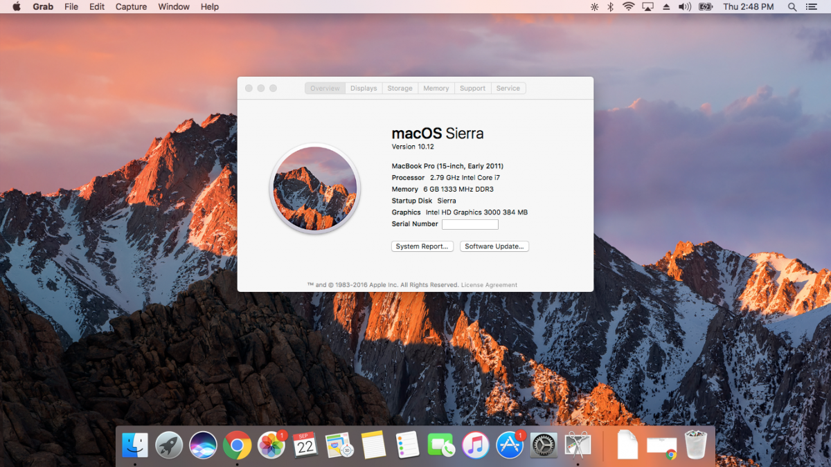

thesuffering Posted September 23, 2016 Share Posted September 23, 2016 I have Sierra running pretty great on my N4110. Used the same procedure I posted to get El Capitan installed I posted several posts back. Works: Wifi 2.4/5.0 Bluetooth Sound Mic Battery Meter Brightness Graphics USB 2.0 & 3.0 This should be 100% from what I can tell. Sound required ALC269VBv4 (patched AppleHDA.Kext attached here), plus some patches applied via Clover. I added the following to my config.plist. Wifi/BT I changed the oem card to the Azureware BCM94352HMB. It requires fakepciid.kext and fakepciid_Broadcom_WiFi.kext. In Sierra it now requires a patch (see the config.plist screenshot) USB was USBInjectAll.kext (newest one updated for Sierra) and USBXHCI_FL1009.kext (Fresco Logic USB3 only) Battery Meter required DSDT patch from Rehabman for XPS13 and ACPIBatteryManager.kext Brightness Meter was DSDT patch from Rehabman for HD3000 Bluetooth was BrcmPatchRAM2.kext and BrcmFirmwareRepo.kext AppleHDA-276.26-ALC269VB_v4.zip Link to comment https://www.insanelymac.com/forum/topic/293246-osx-on-dell-vostro-3450-inspiron-n4110-xps-l702x-uefi-clover/page/44/#findComment-2282970 Share on other sites More sharing options...

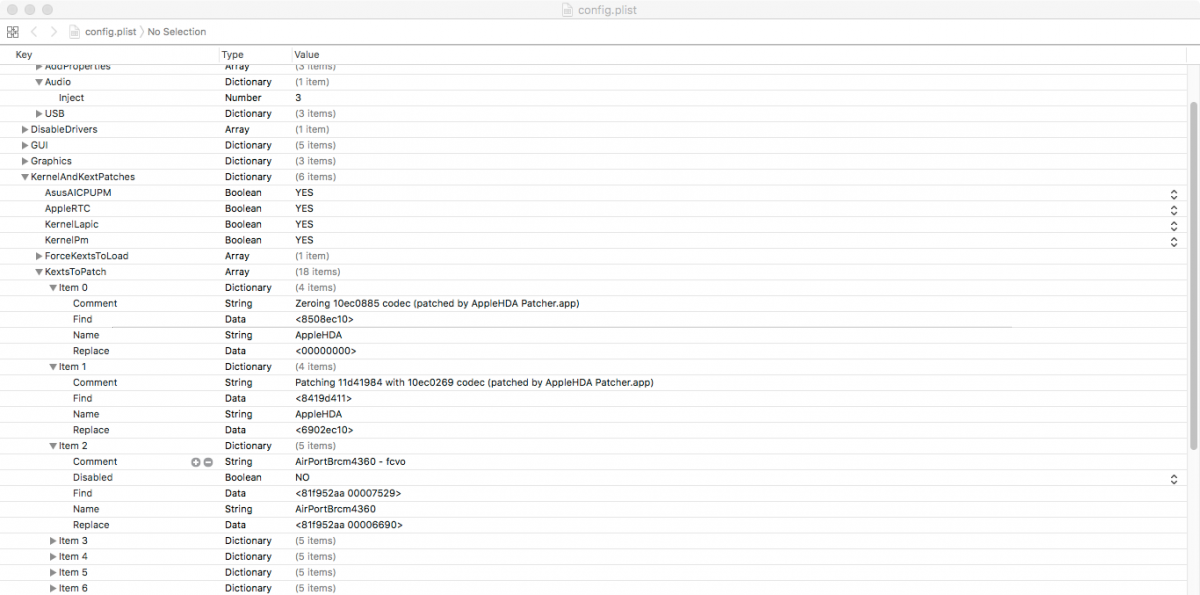

thesuffering Posted September 23, 2016 Share Posted September 23, 2016 Can you upload your EFI.Because i tried my EFI but can't boot Sierra Here is my clover folder from the usb i used to boot the installer. Keep in mind it doesnt have the theme folder, so you'll need that with the bluemac theme. IMPORTANT: Download and install Clover r3625 to your usb. Under theme choose bluemac. *Basically follow the clover guide from Rehabman (mine was for UEFI booting). My N4110 has Realtek 8105 ethernet and Fresco Logic USB 3.0, so the kexts in the /Other folder might not work for you. Let me know if you have any luck! CLOVER.zip Link to comment https://www.insanelymac.com/forum/topic/293246-osx-on-dell-vostro-3450-inspiron-n4110-xps-l702x-uefi-clover/page/44/#findComment-2283300 Share on other sites More sharing options...

nhocbaby76 Posted September 23, 2016 Share Posted September 23, 2016 Here is my clover folder from the usb i used to boot the installer. Keep in mind it doesnt have the theme folder, so you'll need that with the bluemac theme. IMPORTANT: Download and install Clover r3625 to your usb. Under theme choose bluemac. *Basically follow the clover guide from Rehabman (mine was for UEFI booting). My N4110 has Realtek 8105 ethernet and Fresco Logic USB 3.0, so the kexts in the /Other folder might not work for you. Let me know if you have any luck! I met AppleIntelCpupowermanagement kernel panic when boot with your EFI.I think because my laptop is core i3 ....Can you help me change DSDT to core i3.Because i'm very noob about DSDT and SSDT Link to comment https://www.insanelymac.com/forum/topic/293246-osx-on-dell-vostro-3450-inspiron-n4110-xps-l702x-uefi-clover/page/44/#findComment-2283336 Share on other sites More sharing options...
thesuffering Posted September 23, 2016 Share Posted September 23, 2016 I met AppleIntelCpupowermanagement kernel panic when boot with your EFI.I think because my laptop is core i3 ....Can you help me change DSDT to core i3.Because i'm very noob about DSDT and SSDT Note regarding CPU power management and SSDTs If you're getting a panic in AppleIntelCPUPowerManagement and/or SMC_ACPI_PlatformPlugin it may be related to your OEM CPU power management related SSDTs. Some systems may need to drop some of the OEM SSDTs. This happens most frequently with Sandy Bridge systems (but not all). There are two configurations for DropTables in the provided config.plist files. The default is minimal. The alternate is named #DropTables and is a bit more aggressive. Each configuration resides in config.plist/ACPI. You can use the alternate by renaming DropTables->##DropTables and renaming #DropTables->DropTables (in that order). Depending on how the OEM labels the tables, this may or may not work. If you still have issues, set config.plist/ACPI/SSDT/DropOem=true. You will need to set config.plist/ACPI/SSDT/Generate=true (or the individual CStates/PStates=true) to use DropOem=true or the alternate DropTables. Always use a plist editor (such as Xcode or PlistEdit Pro) to edit config.plist. Try deleting the DSDT and SSDT in /ACPI/Patched. You obviously will need one for your own hardware after install. The config.plist i provided should already have the above in it, but double check it. I used the more aggressive option. You shouldnt need a patched DSDT and SSDT for the installer AFAIK 1 Link to comment https://www.insanelymac.com/forum/topic/293246-osx-on-dell-vostro-3450-inspiron-n4110-xps-l702x-uefi-clover/page/44/#findComment-2283351 Share on other sites More sharing options...
nhocbaby76 Posted September 23, 2016 Share Posted September 23, 2016 Thanks @thesuffering for your support.After remove dsdt and ssdt i can boot to my device 1 Link to comment https://www.insanelymac.com/forum/topic/293246-osx-on-dell-vostro-3450-inspiron-n4110-xps-l702x-uefi-clover/page/44/#findComment-2283414 Share on other sites More sharing options...
