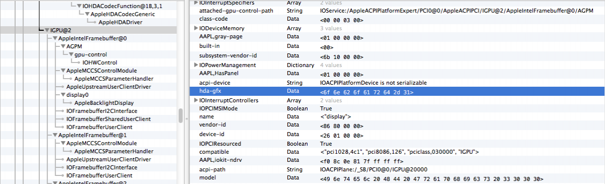

TimeWalker75a Posted November 1, 2013 Author Share Posted November 1, 2013 I believe that these tables are set up for me 14R. I do not understand why the graphics card not being disabled because the method is already implemented in SSDT-2 Scope (\ _SB.PCI0.PEG0). SSDT-3 I extracted the script Revogirl. Actually I had not put this method before and now put, and now my audio and wifi does not work. One detail that is present now in the ioreg GFX0, Please find attached files. Are you serious? I've looked at ACPI tables injected in your IOREG and you were using SSDT-2 from Vosotro, because it lacks PEG0 scope and has Fresco Logic model for XHCI controller. Your config is not being loaded because none of the patches are bing applied from Clover. When providing dumps intend to use DarwinDumper instead, as it provides complete information about the system as well as most needed logs. I can't tell much based on just ACPI tables and IOREG. Can you explain what is the role of PtidTabl? Should we really drop it? It's a universal monitoring device on mobile and desktop platforms. kozlek's ACPISensors plugin can read data from it. The thing with these two machines as well as XPS 15/15z/17 and Vostro 3750 is that kozlek's plugin will pick the table and populate sensors with it, but the table actually doesn't work as there is no device H_EC to which grand majority of sensors are referring.. so only DTS1 and DTS2 sensors are being properly picked up, but we already monitor these. Link to comment Share on other sites More sharing options...

styrian Posted November 2, 2013 Share Posted November 2, 2013 Really tested here and not have HDMI audio working, the Zprood does not work? I think, that you have to patch the port for HDMI of your installed AppleIntelSNBGraphicsFB.kext. On my EDGE E320 with AMD 6630m and HD3000 I have done the following steps and got HDMI with audio working: DSDT.aml: In section HDEF: Method (_DSM, 4, NotSerialized) { Store (Package (0x16) { "codec-id", Buffer (0x04) { 0x6E, 0x50, 0xF1, 0x14 }, "hda-gfx", Buffer (0x0A) { "onboard-2" }, "AAPL,slot-name", Buffer (0x09) { "Built In" }, "layout-id", Buffer (0x04) { 0x0C, 0x00, 0x00, 0x00 }, "model", Buffer (0x1A) { "HD Audio Conexant Cx20590" }, "name", Buffer (0x11) { "Conexant Cx20590" }, "location", Buffer (0x02) { "3" }, "subsystem-id", Buffer (0x04) { 0x0C, 0x00, 0x00, 0x00 }, "subsystem-vendor-id", Buffer (0x04) { 0x58, 0x14, 0x00, 0x00 }, "device_type", Buffer (0x09) { "HD audio" }, "PinConfigurations", Buffer (Zero) {} }, Local0) DTGP (Arg0, Arg1, Arg2, Arg3, RefOf (Local0)) Return (Local0) } } Read marked lines are neccessary if not injected or activated by bootloader. In GFX0 (IGPU) the following DSM method right after: Name (_ADR, 0x00020000) Method (_DSM, 4, NotSerialized) { Store (Package (0x06) { "AAPL,snb-platform-id", Buffer (0x04) { 0x00, 0x00, 0x01, 0x00 }, "hda-gfx", Buffer (0x0A) { "onboard-2" }, "device-id", Buffer (0x04) { 0x26, 0x01, 0x00, 0x00 } }, Local0) DTGP (Arg0, Arg1, Arg2, Arg3, RefOf (Local0)) Return (Local0) } I have also patched the blue marked line for HDMI port of AppleIntelSNBGraphicsFB from 0000000: 0102 0400 1007 0000 1007 0000 ............ 000000c: 0503 0000 0200 0000 3000 0000 ........0... 0000018: 0205 0000 0004 0000 0700 0000 ............ 0000024: 0304 0000 0004 0000 0900 0000 ............ 0000030: 0406 0000 0004 0000 0900 0000 ............ to 0000000: 0102 0300 1007 0000 1007 0000 ............ 000000c: 0100 0000 0200 0000 3000 0000 ........0... 0000018: 0205 0000 0008 0000 0600 0000 ............ 0000024: 0602 0000 1000 0000 0900 0000 ............ 0000030: 0000 0000 0004 0000 0900 0000 ............ The green marked lines are for working VGA port on my e320. (Last port set to zero, because it is does not exist on e320 and caused gfx-glitches) For doing the hex edit you can use a hex editor or just run the attached script of modigliani (olarila.com). I hope this can help you to solve your problem with hdmi audio. Have fun. modigliani-intelhd3000Patch-v4-ML.zip Link to comment Share on other sites More sharing options...
Zprood Posted November 2, 2013 Share Posted November 2, 2013 Really tested here and not have HDMI audio working, the Zprood does not work? you can see what's going on hdmi audio, i haven't a device to test whether it works or not. but basically it should work. <6f 6e 62 6f 61 72 64 2d 31> means "<onboard-1>" Link to comment Share on other sites More sharing options...
TimeWalker75a Posted November 2, 2013 Author Share Posted November 2, 2013 I think, that you have to patch the port for HDMI of your installed AppleIntelSNBGraphicsFB.kext. On my EDGE E320 with AMD 6630m and HD3000 I have done the following steps and got HDMI with audio working: DSDT.aml Please don't mislead people in this guide. The connectors are already being properly patched. I've also described the situation with _DSM on GFX0 twice in my last two post, so if you don't full understand the concept of ACPI and what happens when you have two DSM methods on same device across two ACPI tables I suggest you try yourself... also, this guide doesn't need you to have a prepatched dsdt, so there goes misleading again. @Zprood, it's a bug in clover, it should be MacRoman and say onboard-1, but it doesn't.. a lot of people have noticed it doesn't actually allow hdmi audio to pass through. Link to comment Share on other sites More sharing options...
