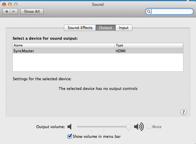

toleda Posted October 9, 2014 Author Share Posted October 9, 2014 Here the new file No change. Patch is not correct. 10.9.5 Native Capri/03 00 66 01 02 05 00 00 00 04 00 00 07 04 00 00 Your script: 02 05 00 00 00 04 00 00 07 01 00 00Â Link to comment https://www.insanelymac.com/forum/topic/292999-mavericks-applehda-hdmi-audio/page/12/#findComment-2067672 Share on other sites More sharing options...
ciuffoly Posted October 9, 2014 Share Posted October 9, 2014 solved with this  perl -pi -e 's|\x02\x05\x00\x00\x00\x04\x00\x00\x07\x04\x00\x00|\x02\x05\x00\x00\x00\x08\x00\x00\x06\x00\x00\x00|g' AppleIntelFramebufferCapri   GOOD  !!!   but I don't understand where you have found 07 04 Link to comment https://www.insanelymac.com/forum/topic/292999-mavericks-applehda-hdmi-audio/page/12/#findComment-2067673 Share on other sites More sharing options...
