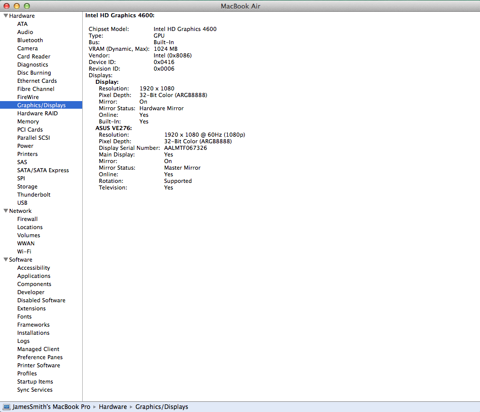

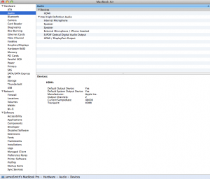

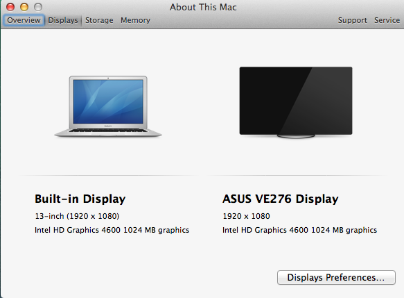

jsl Posted September 27, 2014 Share Posted September 27, 2014 (edited) My mistake, failed dsdt usually means no boot/Desktop. Do you mean all were no HDMI audio? All attached dsdts have the same problem, remove dsdt/HDEF/hda-gfx injection. (edits were not from Post #1/Tools) Attach a screenshot of System Information/Hardware/Graphics/Displays Toleda, you are my Hero ! Thank you very much for your advice which reminds me to double check my HDMI device's compatibility again. Unfortunately the new Asus 4K monitor is the cause of failure. When I connected to an old Asus Monitor or Sony TV, all three DSDT.aml got working HDMI audio successfully. And the timing to connect is also critical. It must be connected after get boot device and before welcome Apple icon, otherwise it maybe failed or poor sound quality from HDMI audio. The next step is to solve my DSDT/SSDT problems in Clover boot, otherwise this is not working in Yosemite of G750 Laptop. Edited September 28, 2014 by jsl Link to comment https://www.insanelymac.com/forum/topic/292999-mavericks-applehda-hdmi-audio/page/11/#findComment-2064410 Share on other sites More sharing options...

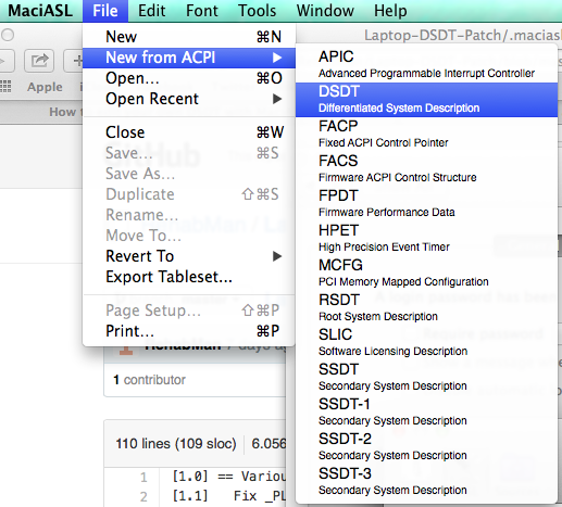

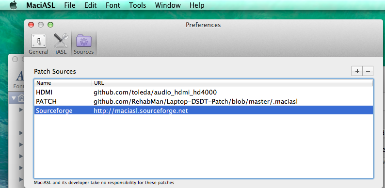

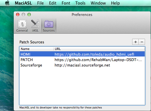

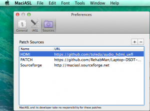

ciuffoly Posted October 4, 2014 Share Posted October 4, 2014 Toleda, could you help me ? I need to enable HDMI Audio and CS4213 Audio on my Dell Vostro 2520 Actually I have done this: - rm /Volumes/Untitled/Extra/DSDT.aml (boot loader on USB) and /Extra/DSD.aml (bootloader on HD) - Run MaciASL - add 2 entry in Preferences Source: PATCHES, http://raw.github.co...DT-Patch/master HDMI, https://raw.github.c...i_hd4000/master - extract DSDT.aml from the system (menu new from ACPI and DSDT) - patched DSDT.aml to eliminate 2 errors with Fix _PLD Buffer/Package Error and Fix *pnp/pnp lower case Error - patched DSDT to add AMI-HD4000-Laptop-FB_03-A1 - insert DSDT.aml in /Extra or /Volumes/Untitled/Extra/DSDT.aml Now ? P.S. I still using bootloader on USB because the actual partion of my HD is not supported by chain0 and tboot but this is not a big problem, I will solve in the future. CodecDump.zip Link to comment https://www.insanelymac.com/forum/topic/292999-mavericks-applehda-hdmi-audio/page/11/#findComment-2066147 Share on other sites More sharing options...

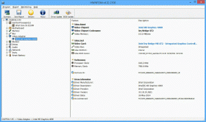

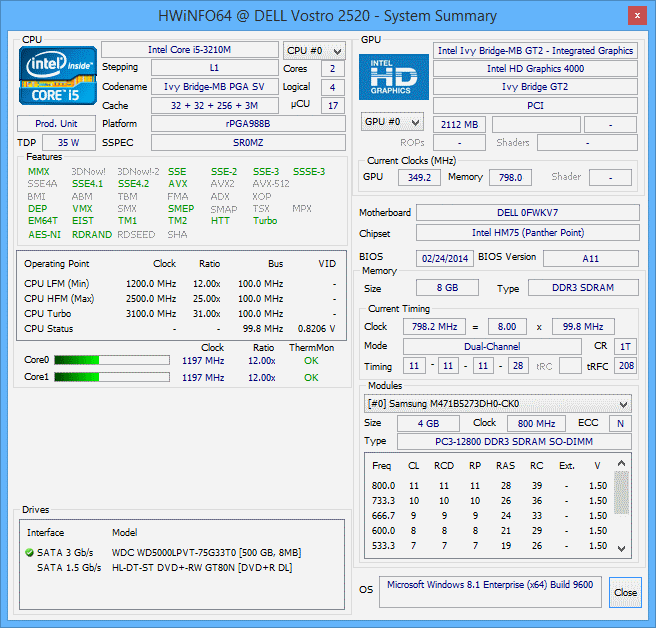

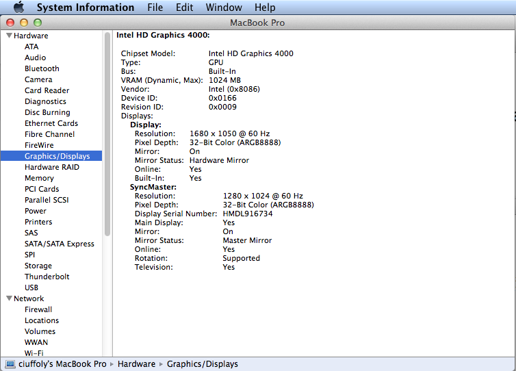

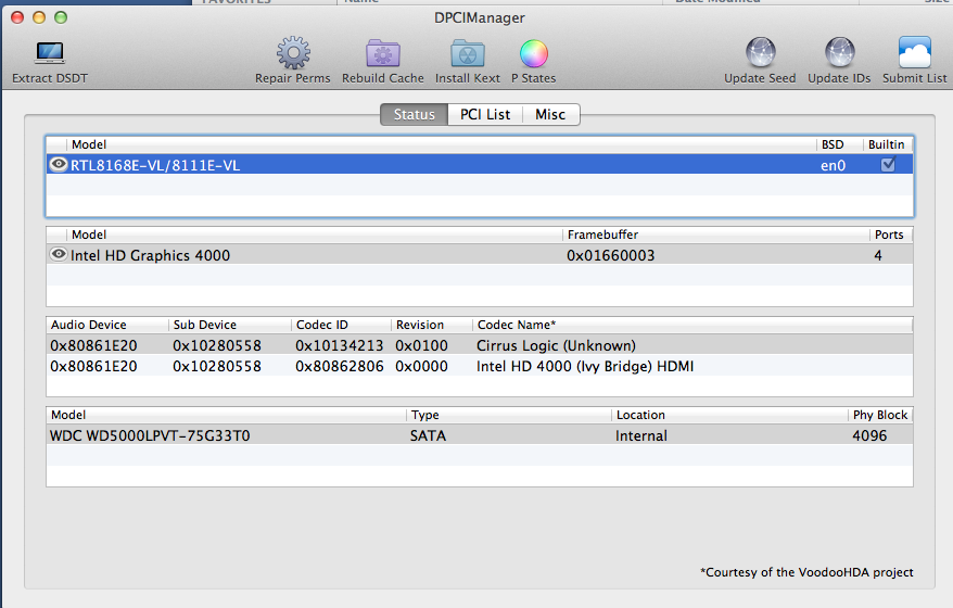

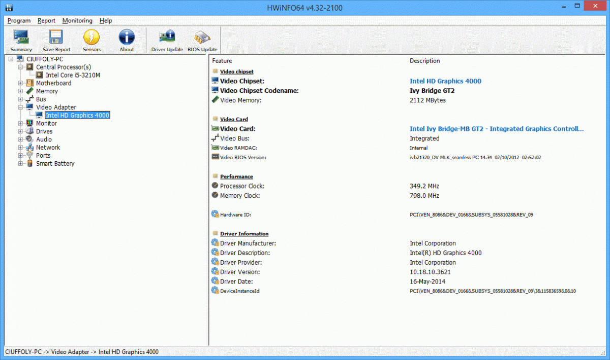

ciuffoly Posted October 7, 2014 Share Posted October 7, 2014 OS X version/motherboard model/BIOS version/processor/graphics OS X 10.9.5 Mavericks Laptop DELL Vostro 2520 Processor I5 Graphics HD4000 Procedure/Guide Used Unibest + 10.9.5 iso download from Apple store Copy of IOReg or IOJones IORegistryExplorer_v2.1.zip (see attach) IOJones (see attach) Chameleon Extra/org.chameleon.Boot.plist (see attach) DPCIManager/Misc/Boot Log (how to produce it) Extra/dsdt.aml (not installed) Extra/ssdt.aml (not installed) This is the situation after the installation so without any changes, if you want I can proceed with the MaciASL patching for HD4000. P.S. : Now I am using the boot loader on USB CodecDump.zip ciuffoly’s MacBook Pro Reg.zip ciuffoly’s MacBook Pro.zip org.chameleon.Boot.plist.zip DSDT.aml.zip Screen Shot 2014-10-07 at 3.26.22 AM.zip Link to comment https://www.insanelymac.com/forum/topic/292999-mavericks-applehda-hdmi-audio/page/11/#findComment-2067045 Share on other sites More sharing options...

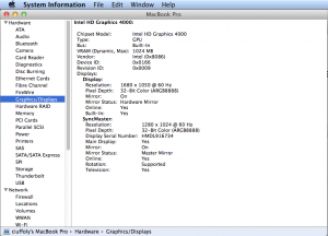

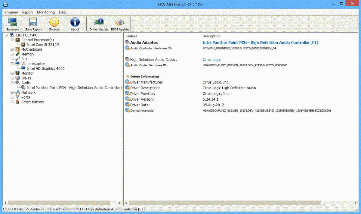

toleda Posted October 7, 2014 Author Share Posted October 7, 2014 This is the situation after the installation so without any changes, if you want I can proceed with the MaciASL patching for HD4000. P.S. : Now I am using the boot loader on USB Windows screenshots are not useful. Must boot from hard drive. Fix first Proceed with MaciASL, Patch/AMI-HD4000-Laptop-FB_03-A1 matches what you are using. Reply with updated files Link to comment https://www.insanelymac.com/forum/topic/292999-mavericks-applehda-hdmi-audio/page/11/#findComment-2067138 Share on other sites More sharing options...

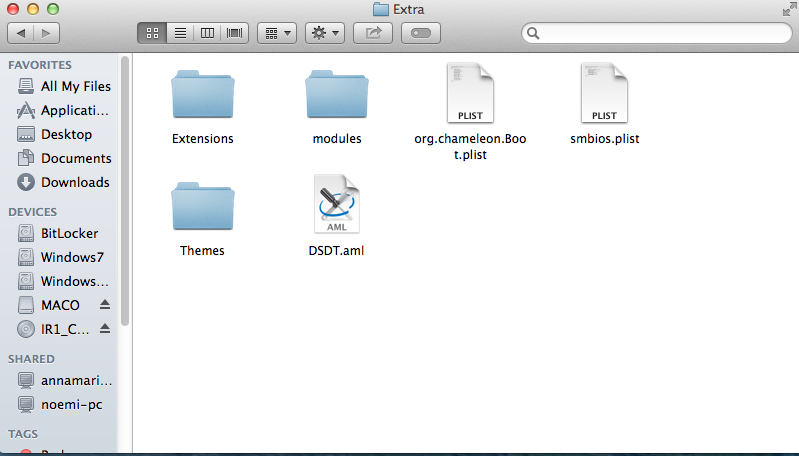

ciuffoly Posted October 8, 2014 Share Posted October 8, 2014 This evening a new installation from zero to clear all. USB key for installation created with [url="http://www.insanelymac.com/forum/topic/279450-why-insanelymac-does-not-support-tonymacx86/"]#####[/url] software + OS X Mavericks 10.9.5 original from Apple store Patching of OSInstall.mpkg and OSInstall on USB key to use MBR partition, I have Windows 8.1 and Windows 7 on the same HD Here some screen capture of the MacASL proceduce. The DSDT.aml has been created. P.S. Now I am using the boot loader on USB key so I am updating the boot files in /Volume/[usb key]/Extra ciuffoly’s MacBook Pro.zip IOREg.zip DSDT.aml.zip org.chameleon.Boot.plist.zip smbios.plist.zip IOReg_after_LayoutID3.zip IOJones_after_LayoutID3.zip org.chameleon.Boot_after_LayoutID3.plist.zip Link to comment https://www.insanelymac.com/forum/topic/292999-mavericks-applehda-hdmi-audio/page/11/#findComment-2067488 Share on other sites More sharing options...

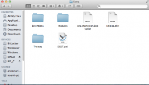

ciuffoly Posted October 8, 2014 Share Posted October 8, 2014 Actually I don't have a solution to use the boot loader on hard drive. /dev/disk0s5 31131648 13742936 17132712 45% 3499732 4283178 45% / /dev/disk0s1 307196 43576 263620 15% 176 263700 0% /Volumes/BitLocker /dev/disk0s2 37098492 23170776 13927716 63% 64193 13934947 0% /Volumes/Windows7 /dev/disk0s3 419844092 344983200 74860892 83% 303777 74926011 0% /Volumes/Windows 8.1 tboot and boot1h does not find the my HFS partition, I have tested also the dd if=/usr/standalone/i386/boot1h of=/dev/disk0s5 Windows boot loader has been configured with an entry OSX to use tboot renamed to nst_mac.mbr in c:\NST. In the next days I will use a simpler configuration with only 2 partitions on the internal HD. Can I continue to use the bootoader on usb key for these test with HD4000 audio ? Is this good (see image) ? IOJOnes_after_Layout3a.zip IOReg_after-LayoutID3a.zip org.chameleon.Boot_after_LayoutID3.plist.zip Link to comment https://www.insanelymac.com/forum/topic/292999-mavericks-applehda-hdmi-audio/page/11/#findComment-2067536 Share on other sites More sharing options...

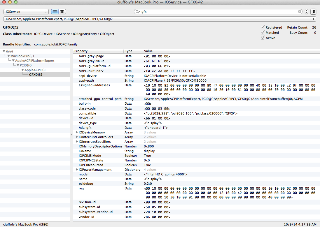

ciuffoly Posted October 8, 2014 Share Posted October 8, 2014 This evening I have test to patch AppleIntelFramebufferCapri.kext cp -pr AppleIntelFramebufferCapri.kext /Users/ciuffoly/Documents/. sudo perl -pi -e 's| \x00\x00\x00\x00\x00\x02\x05\x00\x00\x00\x04\x00\x00\x07\x01\x00\x00| \x00\x00\x00\x00\x00\x02\x05\x00\x00\x00\x08\x00\x00\x06\x00\x00\x00|g' /System/Library/Extensions/AppleIntelFramebufferCapri.kext/Contents/MacOS/AppleIntelFramebufferCapri sudo chown -R 0:0 /System/Library/Extensions/AppleIntelFramebufferCapri.kext sudo chmod -R 755 /System/Library/Extensions/AppleIntelFramebufferCapri.kext sudo touch /System/Library/Extensions DPCI Rebuild Cache but still no HDMI Audio Link to comment https://www.insanelymac.com/forum/topic/292999-mavericks-applehda-hdmi-audio/page/11/#findComment-2067562 Share on other sites More sharing options...

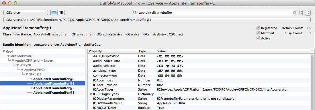

toleda Posted October 8, 2014 Author Share Posted October 8, 2014 but still no HDMI Audio Verify patch. Attach IOREG. Link to comment https://www.insanelymac.com/forum/topic/292999-mavericks-applehda-hdmi-audio/page/11/#findComment-2067568 Share on other sites More sharing options...

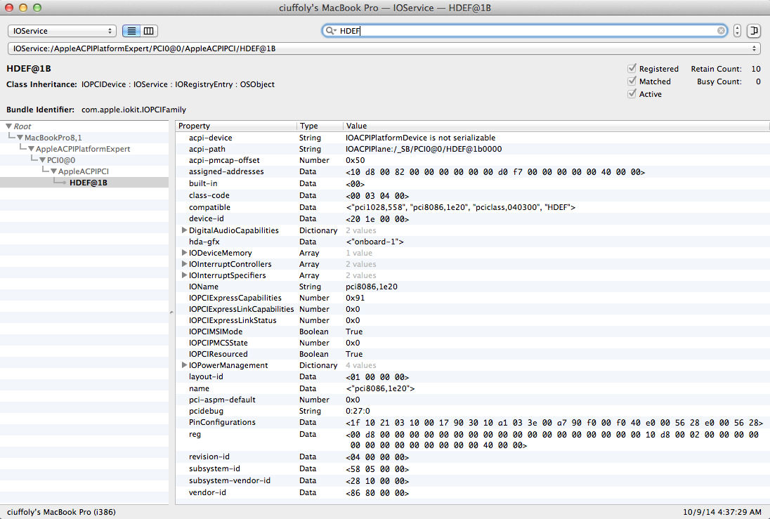

ciuffoly Posted October 9, 2014 Share Posted October 9, 2014 Sorry, but can you give me a more complete answer ? "Verify patch. Attach IOREG" what mean ? Troubleshooting 1. Verify if HDMI device is connected Application Utilities System Information see Graphics/Displays Television = Yes OK 2. Run IOReg or IOJones software to verify the devices HDEF and IGPU search HDEF (see attach) How to verify layout-id is 3 ? 3. Run IOReg or IOJones software search IGPU@2 or GFX0@2 verify AAPL,ig-platform-id = 0a 00 66 01 OK 4. Run IOReg or IOJones software search appleintelframebuffer verify connector-type is @0 = 02 00 00 00 or @1,@2 and @3 = 00 04 00 00 ? Link to comment https://www.insanelymac.com/forum/topic/292999-mavericks-applehda-hdmi-audio/page/11/#findComment-2067653 Share on other sites More sharing options...
toleda Posted October 9, 2014 Author Share Posted October 9, 2014 Sorry, but can you give me a more complete answer ? "Verify patch. Attach IOREG" what mean ? Xcode/IORegistryExplorer = 3rd party/IOJones. See post #1. Screenshots are not helpful. Attach IOJones. After any change, attach IOJones. Link to comment https://www.insanelymac.com/forum/topic/292999-mavericks-applehda-hdmi-audio/page/11/#findComment-2067660 Share on other sites More sharing options...
ciuffoly Posted October 9, 2014 Share Posted October 9, 2014 Probably the perl command does not work cd /Users/ciuffoly/Documents/AppleIntelFramebufferCapri.kext/Contents/MacOS grep -c "\x00\x00\x00\x00\x00\x02\x05\x00\x00\x00\x04\x00\x00\x07\x01\x00\x00" AppleIntelFramebufferCapri (original) 1 grep -c "\x00\x00\x00\x00\x00\x02\x05\x00\x00\x00\x08\x00\x00\x06\x00\x00\x00" /System/Library/Extensions/AppleIntelFramebufferCapri.kext/Contents/MacOS/AppleIntelFramebufferCapri (not modified) 0 grep -c "\x00\x00\x00\x00\x00\x02\x05\x00\x00\x00\x04\x00\x00\x07\x01\x00\x00" /System/Library/Extensions/AppleIntelFramebufferCapri.kext/Contents/MacOS/AppleIntelFramebufferCapri (like original) 1 Found the problem on perl command, there was a blank in my string copied, so I can test again perl -pi -e 's|\x00\x00\x00\x00\x00\x02\x05\x00\x00\x00\x04\x00\x00\x07\x01\x00\x00|\x00\x00\x00\x00\x00\x02\x05\x00\x00\x00\x08\x00\x00\x06\x00\x00\x00|g' AppleIntelFramebufferCapri grep -c "\x00\x00\x00\x00\x00\x02\x05\x00\x00\x00\x04\x00\x00\x07\x01\x00\x00" AppleIntelFramebufferCapri 0 grep -c "\x00\x00\x00\x00\x00\x02\x05\x00\x00\x00\x08\x00\x00\x06\x00\x00\x00" AppleIntelFramebufferCapri 1 Here the new file IOReg_after_LayoutID3_CapriPerlMod.zip Link to comment https://www.insanelymac.com/forum/topic/292999-mavericks-applehda-hdmi-audio/page/11/#findComment-2067661 Share on other sites More sharing options...
