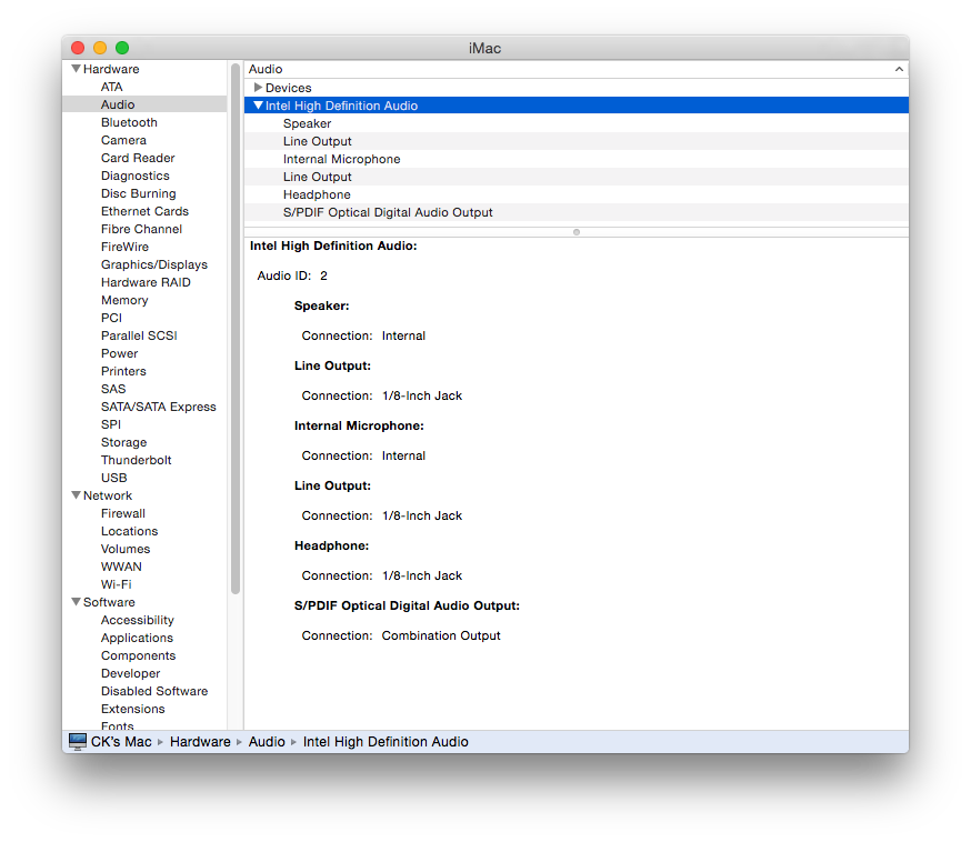

frm_bales Posted January 24, 2015 Share Posted January 24, 2015 Hi Toleda, I have been following all your. But stuck on not having HDMI Audio. Thanks to you, other Audio ports are functioning (including digital output). My Mackintosh is built on - Yosemite 10.10 / UFEI - Clover / AsRock H97m-ITX/ac / i7 4790s / HD4600 onboard / ALC892. I have followed your guides and have done the following: 1. audio_cloverALC-100_v1.0.4b (on board audio working) 2. Kext Binary Patching-config-hdmi_hd4600-100.plist 3. HDMI Audio ACPI Patching- ssdt injection I have attached all the information required for you to check my problem. Hope you can help me fix this. Thank you very much AppleHDA.kext.zip config.plist.zip debug.log.zip SSDT Files.zip Link to comment https://www.insanelymac.com/forum/topic/292999-mavericks-applehda-hdmi-audio/page/13/#findComment-2105234 Share on other sites More sharing options...
toleda Posted January 24, 2015 Author Share Posted January 24, 2015 stuck on not having HDMI Audio. Wrong thread. No IOReg attached. Problem: dsdt patch installed as kext patch Fix: Remove config.plist/KernelAndKextPatches/KextsToPatch/Item 4/Rename B0D3 to HDAU Add config.plist/ACPI/DSDT/Fixes/Rename B0D3 to HDAU (from config-hdmi-HD4600-100.plist) Reply with edited config.plist and new IOReg. 1 Link to comment https://www.insanelymac.com/forum/topic/292999-mavericks-applehda-hdmi-audio/page/13/#findComment-2105270 Share on other sites More sharing options...
frm_bales Posted January 24, 2015 Share Posted January 24, 2015 Toleda ... by following your suggestions I got the HDMI working. Thank you very much. Sorry I didn't know I was posting in the wrong thread. I have attached my new IOReg, just in case you need it for anything. Thank you very much again. Updated IOReg.zip Link to comment https://www.insanelymac.com/forum/topic/292999-mavericks-applehda-hdmi-audio/page/13/#findComment-2105328 Share on other sites More sharing options...

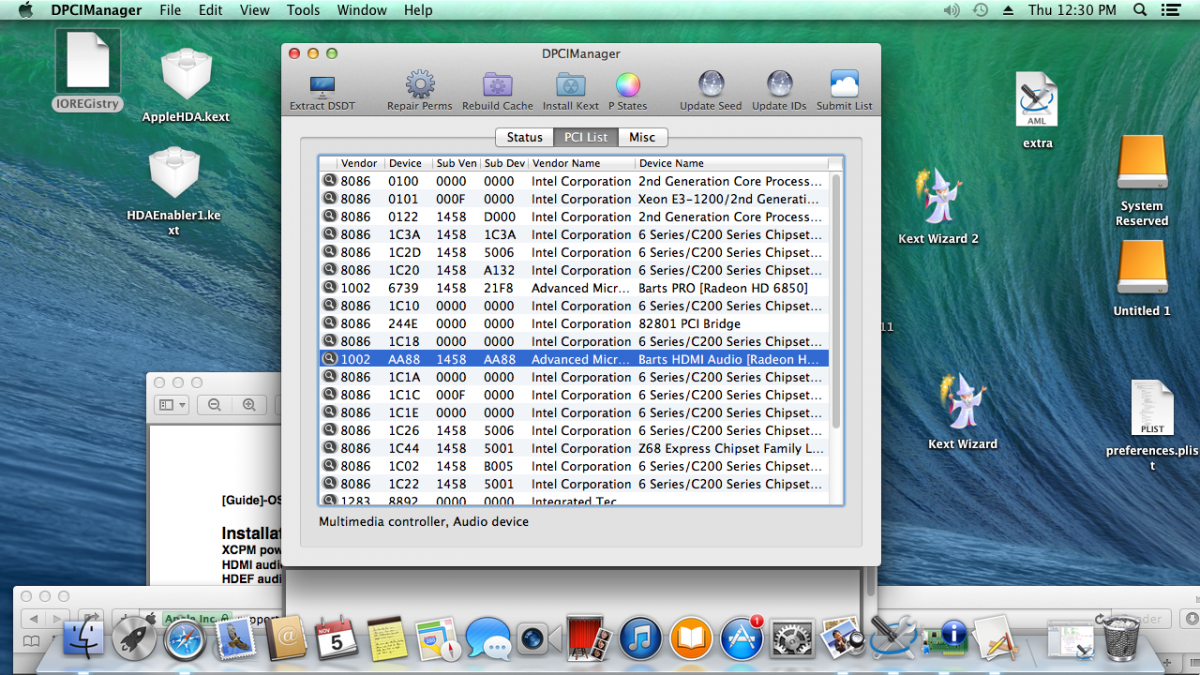

jgoens Posted November 5, 2015 Share Posted November 5, 2015 Hi Toleda, I recently installed Mavericks and do not have any sound via HDMI. HDMI is through my AMD 6800 card to a stereo receiver which works fine with Windows system. I am trying to follow the guide HD3000 as well as OSX ssd installation V3. I have award BIOS f12. I am pretty Noob. I downloaded MaciASL but am unsure of how to use it...I'm assuming that is how you patch? . In the extra folder there is not any ssdt or dsdt installed. I tried just copying the ssdt.ami to the extra folder and nothing happened. I've spent a lot of time trying to remedy the no sound via HDMI and all leads point to the method described here. IOREGistry.ziporg.chameleon.Boot.plist.zip]AppleHDA.kext.zip Link to comment https://www.insanelymac.com/forum/topic/292999-mavericks-applehda-hdmi-audio/page/13/#findComment-2185789 Share on other sites More sharing options...
toleda Posted November 6, 2015 Author Share Posted November 6, 2015 In the extra folder there is not any ssdt or dsdt installed. I tried just copying the ssdt.ami to the extra folder and nothing happened. I've spent a lot of time trying to remedy the no sound via HDMI and all leads point to the method described here. Nothing shows in IOReg. See Post #1, Problem Reporting. Attach all requested files. Link to comment https://www.insanelymac.com/forum/topic/292999-mavericks-applehda-hdmi-audio/page/13/#findComment-2185874 Share on other sites More sharing options...

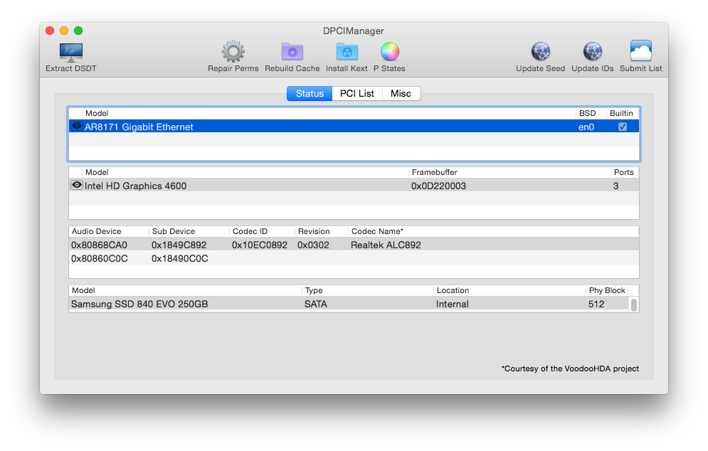

jgoens Posted November 7, 2015 Share Posted November 7, 2015 DPCIboot log.rtf I'm kind of struggling trying to figure out how to save the boot log from DPCImanager. I did a copy and paste of it. I never installed ssdt or dsdt. IOReg/IOJones is not the problem. The other requested files are missing. Attach all Problem Reporting files. Link to comment https://www.insanelymac.com/forum/topic/292999-mavericks-applehda-hdmi-audio/page/13/#findComment-2186388 Share on other sites More sharing options...
toleda Posted November 8, 2015 Author Share Posted November 8, 2015 I'm kind of struggling trying to figure out how to save the boot log from DPCImanager. I did a copy and paste of it. I never installed ssdt or dsdt. Not helpful. All the requested files in one post. Try again. Link to comment https://www.insanelymac.com/forum/topic/292999-mavericks-applehda-hdmi-audio/page/13/#findComment-2186819 Share on other sites More sharing options...

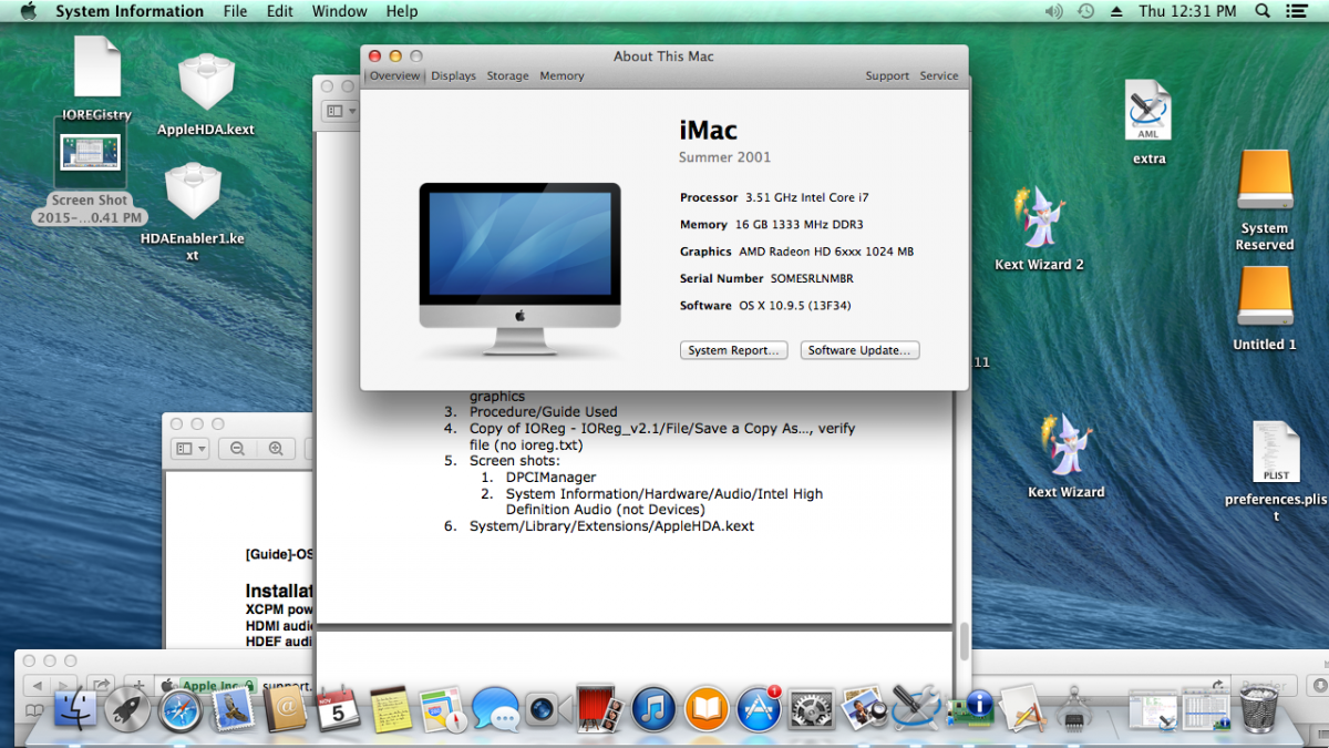

jgoens Posted November 9, 2015 Share Posted November 9, 2015 Jgoens requested files.zip Not helpful. All the requested files in one post. Try again. Hi Toleda, I recently installed Mavericks and do not have any sound via HDMI. HDMI is through my AMD 6800 card to a stereo receiver which works fine with Windows system. I am trying to follow the guide HD3000 as well as OSX ssd installation V3. I have award BIOS f12. I am pretty Noob. I downloaded MaciASL but am unsure of how to use it...I'm assuming that is how you patch? . In the extra folder there is not any ssdt or dsdt installed. I tried just copying the ssdt.ami to the extra folder and nothing happened. I've spent a lot of time trying to remedy the no sound via HDMI and all leads point to the method described here. Link to comment https://www.insanelymac.com/forum/topic/292999-mavericks-applehda-hdmi-audio/page/13/#findComment-2186845 Share on other sites More sharing options...
toleda Posted November 9, 2015 Author Share Posted November 9, 2015 I recently installed Mavericks and do not have any sound via HDMI HDMI audio is not native in OS X. See Post #1, edit the dsdt or install a ssdt. Download the guide for the selected method and install. Link to comment https://www.insanelymac.com/forum/topic/292999-mavericks-applehda-hdmi-audio/page/13/#findComment-2187125 Share on other sites More sharing options...
