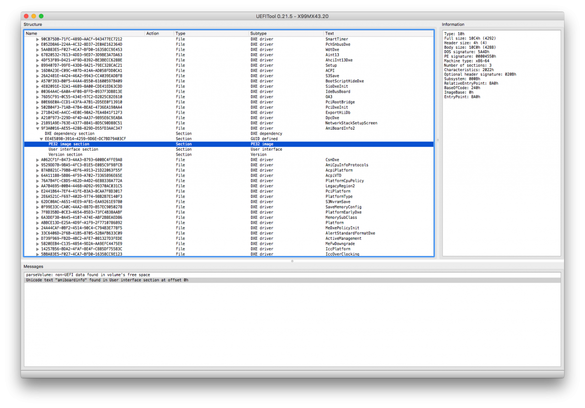

AmiBoardInfo search with UEFITool.
later extrach PE32 body like a bin. Use drag and drop bin file on DSDT2bios and u have DSDT-Original.aml

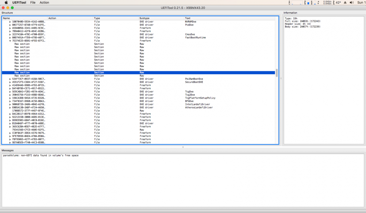

No not, since x99, x100 series Board, they are only in FreeForm modules. Here's how:
Select that raw as in the png above, and choose Extract Body then all files and name it xxxx.aml
Or here's the extracted one from the 3.20 ROM: DSDT.aml.zip, you can try Ozmosis at your own risk, the ROM is not protected, just add the Ozmosis stuffs.
Or here's the extracted one from the 3.20 ROM: attachicon.gifDSDT.aml.zip, you can try Ozmosis at your own risk, the ROM is not protected, just add the Ozmosis stuffs.

This is what I use for everyboard I have!
Follow the first post assuming that it's a FredWst screenshots, and extract your CPUPm ssd from ROM, general it's DSL with IASL and inject DTGP and add this plugin _DSM to the Scope CPU0 without OSDW, save it as SSDT-1.aml and it's done.
The OzmosisDefaults I posted is yours I just removed unused things!
Thanks, a did the same in the past but there was a problem a couldn't save dsdt because of unrecognized and not existing external devices or hardware names which doesn't exist in dsdt. Can you help me if I send you the dsdt and ssdts which I need? Can you pack it in dsdt for me?
No, i mean, you can use SSDT for injecting devices with _DSM for each one, or directly do the patch's on the DSDT!
