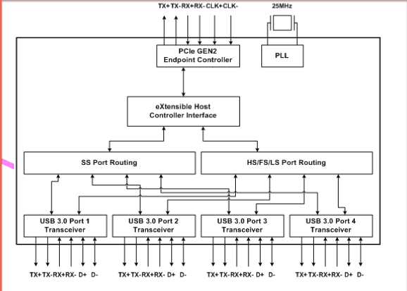

Slice Posted September 24, 2013 Share Posted September 24, 2013 Is there anybody has a proposition why XHCI should work with 5 ports while the chip contains only 4? 6:545 0:028 XhcGetCapability: 5 ports, 64 bit capable=1 6:677 0:131 XhcUsbPortReset! 6:715 0:038 XhcSetRootHubPortFeature: status Success 6:799 0:084 XhcClearRootHubPortFeature for port 0 Feature=4: status Success 6:957 0:157 XhcClearRootHubPortFeature for port 0 Feature=10: status Success 6:983 0:026 XhcClearRootHubPortFeature for port 0 Feature=14: status Success 7:139 0:155 XhcUsbPortReset! 7:169 0:029 XhcSetRootHubPortFeature: status Success 7:251 0:082 XhcClearRootHubPortFeature for port 4 Feature=4: status Success 7:306 0:054 XhcClearRootHubPortFeature for port 4 Feature=10: status Success 1 Link to comment https://www.insanelymac.com/forum/topic/291270-iousbfamily-1084-sliceanv-with-full-appleusbxhci-support-for-any-usb3-chip-v12/page/3/#findComment-1948217 Share on other sites More sharing options...
Andy Vandijck Posted September 24, 2013 Author Share Posted September 24, 2013 Is there anybody has a proposition why XHCI should work with 5 ports while the chip contains only 4? 6:545 0:028 XhcGetCapability: 5 ports, 64 bit capable=1 6:677 0:131 XhcUsbPortReset! 6:715 0:038 XhcSetRootHubPortFeature: status Success 6:799 0:084 XhcClearRootHubPortFeature for port 0 Feature=4: status Success 6:957 0:157 XhcClearRootHubPortFeature for port 0 Feature=10: status Success 6:983 0:026 XhcClearRootHubPortFeature for port 0 Feature=14: status Success 7:139 0:155 XhcUsbPortReset! 7:169 0:029 XhcSetRootHubPortFeature: status Success 7:251 0:082 XhcClearRootHubPortFeature for port 4 Feature=4: status Success 7:306 0:054 XhcClearRootHubPortFeature for port 4 Feature=10: status Success It's possible the chip has internal support for up to 5 ports but only has 4 physical connections.Just a thought... :-) Link to comment https://www.insanelymac.com/forum/topic/291270-iousbfamily-1084-sliceanv-with-full-appleusbxhci-support-for-any-usb3-chip-v12/page/3/#findComment-1948229 Share on other sites More sharing options...
Slice Posted September 24, 2013 Share Posted September 24, 2013 It's possible the chip has internal support for up to 5 ports but only has 4 physical connections. Just a thought... :-) No, it internally has exactly 4 ports. http://www.via-labs.com/en/products/vl800/ When I set manually _rootHubNumPorts = 4 the driver stop working ! Link to comment https://www.insanelymac.com/forum/topic/291270-iousbfamily-1084-sliceanv-with-full-appleusbxhci-support-for-any-usb3-chip-v12/page/3/#findComment-1948248 Share on other sites More sharing options...
Andy Vandijck Posted September 24, 2013 Author Share Posted September 24, 2013 No, it internally has exactly 4 ports. http://www.via-labs.com/en/products/vl800/ When I set manually _rootHubNumPorts = 4 the driver stop working ! Odd... I also have no idea why it stops working. Probably something in the code then (the way it simply works) Link to comment https://www.insanelymac.com/forum/topic/291270-iousbfamily-1084-sliceanv-with-full-appleusbxhci-support-for-any-usb3-chip-v12/page/3/#findComment-1948251 Share on other sites More sharing options...
Slice Posted September 24, 2013 Share Posted September 24, 2013 I think it is bug-in-law. Link to comment https://www.insanelymac.com/forum/topic/291270-iousbfamily-1084-sliceanv-with-full-appleusbxhci-support-for-any-usb3-chip-v12/page/3/#findComment-1948288 Share on other sites More sharing options...
Zenith432 Posted September 26, 2013 Share Posted September 26, 2013 Are you sure it's not a bug in software? If the chip actually reports 5 root hub ports - well, the USB3 spec says that each superspeed port must have a companion USB2.0 port along with it (in other words the connector must have dual USB3-USB2 wires.) It is not allowed to have a superspeed-only connector. However, the xHC may also support any number of USB 2.0-only ports that have no companion superspeed port. So the total number of ports is 2*x + y, where x = dual-protocol ports y = USB2.0 only ports. One possible use for USB 2.0-only port is a debug port. I suggest you dump xHCI Extended Capabilities for the chip to study its port layout. Especially xHCI Supported Protocol Cap and xHCI Debug Cap. You can do this with 'xhcdump caps' if you install GenericUSBXHCI to drive it. However, it won't give you detailed dump of the Debug Cap - as it's not used. Is there anybody has a proposition why XHCI should work with 5 ports while the chip contains only 4? Link to comment https://www.insanelymac.com/forum/topic/291270-iousbfamily-1084-sliceanv-with-full-appleusbxhci-support-for-any-usb3-chip-v12/page/3/#findComment-1948841 Share on other sites More sharing options...
genzai Posted September 27, 2013 Share Posted September 27, 2013 I posted this help request to Zenith's genericUSBXHCI thread as well but maybe it is more appropriate to seek help here. I have a new system in that is based on a jetway Q77 board for pro tools. I have tried many things to get the USB 3.0 ports working properly with the applexhci drivers but the system just locks up as soon as I insert a drive or device. I have tried the various BIOS options for Auto/Smart Auto etc. There is no handoff option in BIOS for XHCI (only EHCI which is enabled). Now if I install Zenith's GenericUSBXHCI driver it DOES mostly work, disks mount on the USB 3.0 bus and no system freeze which is awesome, but i normally prefer to use the apple drivers for the intel controller and the generic for third party controllers through an ioprobe edit (i have both controller types on most of my systems). Though compatibility issues have been shrinking i still find the apple drivers tend to work with more devices on the intel controllers. And on occasion with generic driver installed it seems like the ports stop working or wont work with USB 2.0 devices. In any case my primary goal is to get the intel ports working with the apple driver on this board if thats possible. I am attaching the original unmodified DSDT extracted with maciasl as well as my latest modified one which includes the DSDT edits (i think originally developed by mieze) that have worked to make the intel ports fully functional on other boards. Please let me know if there is any other info i can provide to help figure this out! Thanks, g\ NAF93.zip Link to comment https://www.insanelymac.com/forum/topic/291270-iousbfamily-1084-sliceanv-with-full-appleusbxhci-support-for-any-usb3-chip-v12/page/3/#findComment-1948947 Share on other sites More sharing options...
Slice Posted September 27, 2013 Share Posted September 27, 2013 Are you sure it's not a bug in software? If the chip actually reports 5 root hub ports - well, the USB3 spec says that each superspeed port must have a companion USB2.0 port along with it (in other words the connector must have dual USB3-USB2 wires.) It is not allowed to have a superspeed-only connector. However, the xHC may also support any number of USB 2.0-only ports that have no companion superspeed port. So the total number of ports is 2*x + y, where x = dual-protocol ports y = USB2.0 only ports. One possible use for USB 2.0-only port is a debug port. I suggest you dump xHCI Extended Capabilities for the chip to study its port layout. Especially xHCI Supported Protocol Cap and xHCI Debug Cap. You can do this with 'xhcdump caps' if you install GenericUSBXHCI to drive it. However, it won't give you detailed dump of the Debug Cap - as it's not used. I will make dump little later. But I already know port layout I am thinking that there is possible bug in the software with cycles as for(i=0; i because I have only 4 port. But for now the driver works fine. Link to comment https://www.insanelymac.com/forum/topic/291270-iousbfamily-1084-sliceanv-with-full-appleusbxhci-support-for-any-usb3-chip-v12/page/3/#findComment-1949019 Share on other sites More sharing options...
Zenith432 Posted September 27, 2013 Share Posted September 27, 2013 Actually, 'for(i=0; i<_rootHubNumPorts; ++i)' is not a bug, because in the port register set array, ports are indexed from zero to _rootHubNumPorts - 1, but everywhere else in IOUSBFamily, ports are numbered based at 1. for(i=0; i<portNumber; i++) Link to comment https://www.insanelymac.com/forum/topic/291270-iousbfamily-1084-sliceanv-with-full-appleusbxhci-support-for-any-usb3-chip-v12/page/3/#findComment-1949023 Share on other sites More sharing options...
Slice Posted September 27, 2013 Share Posted September 27, 2013 Actually, 'for(i=0; i<_roothubnumports is not a bug because in the port register set array ports are indexed from zero to _roothubnumports but everywhere else iousbfamily numbered based at> In this case i=0 will be wrong. Or it may be controller itself. Link to comment https://www.insanelymac.com/forum/topic/291270-iousbfamily-1084-sliceanv-with-full-appleusbxhci-support-for-any-usb3-chip-v12/page/3/#findComment-1949034 Share on other sites More sharing options...
