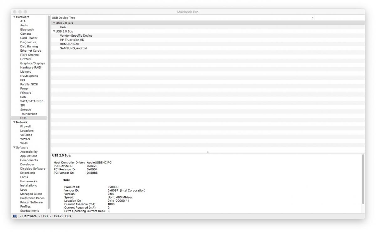

I'm not going to pretend I understood everything you said, I'll probably need to reread your explanation multiple time :P
but here is the ioreg with both of them installed (with the new port injector):
the webcam isn't getting detected and devices are being listed under usb 2.0 in System report
https://www.dropbox.com/s/guoeccfigz0n42f/with%20both%20Kexts.zip?dl=0

OK, I note you're not using my DSDT/config.plist setup (my repo doesn't inject AAPL,clock-id from either on XHC)...
But it probably doesn't matter...
It could be that your webcam cannot be routed from XHC to EHC. It is on port 7. We can override what XHCMux does with that port.
# Insert Apple USB properties into USB 3.0 XHC
into method label _DSM parent_adr 0x00140000 remove_entry;
into device name_adr 0x00140000 insert
begin
Method (_DSM, 4, NotSerialized)\n
{\n
    If (LEqual (Arg2, Zero)) { Return (Buffer() { 0x03 } ) }\n
    Return (Package()\n
    {\n
"RM,pr2-force", Buffer() { 0x40, 0, 0, 0, },\n
        "subsystem-id", Buffer() { 0x70, 0x72, 0x00, 0x00 },\n
        "subsystem-vendor-id", Buffer() { 0x86, 0x80, 0x00, 0x00 },\n
        "AAPL,current-available", 2100,\n
        "AAPL,current-extra", 2200,\n
        "AAPL,current-extra-in-sleep", 1600,\n
        "AAPL,device-internal", 0x02,\n
        "AAPL,max-port-current-in-sleep", 2100,\n
    })\n
}\n
end;
That should keep port 7 USB2 on XHC (bit 6 corresponds to port 7) and route the rest to EHC1.
(I indented it funky just so you can see the additional property).
You can keep XHCMux from routing any other port in the same way... (just set the bit to 1 corresponding to the port in the 32-bit buffer).
Normally, the BIOS should set PR2M such that software knows not to route this port, but it obviously isn't doing that.
Unless something else is going on.
If the problem happens with other devices/ports, then I'm not sure about this... I haven't run into a computer yet where XHCMux messes up all the ports. It is working flawlessly on three different computers I have here.

This is what the USB looks like with the port injector and no Mux and with no port injector and no Mux. I wonder if the port injector is applying correctly. When I do apply the injector, it doesn't show as Loaded in extensions.
At least on my j-070 Envy only has one SS port. I think the main issue is these Envy computers only have physical USB 3.0 ports and no USB 2.0.

OK, managed to compare your ACPI files in ACPI/patched against those that I created myself by patching the ones you have in ACPI/origin. And they have the correct patches from my script (so that much is good). It was a bit tricky to compare as you didn't use my install script ('make install') so they don't have the expected names. But they still appear to load in the correct order and are identically patched...
Please post ioreg without FakePCIID_XHCIMux.kext installed (all other things same). I need to know where the camera is connecting on XHC.
Yes sir :D
Here is the ioreg without the HXCIMux Kext
https://www.dropbox.com/s/srqwza8r4p8k8hv/without%20the%20Kext.zip?dl=0
(you can't believe how happy i was to finally get a dsdt error free)
