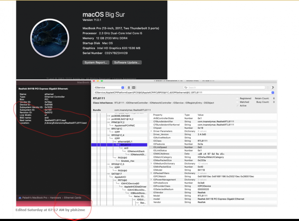

image.thumb.png.60aa103c132f25ebda04a21ae682ff1a.png@Fake Questioner
Fake Question
Can you read this, may be i could lend you my old man's eye Glass. (hehehe, I bet,  you don't know what I mean. UNSAFE, ROTFL)
One More Joke,  this is HACKINTOSH, hahahaha, unsafe, get out here, hahahahaha.
Why is it there? I know why, Mieze's Cat, bad cat, she put it there /Library/Extension, while you were asleep.
But, seriously, if you were not the one, who put it there.....
Then, my guess, you used IMAGE install from some site,  install the Big Sur Image, and install OpenCore  loader afterward,
THAT IS Really, Really, Really, "UNSAFE".
If the above "Guess" were correct, then i will withdraw my "FAKE" thing, and i am sorry.
Rebuild the KextCache, may fix this.
If you copy other's EFI, redo the EFI yourself,

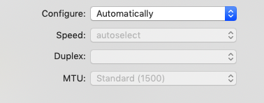

@Mieze Hi! Please, take a look more deep at Medium section because of... it still have problems with detecting 1000/100/10 MBps. The last 2.3.0d7 works perf and then all goes so bad.
Though 2.4.0d5 has problems with AppStore and other connections.
You have to check not only 1000 MBps but the other speed.
PS. I have 100 MBps connection from my router and 1000 from provider.
100 and 10 MBps has to be autodetected; but cannot, so have no connection. 1000 MBps is working OOB (2.3.0)

@Moorre With regard to medium selection, there is no difference between 2.3.x and 2.4.x. The only difference is jumbo frame support which has been added with 2.4.0d0. Medium selection is a process which occurs before a link is established. If medium selection was the problem, you would never get a link up event but as you are noticing problem accessing the App Store a medium selection issue can be ruled out. Your problem description sounds more like a problem with jumbo frames which only work reliable when ALL devices in your network support them and it looks like your router doesn't. You'll have to disable jumbo frames in order to make it work.
Mieze :cat:
@Mieze Ooooops! You still cannot understand the issue. 2.3.0d7 is the last version which can do automatic medium selection. It means that I can use my Ethernet card OOB even in the installer where I cannot do manual selection of what link speed to use now. 2.3.0d10 and higher still cannot do this selection automatically and OOB selects 1000MBps which unusable with my router that can do only 100MBps. If I select the speed manually in the PrefPane to 100MBps then 2.3.0 is working ok. 2.4.0d5 has the same problem with autoselection but additional it has AppStore problem (maybe other things that users reported before: when unable to open router's WEB interface).
@Moorre I understand your problem very well but it looks like you don't understand that it's not the driver which is responsible for this trouble but your router.
First of all, if users are reporting connection problems, it's their fault not the driver's because they don't know what they are doing. Jumbo frames only work when all devices in the network support them as devices which lack support for jumbo frames will see them as broken frames and so that they get dropped which results in connection problems. If users enable jumbo frames without having checked their devices, the problem is clearly located in front of the computer. Frankly, that's the reason why I refused to add jumbo frame support to the driver for several years because I know what would happen.
Second, in 2.3.0d10 I reworked medium selection because there was a problem with medium selection in earlier versions which limited some gigabit devices to 100 MBit speed. The changes resolved this issue but as a negative side effect auto-connection fails with some broken 100 MBit devices. This problem can be easily avoided with manual medium selection. That's a tradeoff and I think it's the better alternative, in particular as the root of the problem is located in the router advertising support for gigabit connections although it doesn't support them.
Third, manual medium selection with the installer can be done with ifconfig in Terminal. A user posted this solution here is in thread a long time ago.

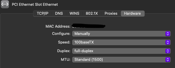

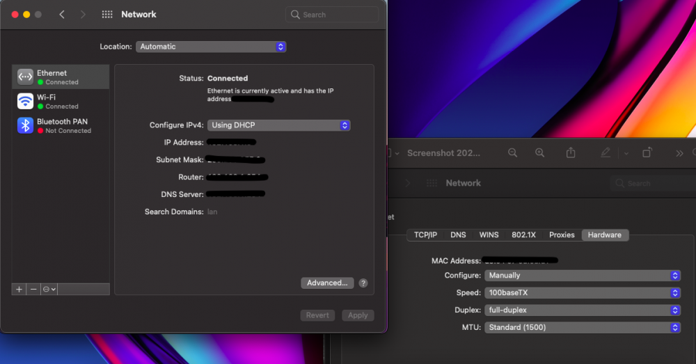

Previously I complained that the version 2.4.0d5 not working (can not connect to network) on Big Sur. Actually if I select manually it works.
I didn't check other version, may be I'm having the same problem like Moorre.

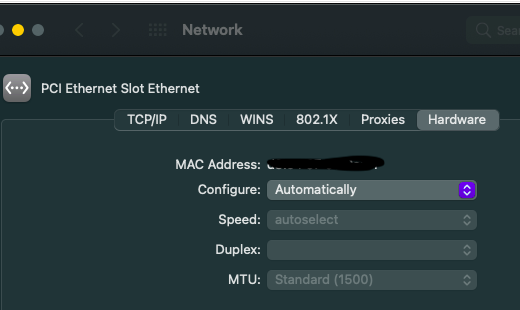

@Mieze if you meant by saying trouble with auto-negotiation=setting medium manually, nothing changed for 8111G(chipset 20), still need it(got used to it).  If I misunderstood, please ignore my post. Version 2.4.0d8 works flawlessly btw.
Thanks!
Edited by hardcorehenry
  • Thanks 1
@hardcorehenry Thank you for the test result. Well, I revised the code for medium selection comparing it with the corresponding code of the underlying Linux driver and changed a few details. If this doesn't resolve the issue, it's most likely a firmware related problem which needs to be fixed by Realtek (I hopse so!) as this is beyond my possibilities.
Mieze :cat:

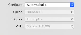

Thanks for the new dev kext.:thumbsup_anim:
Tested with Firefox 85.0.2 under 11.2.1
Auto works, although the panel says it's full-duplex only, but I guess when one uses auto, he/she wouldn't mind flow-control or EEE. :lol:

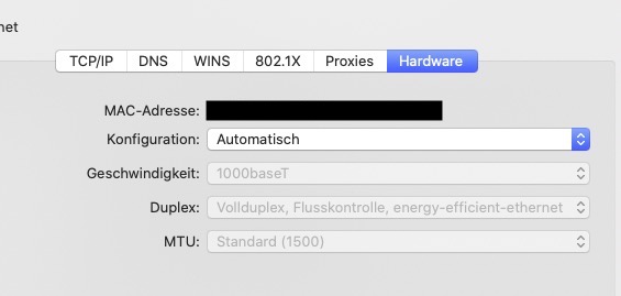

Hi, i am looking from time to time to this thread - for interest.
My Asus H270 Plus MB uses   REaltek Geräte-ID:    0x8168,   Subsystem-Hersteller-ID:    0x1043,   Subsystem-ID:    0x8677.
I can report that Version 2.22 of Mieze Driver working automatic Full duplex. Never must enable manual.
Now i switched to newest 2.4.0d8 Version - NO PROBS with automatic Full version. Stays automatic with Full Duplex as with Version 2.22.
The only thing i can see in diff to Version 2.2.2, is that some more text (after Fullduplex) was added in the Speed preference (gray, because i let it automatic).... Flowcontrol, energy-efficient-ethernet. With Version 2.22 there was only Fullduplex as tet.
Great Work MIeze!
