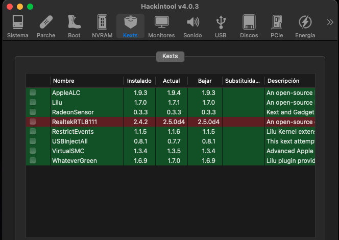

kaoskinkae Posted February 11, 2025 Share Posted February 11, 2025 I have tested both my devices on the New one: perfect but on the Old one: no network connection, see the device specifications below. Also in my Spanish groups I have been told about signal loss or delay in the internet connection. Link to comment https://www.insanelymac.com/forum/topic/287161-new-driver-for-realtek-rtl8111/page/65/#findComment-2830363 Share on other sites More sharing options...
Mieze Posted February 11, 2025 Author Share Posted February 11, 2025 @kaoskinkae Well, the driver now is compatible with AppleVTD but this doesn't mean that the mainboard also is. On some boards enabling AppleVTD causes network drivers so cycle up and down, work very slow or the system might even become unstable and produce KPs or simply reboot unexpected. Sometimes patching the DMAR helps to solve this problem, Basically, it boils down to the fact that this is not a driver issue and there is nothing which can be done to solve this problem inside the driver. If your mainboard isn't compatible with AppleVTD, the only way to get a stable system is to disable it in UEFI setup or OC. My Gigabyte Z490 Gaming X is one of these boards. While AppleVTD is enabled, all network drivers including the ones provided by Apple keep cycling up and down, or work very slow. Under load, the system might reboot suddenly. In case you are affected, trying to patch your DMAR might help, but there is no guarantee that this solves the problem. 1 Link to comment https://www.insanelymac.com/forum/topic/287161-new-driver-for-realtek-rtl8111/page/65/#findComment-2830365 Share on other sites More sharing options...

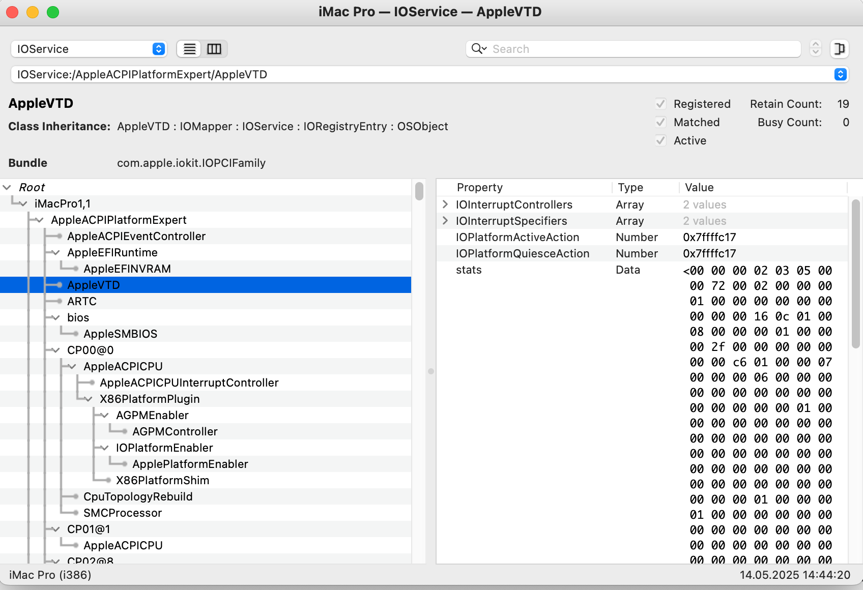

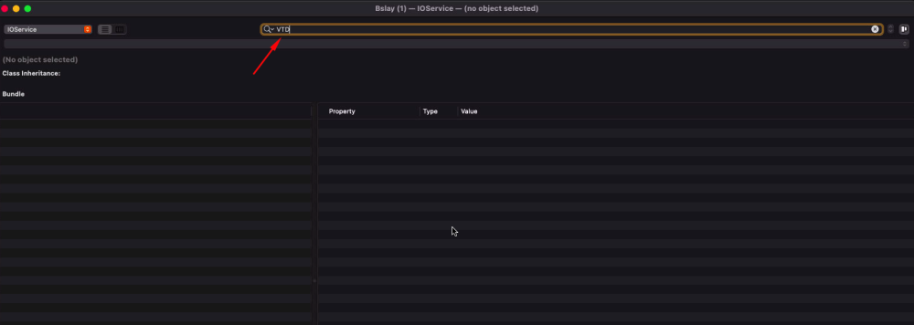

daemon17 Posted February 15, 2025 Share Posted February 15, 2025 (edited) 10 hours ago, Mieze said: and have to disable VT-d in UEFI or use DisableIOMapper in OC. I disabled AppleVTD, it is not in ioreg (see screenshot). But it still does not work. The new driver does not work with AppleVTD enabled and also does not work with AppleVT-d disabled. What is the point of this driver? It supports AppleVTD but does not work with AppleVTD enabled or disabled. This driver needs a working AppleVTD. That is, it needs real Apple hardware. Did I understand you correctly? Edited February 15, 2025 by daemon17 Link to comment https://www.insanelymac.com/forum/topic/287161-new-driver-for-realtek-rtl8111/page/65/#findComment-2830428 Share on other sites More sharing options...

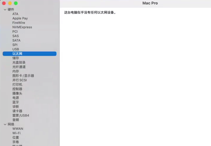

ZHIDR MI Posted May 14, 2025 Share Posted May 14, 2025 I used this driver, but macos does not recognize RTL8168. I can't figure out what the problem is. Please help. Mac Pro (13950hx).ioreg Link to comment https://www.insanelymac.com/forum/topic/287161-new-driver-for-realtek-rtl8111/page/65/#findComment-2832277 Share on other sites More sharing options...
Mieze Posted May 14, 2025 Author Share Posted May 14, 2025 @ZHDI You are using an old version of the driver which is incompatible with AppleVTD. Upgrade to the latest version and let's see if it helps. Link to comment https://www.insanelymac.com/forum/topic/287161-new-driver-for-realtek-rtl8111/page/65/#findComment-2832281 Share on other sites More sharing options...
