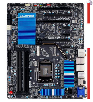

Ira Aduro Posted March 15, 2013 Author Share Posted March 15, 2013 I rejected that one at the time as it would need too much finishing by hand around the cut out areas to make a smooth look If the pattern is close but not an exact fit how would you go about making it blend with the original parts of the back? I'm attaching an image to this post which shows why I'm designing the backplate how I am. I have a UD5h motherboard and my power supply is mounted where the HDDs were. Because of this the motherboard sits lower than mods that place the PSU in the original PSU enclosure. I've marked the two areas where the IO ports would be and the three PCI slots that match up with the bottom three expansion slots of the G5. In the end I plan on making a few variants of this and one would conform to ATX standards for those that want to place the PSU on the bottom. Link to comment https://www.insanelymac.com/forum/topic/286161-g5-legacy/page/4/#findComment-1896893 Share on other sites More sharing options...

MiniHack Posted March 15, 2013 Share Posted March 15, 2013 [/size][/font][/color] If the pattern is close but not an exact fit how would you go about making it blend with the original parts of the back? I'm attaching an image to this post which shows why I'm designing the backplate how I am. I have a UD5h motherboard and my power supply is mounted where the HDDs were. Because of this the motherboard sits lower than mods that place the PSU in the original PSU enclosure. I've marked the two areas where the IO ports would be and the three PCI slots that match up with the bottom three expansion slots of the G5. In the end I plan on making a few variants of this and one would conform to ATX standards for those that want to place the PSU on the bottom. Okay, that sort of explains it. Sorry if you said that somewhere else but I didn't see it. I get it now, you want the top 4 of the seven PCI slots to be used and are happy to keep the bottom 3 not externally accessible. I have my first production batch of low sitting aluminium ATX backplates arriving at The Laser Hive next week for the full ATX low solution. Still though obviously avoiding too many small holes cose together because of the 'warp' factor (nowt to do with Star Trek ). These though will only be available in the 120 style as bringing the lower three slots down the case means not enough room for the dual 92s to sit on the flat area of the panel. And yes for new backplate made from a 'close' but not identical hole pattern you need either to make the panel full height/width or have a replacement patch that has a nice horizontal crisp dividing line at the point where the original G5 holes and the new ones meet - make a small styling feature of it. 1 Link to comment https://www.insanelymac.com/forum/topic/286161-g5-legacy/page/4/#findComment-1897022 Share on other sites More sharing options...
