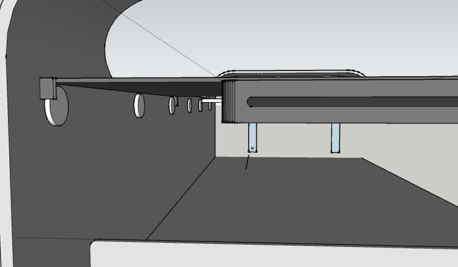

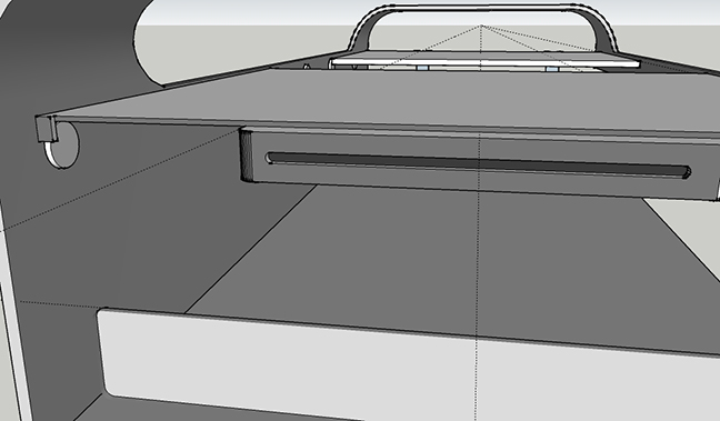

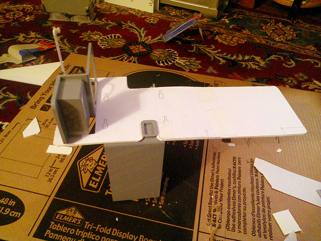

Ira Aduro Posted February 12, 2013 Author Share Posted February 12, 2013 Another small update, finalized idea for slot dvd holder. Using similar technique to what I'll be doing for the PSU. I'm using the bolts along the top of the case insides to support the holder which is basically just a piece of aluminum the DVD attaches to most likely via strong two sided tape as the DVD is extremely light. I can always add better support later if needed. Crude sketchups attached. 2 Link to comment https://www.insanelymac.com/forum/topic/286161-g5-legacy/page/2/#findComment-1888282 Share on other sites More sharing options...

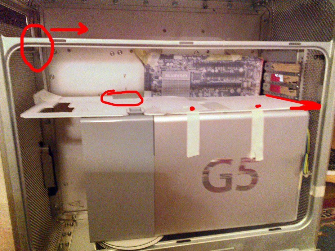

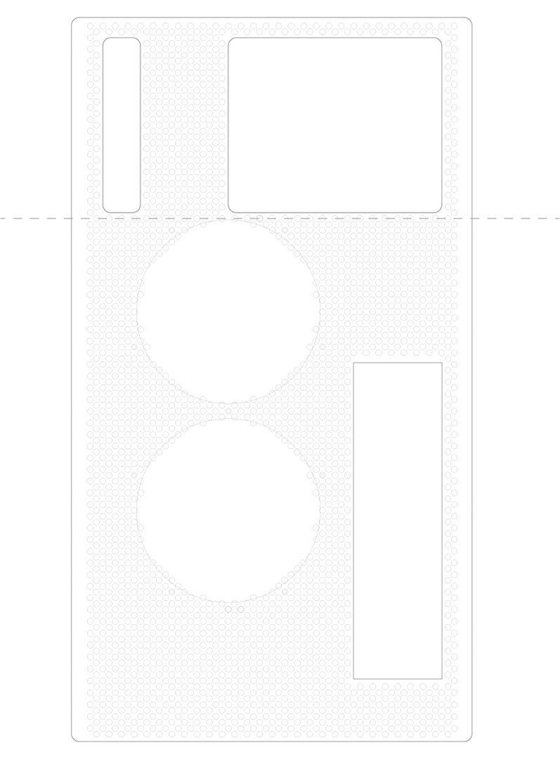

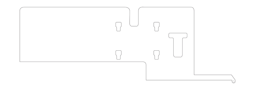

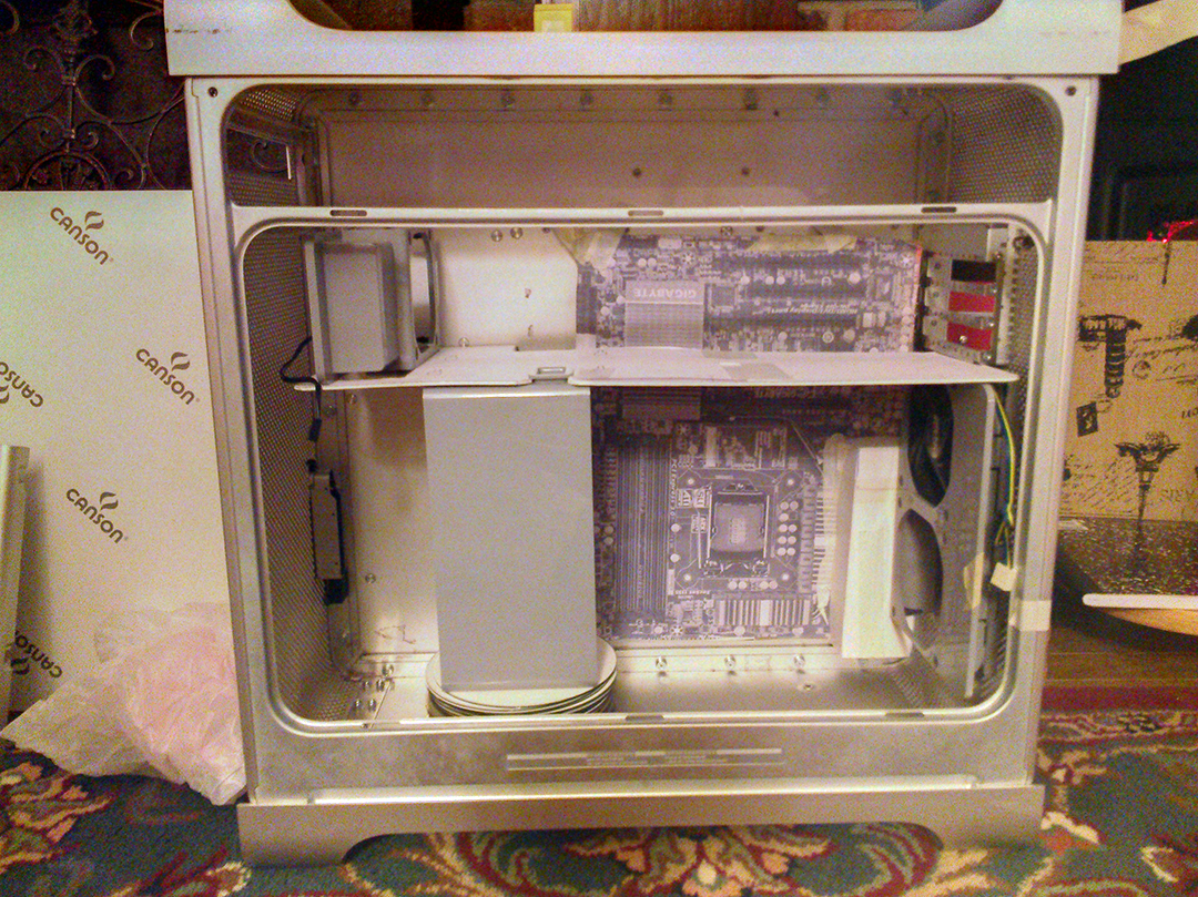

Ira Aduro Posted February 14, 2013 Author Share Posted February 14, 2013 Gentlemen. This is a wonderful development. So, I took the template Sheriff made and tweaked it to fit the way I want my UD5H motherboard to fit in the G5. The dashed horizontal line is where I plan on cutting the case and the template so I don't have to mess with the PCIE slots and locking mechanism. But the general idea is you can use this template to cut out a new backplate that perfectly matches the holes of the original G5 while giving you an ATX compliant rear IO area. The original fans have been moved closer to the far side so if you want to use the original CPU shield you'll need to modify the plastic fan holder, but that should be fairly straight forward. This is a rough sketch in that I don't know 100% sure the rear IO area should start where it does. It's hard to measure accurately with the ruler I have since I have to bend it while it is in the case. I'll print this out soon and see how it fits. Hopefully once I'm 99% sure the measurements are dead on I can find someone local to cut this out since I'll probably take a few revisions to get ti 100% right. Link to comment https://www.insanelymac.com/forum/topic/286161-g5-legacy/page/2/#findComment-1888758 Share on other sites More sharing options...

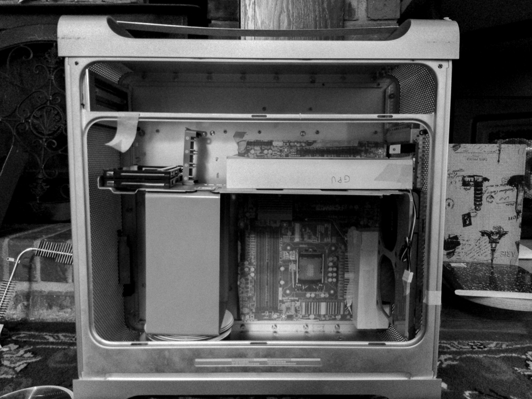

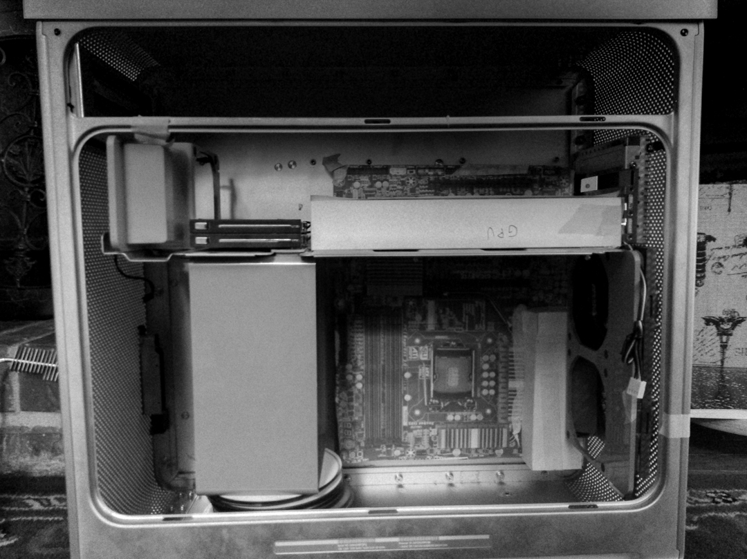

Ira Aduro Posted February 14, 2013 Author Share Posted February 14, 2013 Looks like the holes didn't show up in that attachment, I'll put a better version up later. In the meantime, started work on a modified version of the middle divider, keeping place for CPU front fans and adding places for a slide in HDD rack. Keeping the same armature that bends up and attaches to the case wall. Link to comment https://www.insanelymac.com/forum/topic/286161-g5-legacy/page/2/#findComment-1888949 Share on other sites More sharing options...

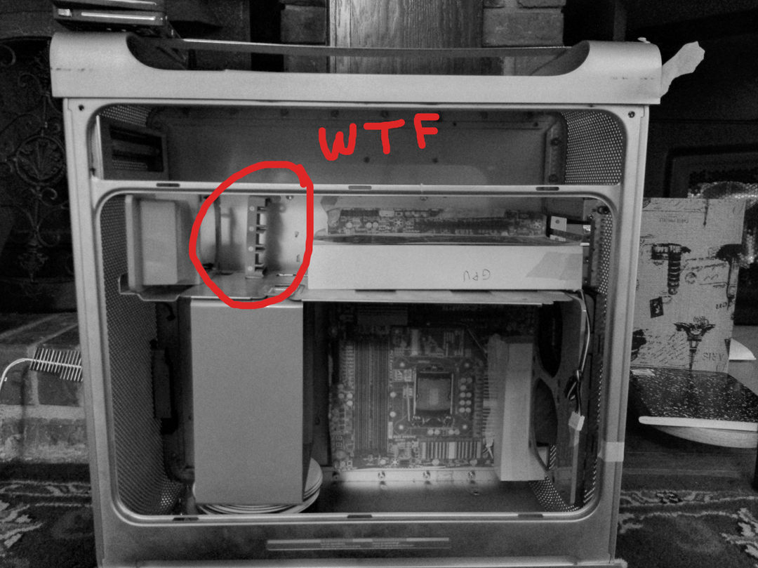

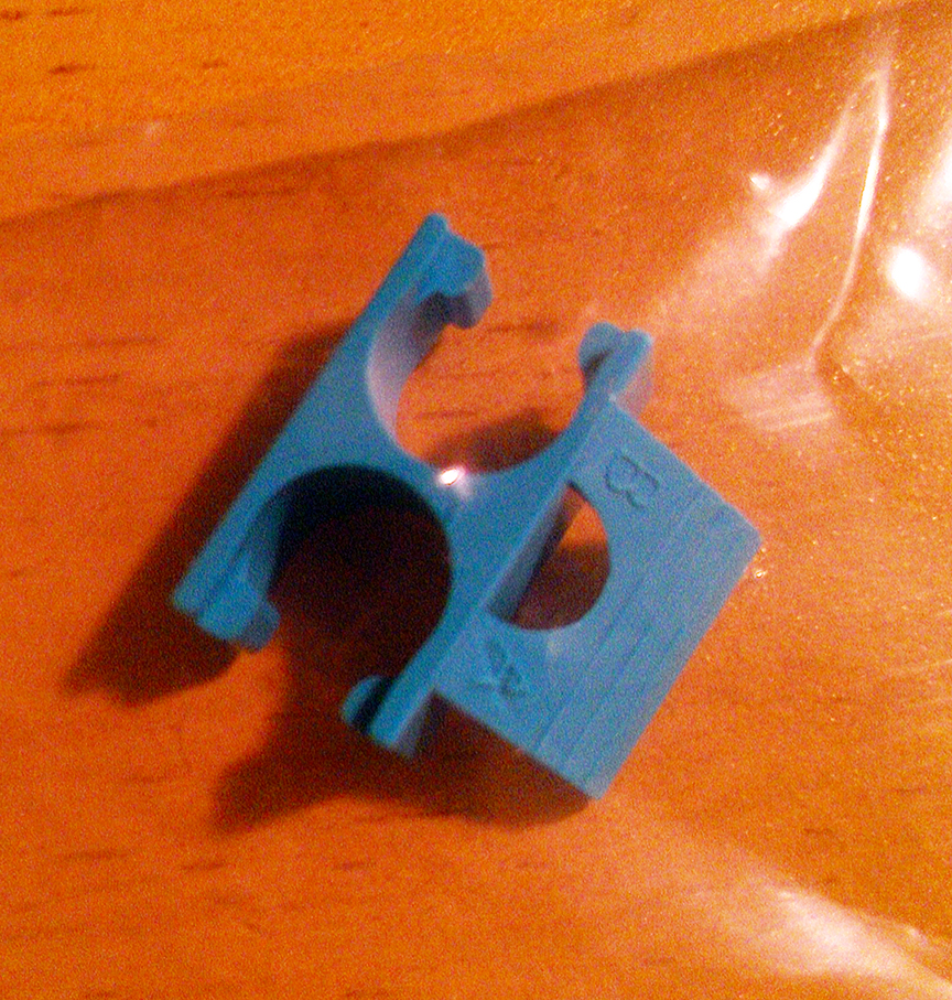

Ira Aduro Posted February 15, 2013 Author Share Posted February 15, 2013 Thanks, and thanks for the sub. Found a great use for all those DVD-RWs I never can really use! Check out what's keeping the front CPU inlet up. Besides that did some more test fittings, trying to figure out where to put the HDs. Right behind the top shelf fan/speaker would be great for cooling them, however it is a bit tight and right next to the GPU (heat!) After all this fanegaling I'll probably end up back where I started with HDs in top compartment. Hopefully in the next few days I'll have time to get some prototypes done and start test fitting. btw - the last of hte photos attached, what in the world is that object? Link to comment https://www.insanelymac.com/forum/topic/286161-g5-legacy/page/2/#findComment-1889114 Share on other sites More sharing options...
WhatTheTech Posted February 15, 2013 Share Posted February 15, 2013 It's the PCI Card guide: http://www.ebay.com/itm/Apple-922-5958-PowerMac-G5-PCI-Card-Guide-815-7388-/390423211190 Link to comment https://www.insanelymac.com/forum/topic/286161-g5-legacy/page/2/#findComment-1889169 Share on other sites More sharing options...
Ira Aduro Posted February 15, 2013 Author Share Posted February 15, 2013 It almost perfectly fits a 2.5" drive between the guides. If only it had 5 guides instead of 4 I could use it for HDD mounting. EDIT: I'll be getting some foam core tomorrow to start building prototype middle dividers and back plate. Link to comment https://www.insanelymac.com/forum/topic/286161-g5-legacy/page/2/#findComment-1889219 Share on other sites More sharing options...
