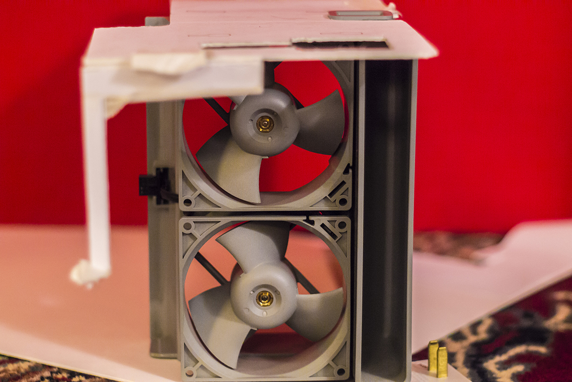

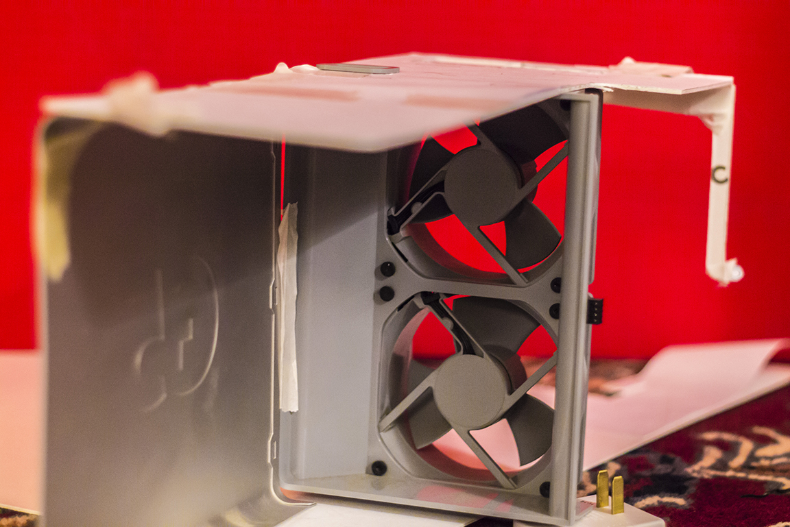

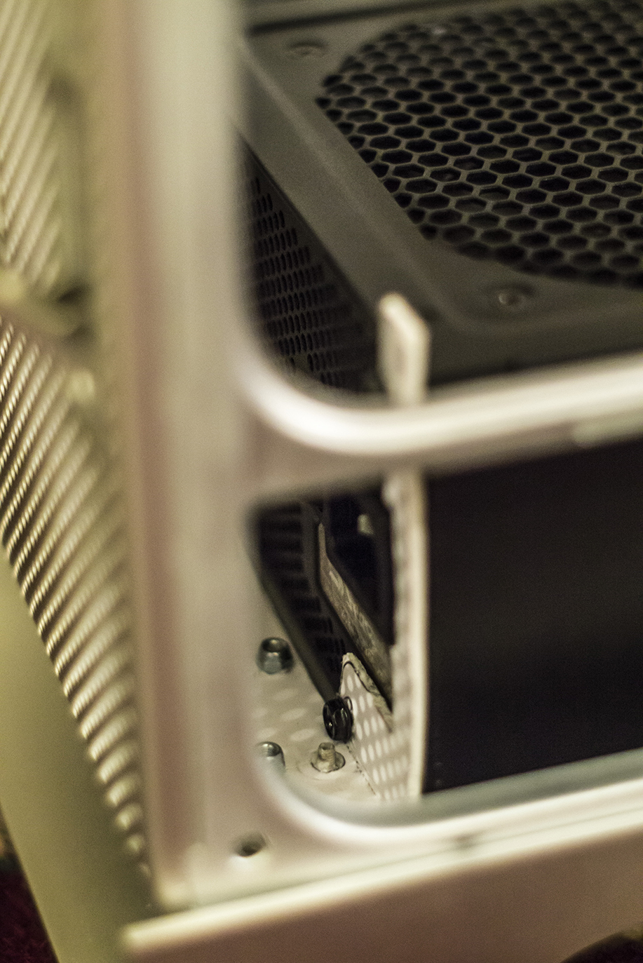

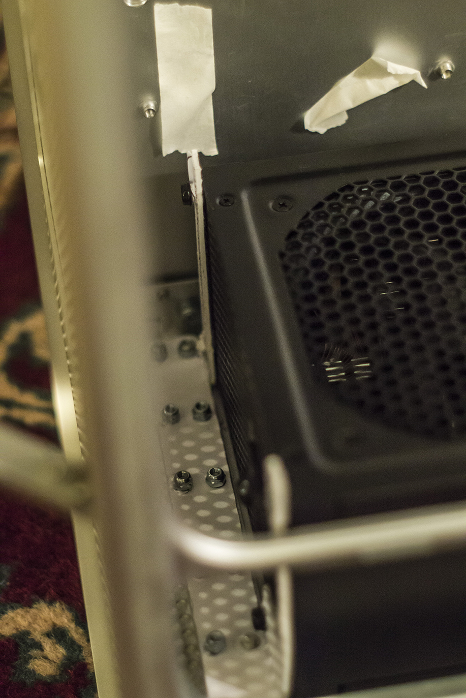

Ira Aduro Posted February 20, 2013 Author Share Posted February 20, 2013 Today I manage to get together a proof of concept for the top section "holders". Photos attached. So basically this little doohickey uses the screws that hold the inner shell to the outer shell for support. You can then use this little doohickey to support DVD drives, PSUs, etc. The PSU will need one that covers more of the screws for better support. But I'm happy to test and find out this will probably work. The final holders would be made of metal, I used the artboard for concepting but it bends too much for actual use. Link to comment https://www.insanelymac.com/forum/topic/286161-g5-legacy/page/3/#findComment-1890616 Share on other sites More sharing options...

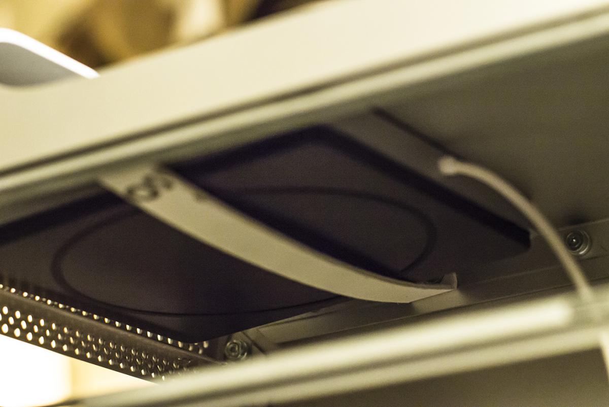

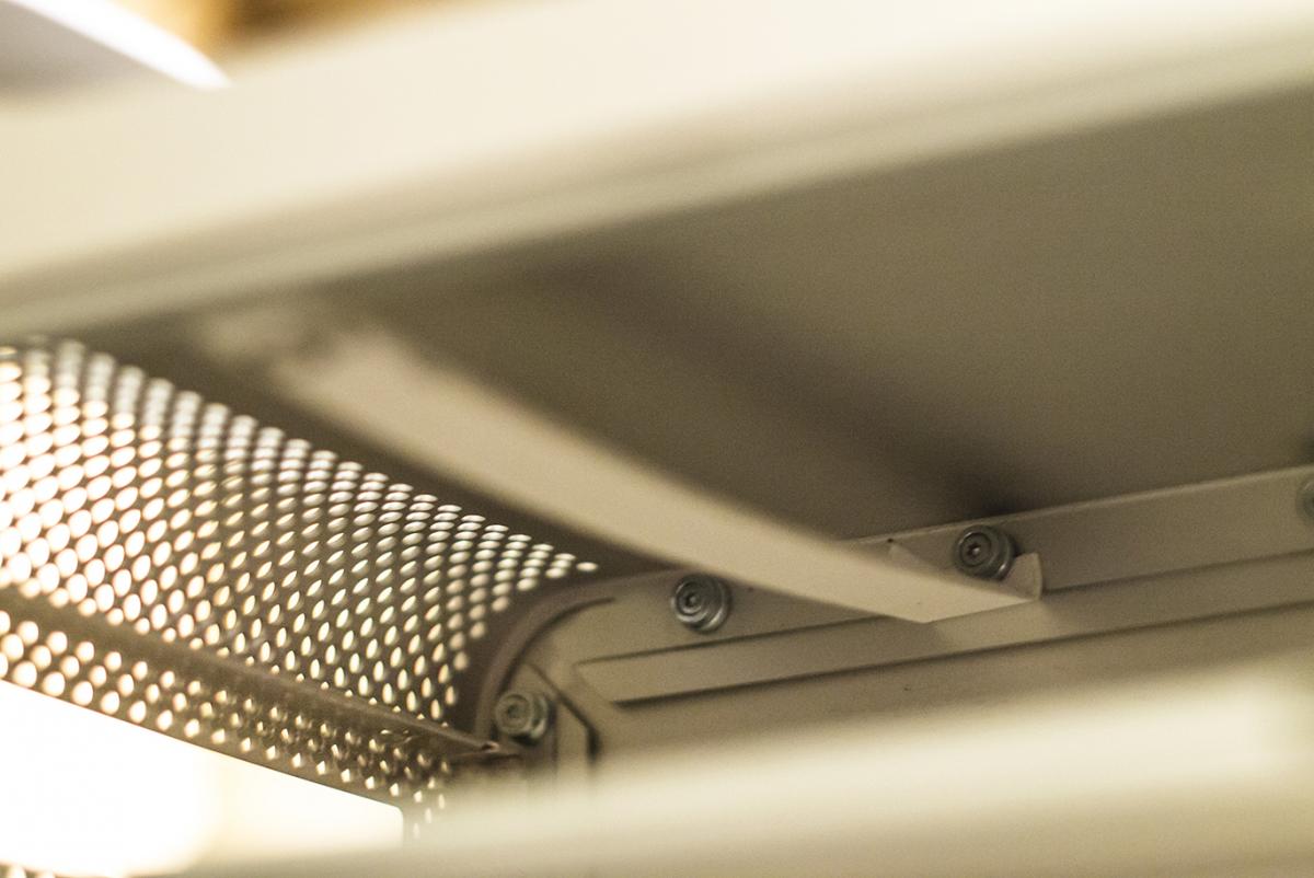

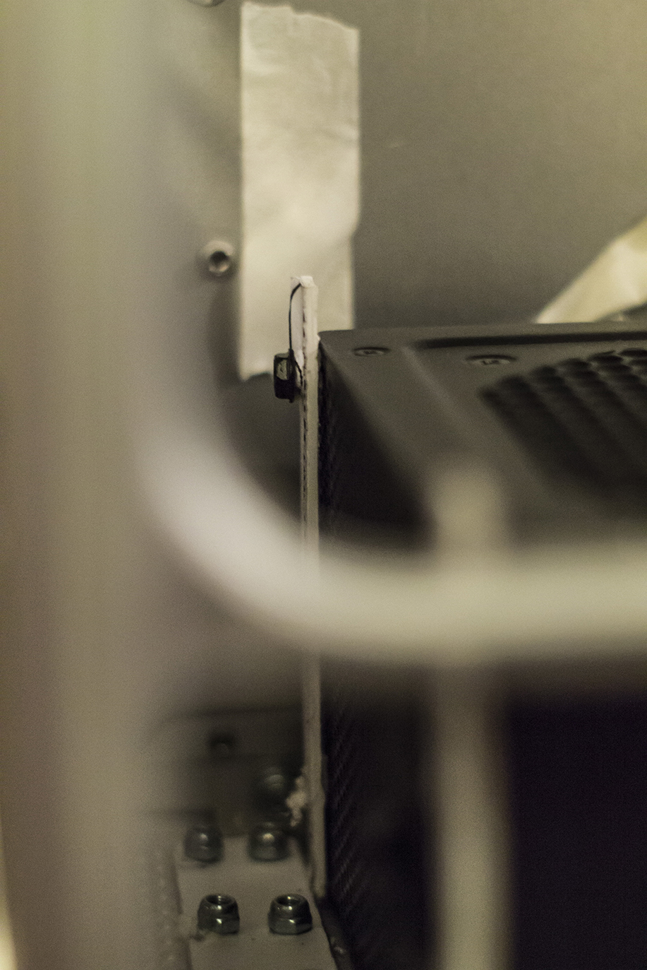

Ira Aduro Posted February 22, 2013 Author Share Posted February 22, 2013 Tonight I got a chance to inspect how the upper case is assembled. I noticed that the seam where two parts of the case meet has a metal bracket with a few small screws and nuts. That's when I knew I had stumbled upon a better way to make the PSU holder. I took measurements and created a guide for cutting out the new piece. This is just a paper mockup of the actual bracket. I'm attaching the .DXF file (zipped) for this piece to this post. So, what we have here is a bracket that keeps the case together but also serves as a PSU holder. I'll need to make something to support the front end of the PSU but this takes care of a major hurdle in the long and slow road to my G5 mod's completion. Photos attached along with schematic in case you want to print it / cut it out. I'm 95% certain this schematic will work, it definitely works with the PSU I have. Lastly, a shot of the mug that is keeping my caffeinated. PSU holder.zip 1 Link to comment https://www.insanelymac.com/forum/topic/286161-g5-legacy/page/3/#findComment-1891107 Share on other sites More sharing options...

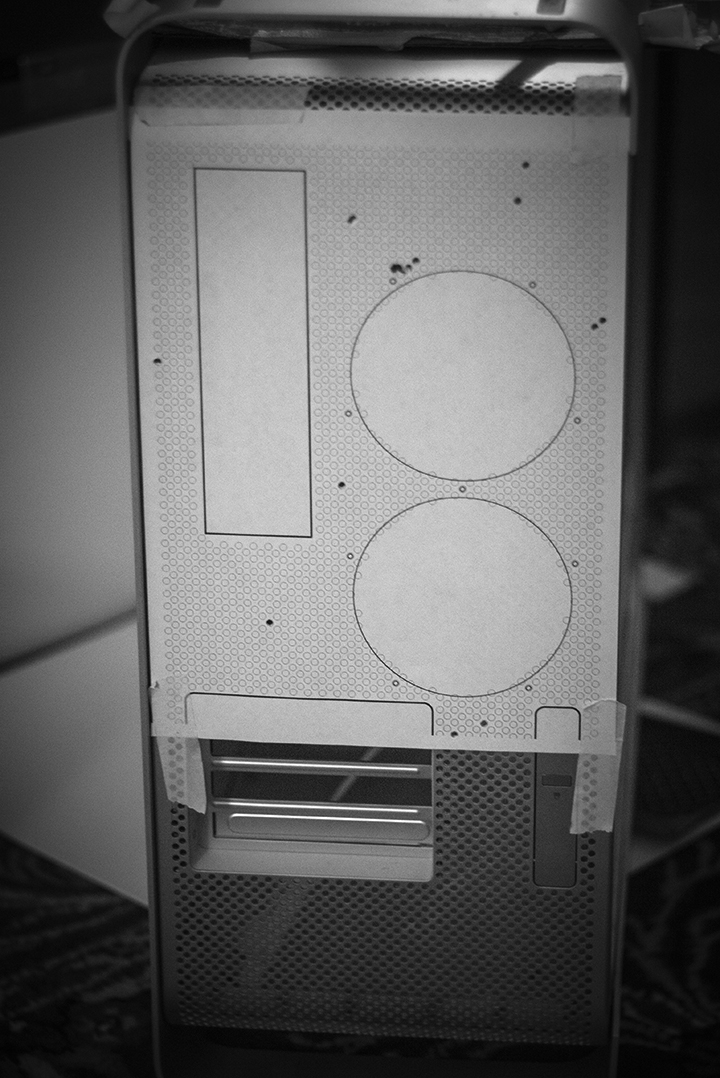

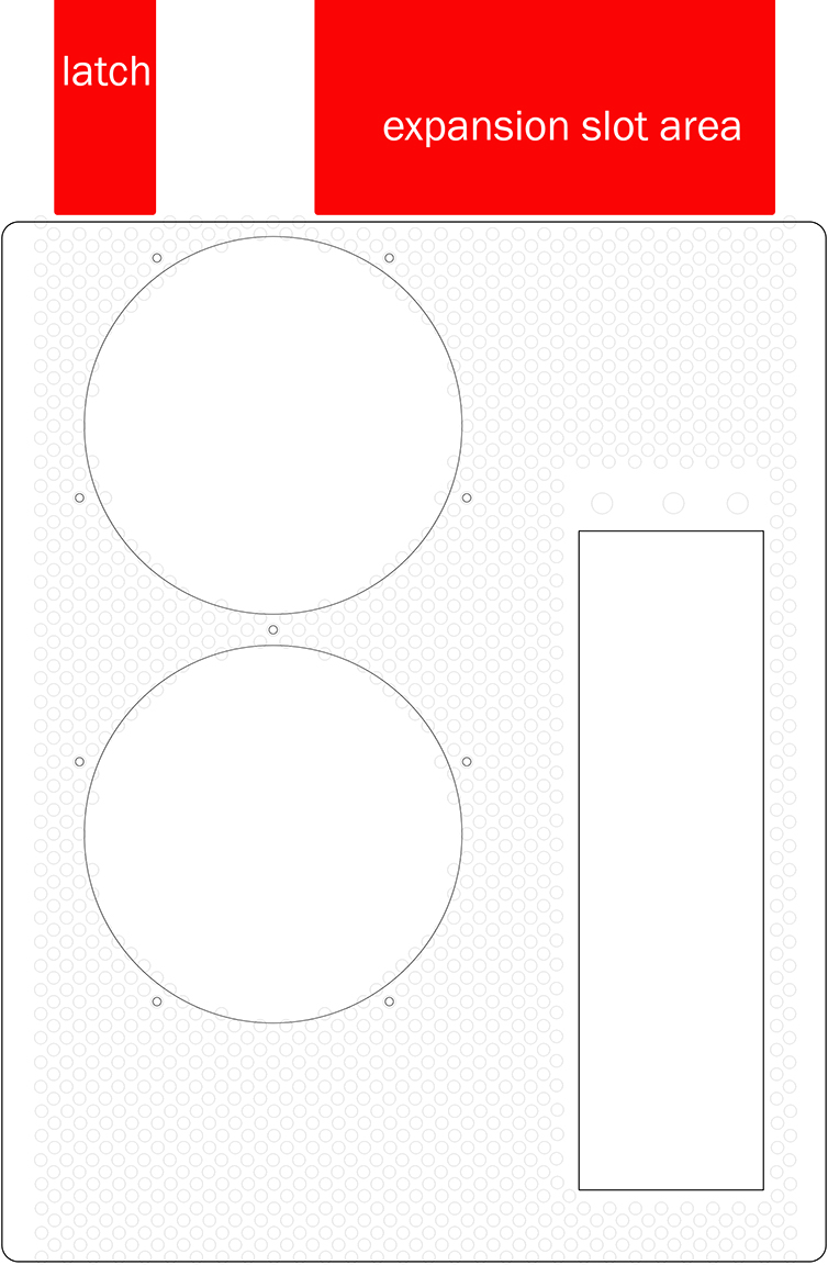

Ira Aduro Posted March 4, 2013 Author Share Posted March 4, 2013 (edited) 60+ hour work weeks have put a damper on my G5 modding mojo. But I have managed to make version 2.0 of the new backplate. Immediately after test fitting it I realized version 3.0 would be necessary, the back IO port area is not lined up with the PCI slot area. Silly me. Anyways, photo attached as is the .dxf of version 3.0 (now with proper alignment). ps - the random holes in the paper template are just me making sure the holes line up. backplate.zip Edited March 9, 2013 by Ira Aduro Link to comment https://www.insanelymac.com/forum/topic/286161-g5-legacy/page/3/#findComment-1893959 Share on other sites More sharing options...

Ira Aduro Posted March 7, 2013 Author Share Posted March 7, 2013 Thank you, I am just modifying sheriff's original template so most of the credit goes to him, especially nailing down the hole spacing. Still waiting to hear back from water jet place on how much it will cost to get this cut out. I'll probably cut another prototype out first just ot make sure my measurements are correct. Link to comment https://www.insanelymac.com/forum/topic/286161-g5-legacy/page/3/#findComment-1894870 Share on other sites More sharing options...
Ira Aduro Posted March 8, 2013 Author Share Posted March 8, 2013 So according to the water jet place - to cut out that design would be around $600 because of all the starting and stopping of the water jet. :( So, anyone have a cnc router or something and want to help me and the community out with this by doing a prototype? Link to comment https://www.insanelymac.com/forum/topic/286161-g5-legacy/page/3/#findComment-1895144 Share on other sites More sharing options...

Ira Aduro Posted March 9, 2013 Author Share Posted March 9, 2013 I make these in illustrator so I can save as that, EPS, SVG or even as a JPG or TIFF file. Talking to a friend and he had the great suggestion that I take the plans down to a local tech college as they often have a shop and will cut stuff out. The company I called about get this cut out with a water jet also have a CNC router but they flat out refused to cut it with that since they said all the up and down of the holes would destroy their motor. EDIT: I updated that post with a .zip file that contains EPS, SVG, AI, DXF. Link to comment https://www.insanelymac.com/forum/topic/286161-g5-legacy/page/3/#findComment-1895198 Share on other sites More sharing options...

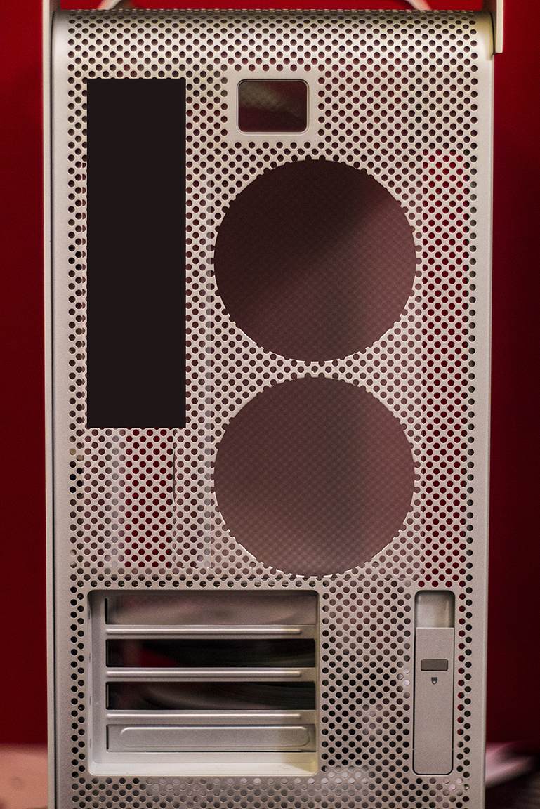

Ira Aduro Posted March 11, 2013 Author Share Posted March 11, 2013 So I tweaked the back cover to have less holes and cover less area. I need some advice from those that have cut backplates. The expansion slot area - it seems the facade is glued or welded to the back of the case? If that is so, my current plan is to cut right below where the expansion slot begins and remove the perforated aluminum there. How well do you think that would work? In case that is not clear I've attached the template with red areas showing where the expansion slot and latch would go, you can see how close it runs to it. Oh and the three larger holes in the area above the rear IO area is a place where I'm thinking about attaching two wifi and one bluetooth antenna. Company move is on final week. I promise this mod is going somewhere! Just very slowly and very cautiously. There probably will never be another G5 mod by me so I want to get this one perfect so I can use the case for many years to come. Link to comment https://www.insanelymac.com/forum/topic/286161-g5-legacy/page/3/#findComment-1895919 Share on other sites More sharing options...
Baudouin Posted March 11, 2013 Share Posted March 11, 2013 So I tweaked the back cover to have less holes and cover less area. I need some advice from those that have cut backplates. The expansion slot area - it seems the facade is glued or welded to the back of the case? If that is so, my current plan is to cut right below where the expansion slot begins and remove the perforated aluminum there. How well do you think that would work? In case that is not clear I've attached the template with red areas showing where the expansion slot and latch would go, you can see how close it runs to it. Oh and the three larger holes in the area above the rear IO area is a place where I'm thinking about attaching two wifi and one bluetooth antenna. Company move is on final week. I promise this mod is going somewhere! Just very slowly and very cautiously. There probably will never be another G5 mod by me so I want to get this one perfect so I can use the case for many years to come. Not exactly, from the outside, the plastique with numbers is glue to the alu plate and from the inside the "divider" connectors piece is soldered onto the case. It easy to take it out with a flat screwdriver by gently lifting the piece alongside . I will make an How-to with pix because I have dismantled several cases and kept the different parts. 2 Link to comment https://www.insanelymac.com/forum/topic/286161-g5-legacy/page/3/#findComment-1895929 Share on other sites More sharing options...
Ira Aduro Posted March 11, 2013 Author Share Posted March 11, 2013 !!! awesome !!! thanks in advance. Link to comment https://www.insanelymac.com/forum/topic/286161-g5-legacy/page/3/#findComment-1895937 Share on other sites More sharing options...
Baudouin Posted March 11, 2013 Share Posted March 11, 2013 In the meantime, the pics : You can see the glue on the plastique parts and the shadows on the mesh part is the track of the solder . Link to comment https://www.insanelymac.com/forum/topic/286161-g5-legacy/page/3/#findComment-1895945 Share on other sites More sharing options...
Ira Aduro Posted March 12, 2013 Author Share Posted March 12, 2013 So, another dead end but I am learning. According to the local tech college - cnc cutting the backplate would not be a good idea because the thin metal would vibrate too much and programming time would be too long for a one-off piece. They did recommend me to a laser cutting place as that is supposedly the best way to cut a piece like this. Also, holes smaller than 1/8" are not really round with a laser cutter and you have flash burrs when cutting aluminum since it is so reflective. Link to comment https://www.insanelymac.com/forum/topic/286161-g5-legacy/page/3/#findComment-1896119 Share on other sites More sharing options...

Ira Aduro Posted March 12, 2013 Author Share Posted March 12, 2013 Don't get my hopes up. I thought the hard part would be making a template for the backplate that matches up perfectly. I didn't think the hard part would be finding a way to cut said template out. I've been talking to David from the LaserHive and laser cutting the aluminum would cause warping due to heat build up from cutting so many holes so close together. I've started looking into drill presses so I can do this by hand but that is not ideal. There's got to be something I'm missing. I'm going to contact more CNC places, maybe someone around my town can stably cut thin aluminum. I've also contact a guy from the Hard Forums who has a plasma cutter and offered to cut stuff for me. The really frustrating aspect is my goal of a backpanel that anyone can download the template for and then have it cut out is looking less likely to happen simply because the cutting out would be $$ or hard to find someone who could do it. Link to comment https://www.insanelymac.com/forum/topic/286161-g5-legacy/page/3/#findComment-1896318 Share on other sites More sharing options...
