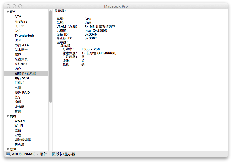

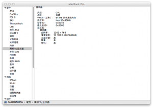

I was installing DualLink framebuffers. Installing DualLink LCD+VGA Alternative I got a distorted screen. Installing DualLink LCD+VGA my system isn't started.
For my screen resolution (1366x768) I need a SingleLink framebuffer. I had not heard that.
I reinstalled the AppleIntelHDGraphicsFB.kext with a SingleLink LCD+VGA Alternative framebuffer and now the screen is working flawlessly!
Thanks for the help!
Just to let you guys know, my ZIP archive already had this, you just had to pick the one you needed, i'm guessing the alternative frame buffer. You didn't have to go through all that trouble. :P Assuming you were using 10.8.3.
I tried all kinds of combinations but always had to remove the AppleIntelHDGraphics.kext to be able to boot. It didn't work until I followed enjiner's method. Dunno why :S And yes, I am on 10.8.3, installed via myhack.

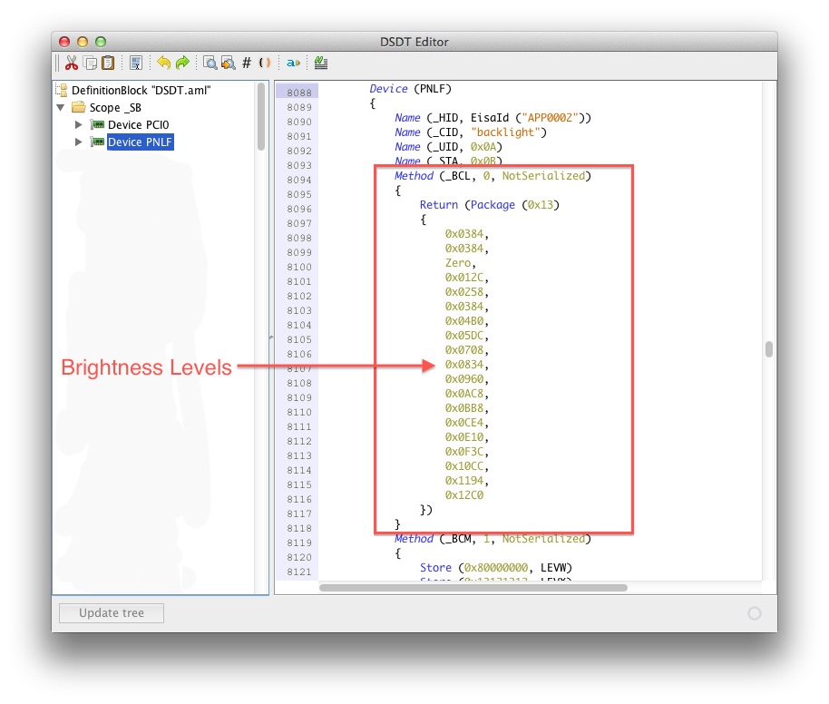

Basically, the PNLF section is where you set the values of the brightness levels for your internal LCD.
Let's take a look at this PNLF section.

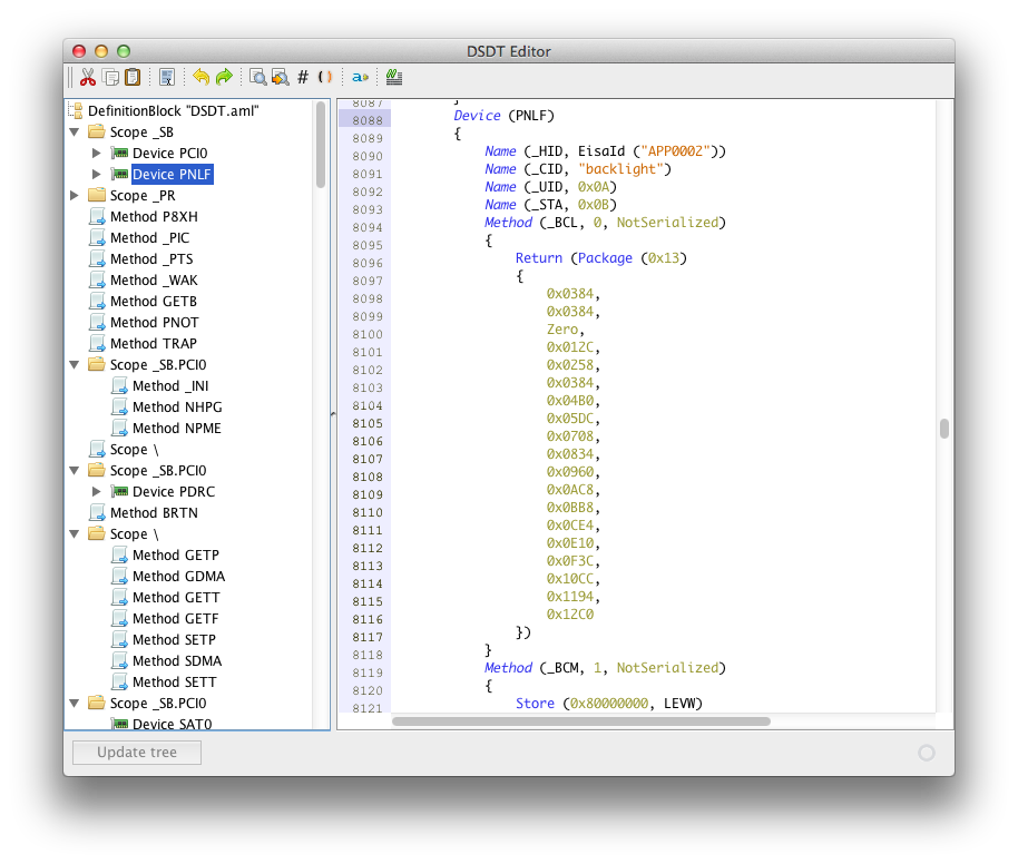

The code is a bit longer than what the screenshot shows. This is my full PNLF code:
Device (PNLF)
	 Name (_HID, EisaId ("APP0002"))
	 Name (_CID, "backlight")
	 Name (_UID, 0x0A)
	 Name (_STA, 0x0B)
	 Method (_BCL, 0, NotSerialized)
		 Return (Package (0x13)
			 0x0384,
			 0x0384,
			 Zero,
			 0x012C,
			 0x0258,
			 0x0384,
			 0x04B0,
			 0x05DC,
			 0x0708,
			 0x0834,
			 0x0960,
			 0x0AC8,
			 0x0BB8,
			 0x0CE4,
			 0x0E10,
			 0x0F3C,
			 0x10CC,
			 0x1194,
			 0x12C0
	 Method (_BCM, 1, NotSerialized)
		 Store (0x80000000, LEVW)
		 Store (0x13121312, LEVX)
		 Store (0x80000000, LEV2)
		 Store (Arg0, LEVL)
	 Method (_BQC, 0, NotSerialized)
		 Return (BRTL)
	 Method (_DOS, 1, NotSerialized)
		 ^^PCI0.GFX0._DOS (Arg0)
Lets look at the code by piece. Let's start with Method (_BCL, 0, NotSerialized).
Because this part of this code is called Method _BCL, you can see that it stands for Backlight Levels. Let's take a deeper look.
The Return (Package (0x13) means that there are a total of 17 brightness levels. Never change this code since that is the maximum amount of levels that the brightness lever in System Preferences supports.

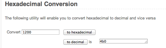

How did I convert my numbers to hexadecimal? I used a website called Statman.info.
http://www.statman.i...exadecimal.html
Enter your regular number in the convert box. Press "to hexadecimal" and you'll get your number in hexadecimal.
