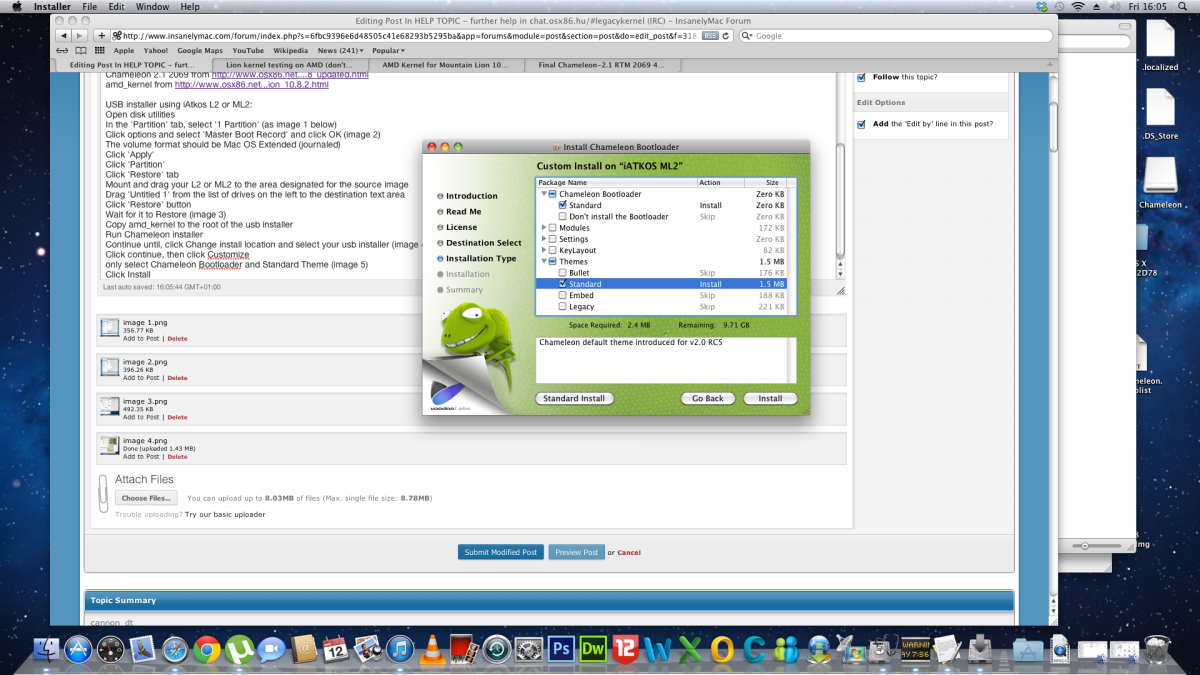

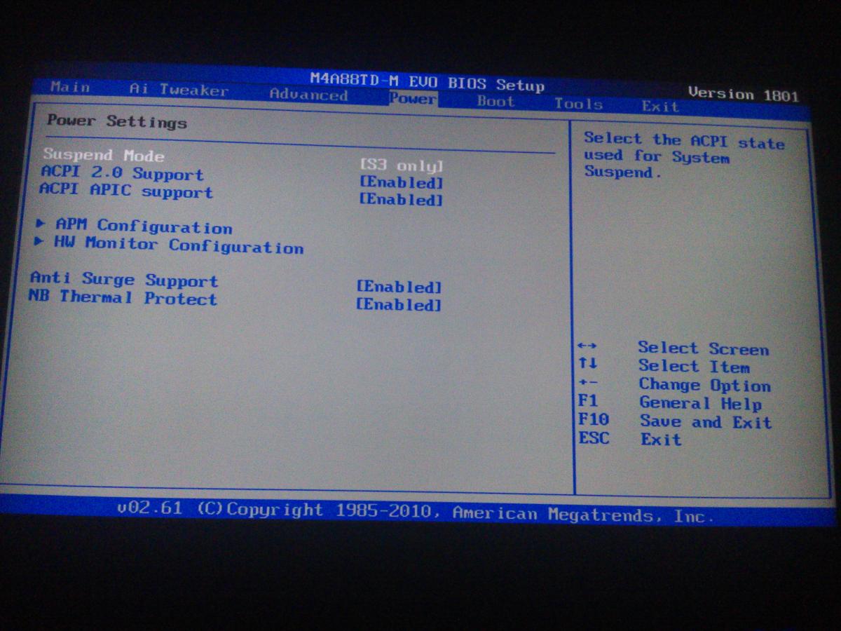

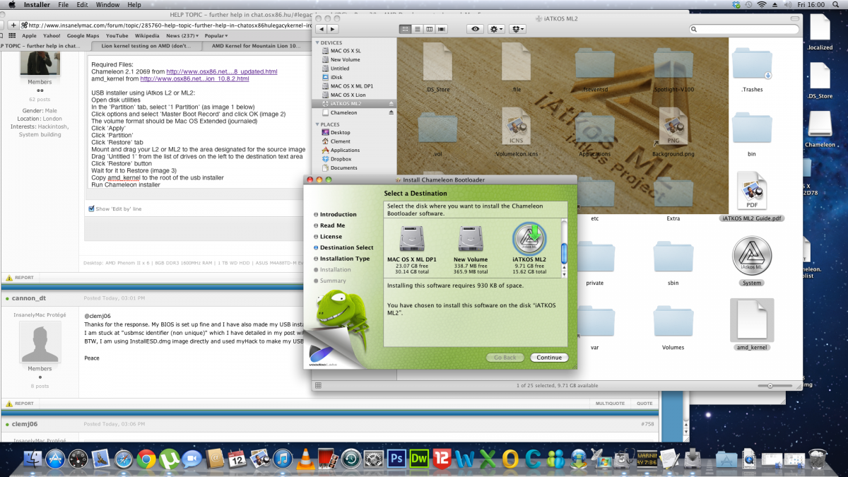

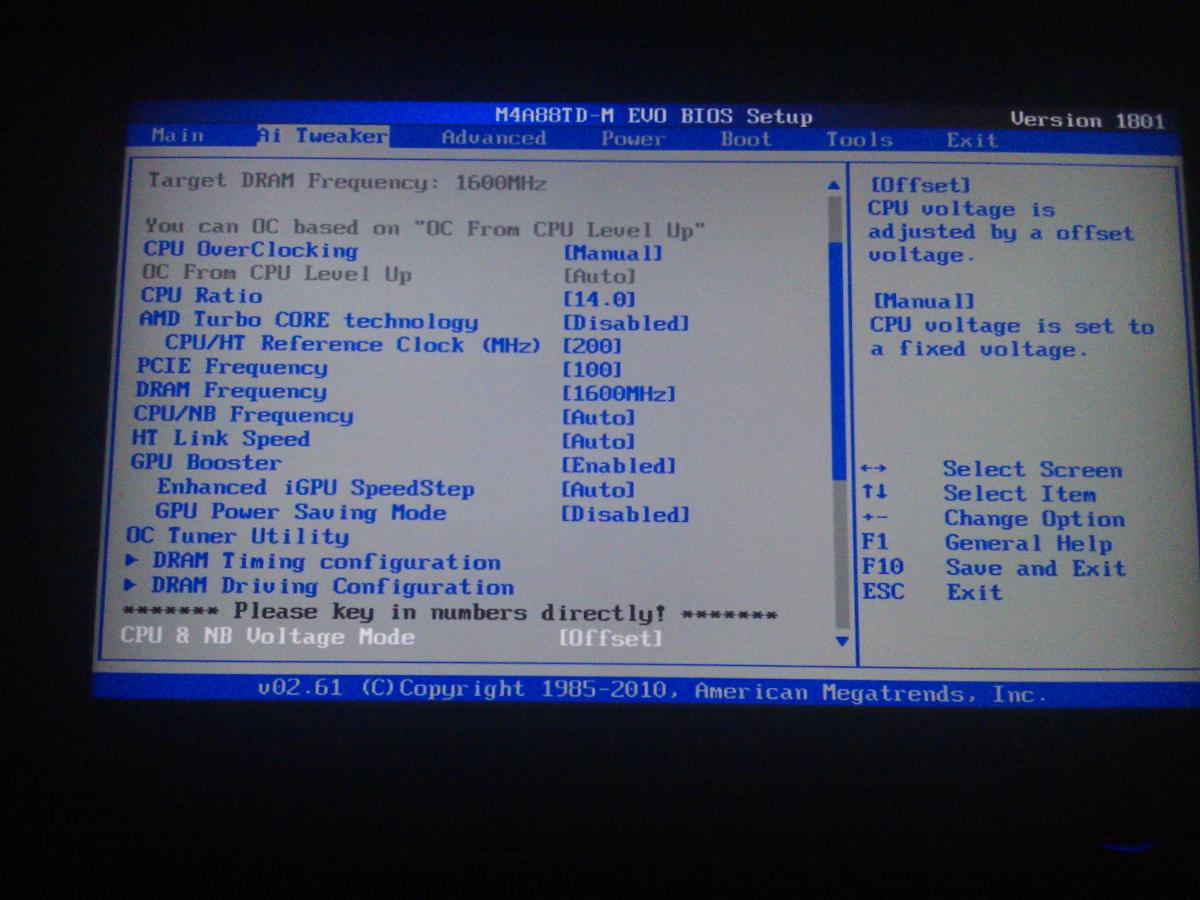

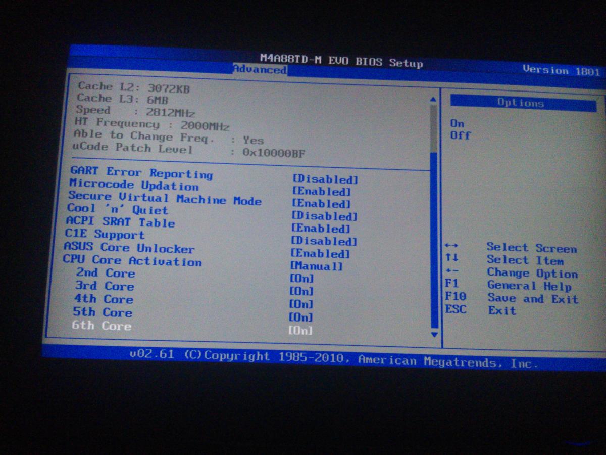

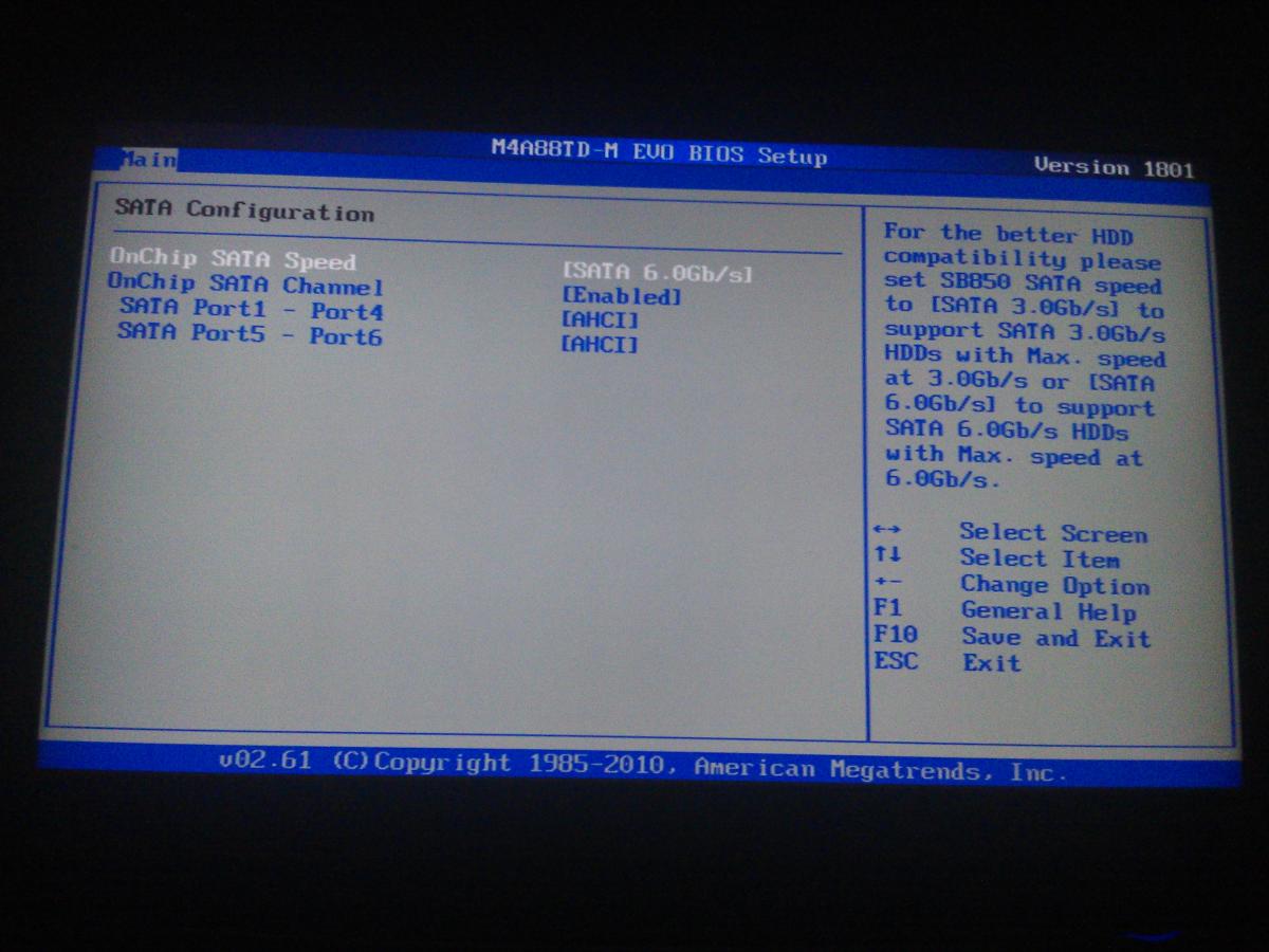

clemj06 Posted April 12, 2013 Share Posted April 12, 2013 (edited) @cannon_dt, sabag123 & aydreeuhn I am back home now, so I can help now... Note: Firsly, this requires a lot of patience and effort, to get your system up and running, persistence by trial and error is essential, do not give up. I will be constantly editing this post to help all of you... Bios settings: Check the images from here 1. Resetting the bios settings to optimised defaults 2. Disable Cool n Quiet, C1E, Turbo 3. Enable S3 ACPI, AHCI Required Files: Chameleon 2.1 2069 from http://www.osx86.net....8_updated.html amd_kernel from http://www.osx86.net...ion_10.8.2.html USB installer using iAtkos L2 or ML2: Open disk utilities In the 'Partition' tab, select '1 Partition' (as image 1 below) Click options and select 'Master Boot Record' and click OK (image 2) The volume format should be Mac OS Extended (journaled) Click 'Apply' Click 'Partition' Click 'Restore' tab Mount and drag your L2 or ML2 to the area designated for the source image Drag 'Untitled 1' from the list of drives on the left to the destination text area Click 'Restore' button Wait for it to Restore (image 3) Copy amd_kernel to the root of the usb installer Run Chameleon installer Continue until, click Change install location and select your usb installer (image 4) Click continue, then click Customize only select Chameleon Bootloader and Standard Theme (image 5) Click Install Edit: Delete folders /Extra/Keymaps and /Extra/modules Edit: Note: If you have an AMD Radeon HD 6xxx graphics card Go into /System/Library/Extensions, backup and delete ati6000 or all ati kexts. Installing: Reboot system Select the usb as the boot device When Chameleon comes up use the bootflags: amd_kernel arch=x86_64 npci=0x2000 or npci=0x3000 -v After continuing and agreeing the terms, before installing, Click utilities, then click disk utility Format the partition you want to install OS X to, use Mac OS Extended (journaled) Close Click 'Customize' Select the options shown in image 6 Then select the partition you want to install to Click install Now we need to copy the amd_kernel from the usb to the root of the just installed OS X...Pay close attention Boot into the installer again using the same bootflags as before Click utilities Click terminal In the terminal type diskutil list (image 7) Take note of the installer usb name, in my case 'iATKOS ML2' and the installed OS partition, in my case 'MAC OS X ML DP1'. cd to the iATKOS ML2 installer by typing: cd /Volumes/'iATKOS ML2' or cd /Volumes/'the name of your installer drive' (image 7) copy amd_kernel to your installed OS X partition by typing: cp -r amd_kernel /Volumes/'MAC OS X ML DP1' or cp -r amd_kernel /Volumes/'the name of your drive' (image 7) Reboot Boot the usb installer, by chameleon, select the partition you installed OS X on and use flags: amd_kernel arch=x86_64 npci=0x2000 or npci=0x3000 -v Edited April 12, 2013 by clemj06 Link to comment https://www.insanelymac.com/forum/topic/285760-help-topic-for-help-in-os-x-yosemite-1010-and-below/page/31/#findComment-1906236 Share on other sites More sharing options...

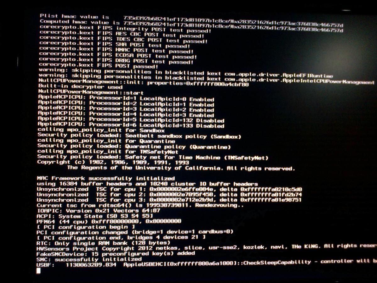

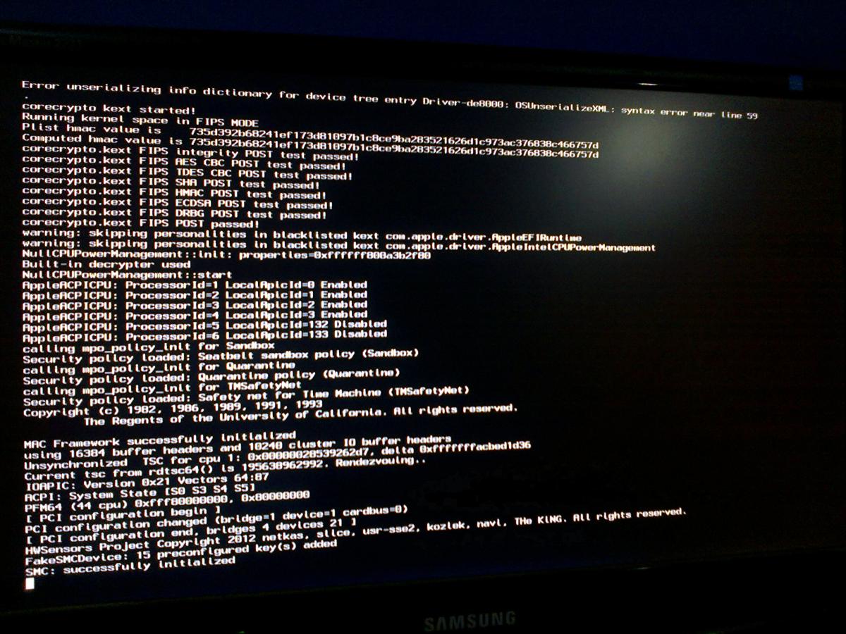

cannon_dt Posted April 12, 2013 Share Posted April 12, 2013 @clemj06 Thanks for the response. My BIOS is set up fine and I have also made my USB install which works. I am stuck at "usbmsc identifier (non unique)" which I have detailed in my post with photo. BTW, I am using InstallESD.dmg image directly and used myHack to make my USB - my post has all the steps that I have done in detail and where I am stuck at. Peace Link to comment https://www.insanelymac.com/forum/topic/285760-help-topic-for-help-in-os-x-yosemite-1010-and-below/page/31/#findComment-1906250 Share on other sites More sharing options...
clemj06 Posted April 12, 2013 Share Posted April 12, 2013 (edited) @clemj06 Thanks for the response. My BIOS is set up fine and I have also made my USB install which works. I am stuck at "usbmsc identifier (non unique)" which I have detailed in my post with photo. BTW, I am using InstallESD.dmg image directly and used myHack to make my USB - my post has all the steps that I have done in detail and where I am stuck at. Peace Your steps have errors, you do not have an nvidia chipset, why have the AppleNForceATA kext? You do not need libcrypto.dlyb if using andy's amd_kernel.... You are trying to install ML2 right? I could give you the instructions using the InstallESD.dmg way... Edited April 12, 2013 by clemj06 Link to comment https://www.insanelymac.com/forum/topic/285760-help-topic-for-help-in-os-x-yosemite-1010-and-below/page/31/#findComment-1906255 Share on other sites More sharing options...
cannon_dt Posted April 12, 2013 Share Posted April 12, 2013 @clemjo6 I started with that ML2 iatkos image but I gave that up. My bootable USB is now based on InstallESD.dmg way. Also the amd_kernel I am using is from here : http://www.osx86.net...ion_10.8.2.html I am not familiar with what kexts I do not need, I used the entire extensions folder that a member her, spakk gave me. He also asked me to use the libcrypto.dlyb file (i believe that this is required for boot) - I will gladly follow your instructions. In fact I have a very useful program installed on my linux distro that can directly manipulate my hfs partitioned usb - so fire away and I can make the necessary changes Thanks Link to comment https://www.insanelymac.com/forum/topic/285760-help-topic-for-help-in-os-x-yosemite-1010-and-below/page/31/#findComment-1906263 Share on other sites More sharing options...
clemj06 Posted April 12, 2013 Share Posted April 12, 2013 (edited) @clemjo6 I started with that ML2 iatkos image but I gave that up. My bootable USB is now based on InstallESD.dmg way. Also the amd_kernel I am using is from here : http://www.osx86.net...ion_10.8.2.html I am not familiar with what kexts I do not need, I used the entire extensions folder that a member her, spakk gave me. He also asked me to use the libcrypto.dlyb file (i believe that this is required for boot) - I will gladly follow your instructions. In fact I have a very useful program installed on my linux distro that can directly manipulate my hfs partitioned usb - so fire away and I can make the necessary changes Thanks Your kernel is correct...libcrypto.dlyb you do not really have to change but you can if you want to.... So I assume you know how to make the bootable installer, as in restore basesystem.dmg to usb then copy the packages folder from the installESD.dmg to the restored usb's /System/Installation/ folder deleting the packages link found in that folder. Edit: replacing OSInstall and OSInstall.mpkg then installing chameleon, amd_kernel and the kexts... Is that the method you used? Edited April 12, 2013 by clemj06 Link to comment https://www.insanelymac.com/forum/topic/285760-help-topic-for-help-in-os-x-yosemite-1010-and-below/page/31/#findComment-1906266 Share on other sites More sharing options...
cannon_dt Posted April 12, 2013 Share Posted April 12, 2013 @clemj06 I followed the myHack method (http://myhack.sojugarden.com/guide/) 1. Partitioned my USB using disk utility 2. Ran myHack and pointed it to the InstallESD.dmg 3. Once it finished I ran the latest chameleon bootloader (http://chameleon.osx86.hu/articles/chameleon-21-latest-version-download-links-updated) Please let me know if you see any issues here (I ran the latest chameleon bootloader on top of myHack and that resolved the boot0 error) Link to comment https://www.insanelymac.com/forum/topic/285760-help-topic-for-help-in-os-x-yosemite-1010-and-below/page/31/#findComment-1906272 Share on other sites More sharing options...
clemj06 Posted April 12, 2013 Share Posted April 12, 2013 @clemj06 I followed the myHack method (http://myhack.sojugarden.com/guide/) 1. Partitioned my USB using disk utility 2. Ran myHack and pointed it to the InstallESD.dmg 3. Once it finished I ran the latest chameleon bootloader (http://chameleon.osx...d-links-updated) Please let me know if you see any issues here (I ran the latest chameleon bootloader on top of myHack and that resolved the boot0 error) That seems perfect, although I have never used the myhack way, you said you did not reach the installer right? Do you have an /Extra/Extensions folder on your USB? Link to comment https://www.insanelymac.com/forum/topic/285760-help-topic-for-help-in-os-x-yosemite-1010-and-below/page/31/#findComment-1906280 Share on other sites More sharing options...

clemj06 Posted April 12, 2013 Share Posted April 12, 2013 (edited) Put these kexts into the folder go into /System/Library/Extensions, backup and remove ati6000.kext or all ati kexts... try booting with flags: amd_kernel -nossse3bit npci=0x2000 or npci=0x3000 -v kexts.zip Edited April 12, 2013 by clemj06 Link to comment https://www.insanelymac.com/forum/topic/285760-help-topic-for-help-in-os-x-yosemite-1010-and-below/page/31/#findComment-1906288 Share on other sites More sharing options...
cannon_dt Posted April 12, 2013 Share Posted April 12, 2013 Done, should I try to install now? Out of curiosity - the thing I am getting stuck with, "usbmsc identifier (non unique)" - that could be caused due to anything? Or is there some specific cause - I am asking this because you are asking me to remove the ATI kexts (I modified the ATI6xxxx kext with my product id and vendor ID) - so I am asking just to learn in the process Peace Link to comment https://www.insanelymac.com/forum/topic/285760-help-topic-for-help-in-os-x-yosemite-1010-and-below/page/31/#findComment-1906290 Share on other sites More sharing options...
clemj06 Posted April 12, 2013 Share Posted April 12, 2013 Yeah, try to install now...the reason I asked you to remove the ati6xxx is because for some people their systems may hang because they have a 6xxx amd card, it has happened to me before whilst trying to install an OS, so I have always found it easier to delete it and put it back after the install is done... amd_kernel -nossse3bit npci=0x2000 or npci=0x3000 -v Link to comment https://www.insanelymac.com/forum/topic/285760-help-topic-for-help-in-os-x-yosemite-1010-and-below/page/31/#findComment-1906293 Share on other sites More sharing options...

cannon_dt Posted April 12, 2013 Share Posted April 12, 2013 I am back clemj06 This is what I tried: 1. amd_kernel arch=x86_64 GraphicsEnabler=No npci=0x3000 -v (Ended up with NPCI0x3000.jpg) 2. amd_kernel arch=x86_64 GraphicsEnabler=No npci=0x2000 -v (Ended up with NPCI0x2000.jpg) So I am not sure which npci I should go with.... And if I go with 0x2000 should I get in USBBusFix=Yes now.. Over to you sir Peace Link to comment https://www.insanelymac.com/forum/topic/285760-help-topic-for-help-in-os-x-yosemite-1010-and-below/page/31/#findComment-1906311 Share on other sites More sharing options...
