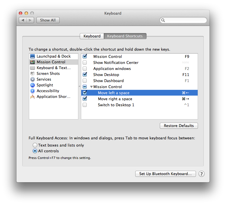

K0gen Posted February 16, 2013 Author Share Posted February 16, 2013 (edited) I have came across excellent VoodooPS2Controller.kext replacement by RehabMan on GitHub. Believe me this are the best drivers you will get. You can program your three fingers swipe to whatever shortcut you wan plus the inertial/smooth scrolling works just like on a real mac! I'll include new drivers in the next release of LenovoEFI_Pack_Beta3 stay tuned. Update: For those who can't wait - attached the drivers I'm using now. My keyboard shortcuts settings: VoodooPS2Controller_RehabMan.zip Edited February 16, 2013 by Kogen Mantis 1 Link to comment https://www.insanelymac.com/forum/topic/285678-lenovo-thinkpad-t420-with-uefi-only/page/3/#findComment-1889380 Share on other sites More sharing options...

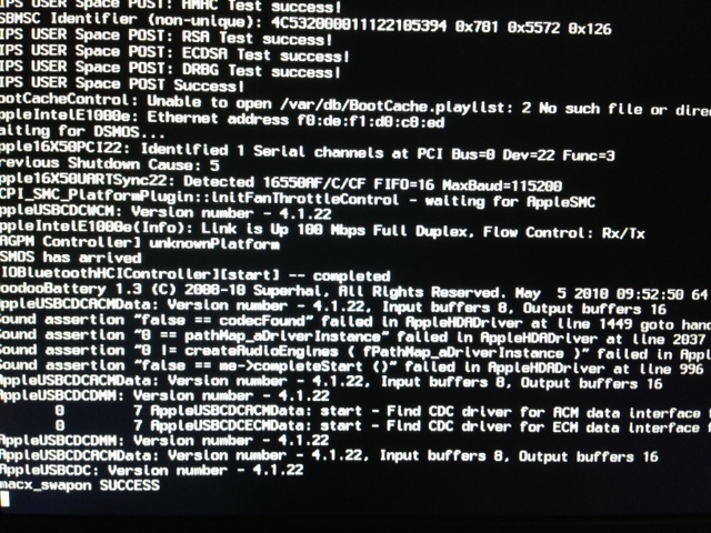

Espamac Posted February 27, 2013 Share Posted February 27, 2013 Hi there again! OK, good things first. I bought a Lenovo X220, brand new, heavily discounted since the model is not longer manufactured. Beautiful little thing Specs: Intel Core i7 2.8 IPS Panel RAM 4GB HD 160SSD Fingerprint, 3G, GPS, USB 3.0 and blah blah blah. The installation went really smooth, amazingly smooth. The most difficult part shockingly was creating a USB installation disk with Lion DiskMaker. I won't go into much detail, it was a localization problem related to how the Mountain Lion Installation app is named in Spanish making it unrecognizable to DiskMaker. If anyone is interested I can explain him the easy workaround. Tools I used: Mountain Lion 10.8.2 installation The Stripped EFI Folder posted on #63 And I came out nicely and smooth. I even updated Safari and some other stuff without any problems, after being prompted by the App Store app on the dock. I must say the IPS 12.5" looks gorgeous on Mac OS X, much better than on Windows 7 and the system feels faster and more responsive than in Windows, which I honestly find a little bit puzzling. The system says it's a MacBook Pro 17inch, Early 2011 with a 2.81 Ghz Intel Core i7. The display profile says spdisplays_display 17" (1366x768). Any way to change that? No that it matters much as I said the screen looks terrific. Working · Power-On with fingerprint. I stored it previously using the ThinkPad software, since it is a BIOS set up it works independently of the OS. Nice feature. · Ethernet · Webcam · The funny little lamp besides the webcam (Fn+PgUp) · ExpressCard slot Working with issues · Sleep mode works after doing as suggested on post #27. Closing the lid doesn't seem to make the computer enter sleep mode. When the lid passes a certain angle on its way to be closed, the Fn+F4 combination for sleep mode doesn't work either. · USB 2.0 inputs. USB 3.0 doesn't work, any ideas? · The trackpad works so-so. Precision of the pointer is smother than in Windows 7 (again I'm puzzled by this), but two finger scrolling works in the opposite direction (if you swipe towards the keyboard the page goes down and vice-versa). Pinch zoom and rotate don't work. Three and four fingers are equivalent to using F11. That's it. Any suggestion is very welcome. · Battery doesn't show remaining time nearby the icon or percentage. Just on the foldable menu. Anyway to change that? Not working · No Wifi obviously. The Dell 1515 card has arrived today though I'm a little bit reluctant to flash the BIOS. Does it void the warranty? Would I be able to return to the original BIOS? Would it be possible to modify the Dell 1515 vendor-ID to bypass the whitelist but still be recognized by Mac OS X as an airport card? It's an appealing approach, though maybe it doesn't make sense what I'm saying... Still thinking about it, is not such a big issue anyway since I can use a wifi nano-usb in the mean time. They're dirt cheap. · No sound. At all. At first boot the mute and volume keys increased and decreased the bar, now when you press them the volume logo shows up with a forbidden sign. There's no sound card recognized. Any idea where to begin exploring? · No microphone detected. Is it paired with the sound issue? · No bluetooth. · Card reader doesn't work. I think it's a known unsolvable issue so I don't worry much. Untested · VGA-out · Display port · WAN card for mobile data Is there any program that kind of "checks" the system to see what is working and what it is detected? Is there any way to check if the kexts are being applied correctly? I assume they are placed in System/Library/Extensions. Is that correct? Many years ago with my first hackintosh I remember you had to repair permissions in the Terminal every time you modified the kexts, I understand that now that's done by running myHack, is that so? do you have to reboot afterwards? I think I messed something up with AppleHDA.kext because I removed the original (kept in on another folder) and placed the one which was on the Extras folder on S/L/E. Is there any way to stop the messages at startup? I think I read something about line 461 AppleHDA or whatever before entering the desktop. I haven't touched the dsdt.asml file, should I? I'm really sorry for the long message, I got carried away :-) Thank you very much for all the job you're doing. It is amazing. I'm going to gather information and will get back to edit the message if I manage to solve anything. Regards to everybody! Link to comment https://www.insanelymac.com/forum/topic/285678-lenovo-thinkpad-t420-with-uefi-only/page/3/#findComment-1892585 Share on other sites More sharing options...
K0gen Posted February 27, 2013 Author Share Posted February 27, 2013 (edited) The system says it's a MacBook Pro 17inch, Early 2011 with a 2.81 Ghz Intel Core i7. The display profile says spdisplays_display 17" (1366x768). Any way to change that? Yes you can do a Display Override as I did in #13 or use nice little app Tetonne mentioned in #39 Sleep mode works after doing as suggested on post #27. Closing the lid doesn't seem to make the computer enter sleep mode. When the lid passes a certain angle on its way to be closed, the Fn+F4 combination for sleep mode doesn't work either. For this you need proper dsdt USB 2.0 inputs. USB 3.0 doesn't work, any ideas? Search for USB3 kext... I have fount interesting post about AppleUSBXHCI.kext patching for native USB3 support. Since I don't have USB3 - You will be the one to test it out. To make long story short add this to your clover config: <key>KernelAndKextPatches</key> <dict> <key>KextsToPatch</key> <dict> <key>0</key> <dict> <key>Name</key> <string>AppleUSBXHCI</string> <key>Find</key> <data>dVs=</data> <key>Replace</key> <data>61s=</data> </dict> <key>1</key> <dict> <key>Name</key> <string>AppleUSBXHCI</string> <key>Find</key> <data>Zj0AAQ==</data> <key>Replace</key> <data>Zj0AAA==</data> </dict> <key>2</key> <dict> <key>Name</key> <string>AppleUSBXHCI</string> <key>Find</key> <data>gUkIAABAAA==</data> <key>Replace</key> <data>gUkIAAAAAA==</data> </dict> <key>3</key> <dict> <key>Name</key> <string>AppleUSBXHCI</string> <key>Find</key> <data>QcdEJAgAAEAA</data> <key>Replace</key> <data>QcdEJAgAAAAA</data> </dict> <key>4</key> <dict> <key>Name</key> <string>AppleUSBXHCI</string> <key>Find</key> <data>QcdGCAAAQAA=</data> <key>Replace</key> <data>QcdGCAAAAAA=</data> </dict> <key>5</key> <dict> <key>Name</key> <string>AppleUSBXHCI</string> <key>Find</key> <data>xoDIAAAAAQ==</data> <key>Replace</key> <data>xoDIAAAAAA==</data> </dict> <key>6</key> <dict> <key>Name</key> <string>AppleUSBXHCI</string> <key>Find</key> <data>dSZIi7voAQAA</data> <key>Replace</key> <data>6yZIi7voAQAA</data> </dict> </dict> </dict> The trackpad works so-so. Precision of the pointer is smother than in Windows 7 (again I'm puzzled by this), but two finger scrolling works in the opposite direction (if you swipe towards the keyboard the page goes down and vice-versa). Pinch zoom and rotate don't work. Three and four fingers are equivalent to using F11. That's it. Any suggestion is very welcome.try playing with touchpad and keyboard settings. (we still don't have true multitouch drivers) · No Wifi obviously. The Dell 1515 card has arrived today though I'm a little bit reluctant to flash the BIOS. Does it void the warranty? Would I be able to return to the original BIOS? Would it be possible to modify the Dell 1515 vendor-ID to bypass the whitelist but still be recognized by Mac OS X as an airport card? It's an appealing approach, though maybe it doesn't make sense what I'm saying... Still thinking about it, is not such a big issue anyway since I can use a wifi nano-usb in the mean time. They're dirt cheap. · No sound. At all. At first boot the mute and volume keys increased and decreased the bar, now when you press them the volume logo shows up with a forbidden sign. There's no sound card recognized. Any idea where to begin exploring? · No microphone detected. Is it paired with the sound issue? · No bluetooth. · Card reader doesn't work. I think it's a known unsolvable issue so I don't worry much. Untested · VGA-out · Display port · WAN card for mobile data Is there any program that kind of "checks" the system to see what is working and what it is detected? Is there any way to check if the kexts are being applied correctly? I assume they are placed in System/Library/Extensions. Is that correct? Many years ago with my first hackintosh I remember you had to repair permissions in the Terminal every time you modified the kexts, I understand that now that's done by running myHack, is that so? do you have to reboot afterwards? I think I messed something up with AppleHDA.kext because I removed the original (kept in on another folder) and placed the one which was on the Extras folder on S/L/E. Is there any way to stop the messages at startup? I think I read something about line 461 AppleHDA or whatever before entering the desktop. I haven't touched the dsdt.asml file, should I? I'm really sorry for the long message, I got carried away :-) Thank you very much for all the job you're doing. It is amazing. I'm going to gather information and will get back to edit the message if I manage to solve anything. Regards to everybody! OK I'm tired Just send your full Darwin Dumper Report here and I'll try to help you out. Edited February 27, 2013 by Kogen Mantis Link to comment https://www.insanelymac.com/forum/topic/285678-lenovo-thinkpad-t420-with-uefi-only/page/3/#findComment-1892656 Share on other sites More sharing options...

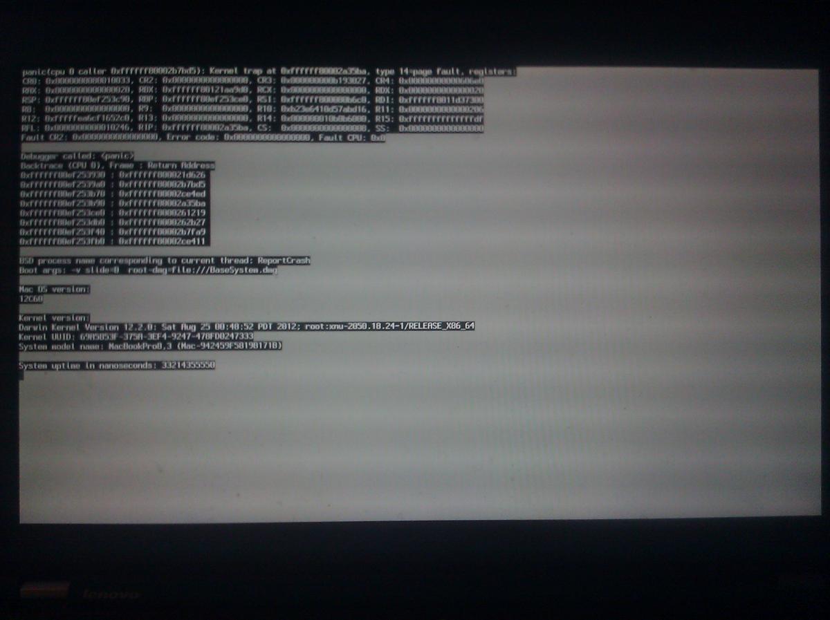

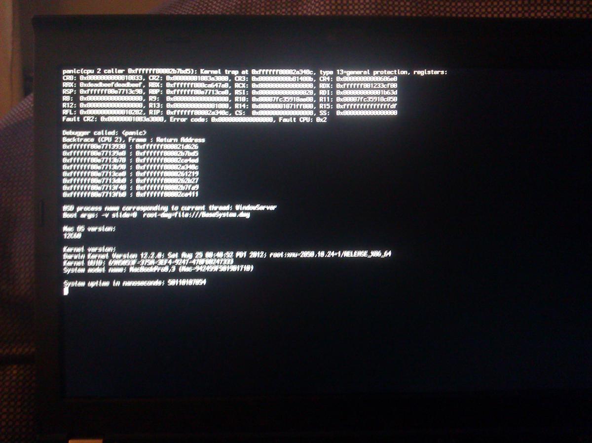

Espamac Posted February 28, 2013 Share Posted February 28, 2013 You have used older DarwinDumper - pleas update your post with latest one (some info is missing) Sorry about that here's the latest one: DarwinDumper_2.6.5_Lenovo_ML_root.zip I tried pasting the code you gave me for USB 3.0. I mounted the EFI volume and modified the config.plist file but got a KP on boot. I'm sorry I didn't take any pictures, I'll look through the post you referred to see if I can get it working. Thanks!!! Link to comment https://www.insanelymac.com/forum/topic/285678-lenovo-thinkpad-t420-with-uefi-only/page/3/#findComment-1892842 Share on other sites More sharing options...
K0gen Posted February 28, 2013 Author Share Posted February 28, 2013 Sorry about that here's the latest one: DarwinDumper_2.6.5_Lenovo_ML_root.zip I tried pasting the code you gave me for USB 3.0. I mounted the EFI volume and modified the config.plist file but got a KP on boot. I'm sorry I didn't take any pictures, I'll look through the post you referred to see if I can get it working. Thanks!!! I have attached dsdt file for you based on your ACPI dumps. I recommend you work on your OEM folder now in case of any failure you can always rename it and boot the system from the oryginal striped EFI folder config. dsdt-x220-126001.aml.zip Link to comment https://www.insanelymac.com/forum/topic/285678-lenovo-thinkpad-t420-with-uefi-only/page/3/#findComment-1892846 Share on other sites More sharing options...

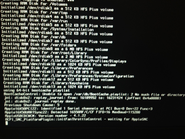

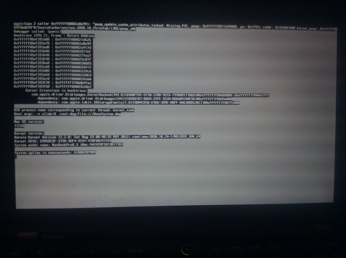

Espamac Posted February 28, 2013 Share Posted February 28, 2013 I have attached dsdt file for you based on your ACPI dumps. I recommend you work on your OEM folder now in case of any failure you can always rename it and boot the system from the oryginal striped EFI folder config. Hello again, Thanks a lot for your time, it's appreciated. I placed the dsdt file on the OEM folder and run myHack. Nothing changed. So I placed it on ACPI/Patched and it boots to a black screen and this is what I saw before going black: Now I try to boot from the USB disk and I also get the black screen and this is the last thing I get to see: I don't get why it doesn't boot from the USB since it hasn't been mod. Any way to safely start and repair the EFI folder? Send me to hell if I'm annoying you. I'm trying to figure this out myself but it looks like I lack some basic knowledge Link to comment https://www.insanelymac.com/forum/topic/285678-lenovo-thinkpad-t420-with-uefi-only/page/3/#findComment-1892945 Share on other sites More sharing options...
K0gen Posted February 28, 2013 Author Share Posted February 28, 2013 (edited) Hello again, Thanks a lot for your time, it's appreciated. I placed the dsdt file on the OEM folder and run myHack. Nothing changed. So I placed it on ACPI/Patched and it boots to a black screen and this is what I saw before going black: Now I try to boot from the USB disk and I also get the black screen and this is the last thing I get to see: I don't get why it doesn't boot from the USB since it hasn't been mod. Any way to safely start and repair the EFI folder? Send me to hell if I'm annoying you. I'm trying to figure this out myself but it looks like I lack some basic knowledge By OEM folder I mean (in Your case): EFI/OEM/42914BG So your custom dsdt goes to: EFI/OEM/42914BG/ACPI/patched And kexts you use goes to EFI/OEM/42914BG/kexts/10.8/ look inside to see how my old OEM folder looks like. EFI Shell is much like an good old DOS in use + all the UNIX like commands. So to get you started find your EFI drive (it is listed on the beginning) and if it's fs0 just type: fs0:[ENTER] rest is just like in any normal shell, use commands like: ls, mv, cp, edit, etc. Edited March 1, 2013 by Kogen Mantis Link to comment https://www.insanelymac.com/forum/topic/285678-lenovo-thinkpad-t420-with-uefi-only/page/3/#findComment-1892983 Share on other sites More sharing options...
