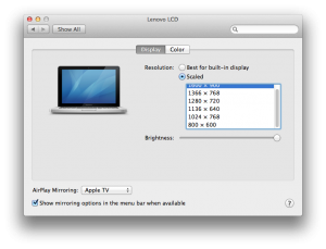

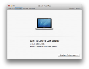

Today I've made a display override for my HD+ Panel (1600x900) based on MacbookPro9,1(DisplayVendorID-610/DisplayProductID-9cc7) and named it Lenovo LCD.
The display profile default is warmer using this file and I have added some extra resolution choices in scaled mode.
post-112035-0-95438800-1359552232_thumb.png post-112035-0-26209700-1359552263_thumb.png
Just unzip it and copy entire DisplayVendorID-30e4 folder to:
/System/Library/Displays/Overrides/
spdisplays_display Fixer.app.dmg to create yours

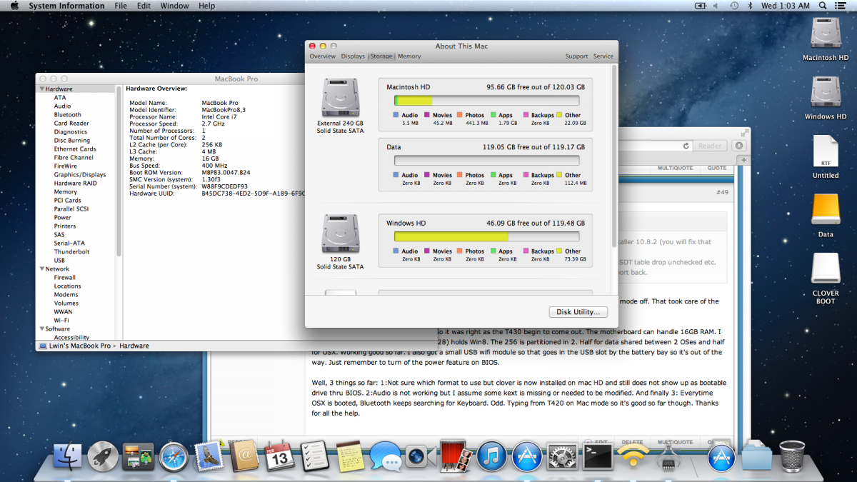

Yes I got the T420 about 2 years ago. So it was right as the T430 begin to come out. The motherboard can handle 16GB RAM. I am dual booting right now. One SSD (128) holds Win8. The 256 is partitioned in 2. Half for data shared between 2 OSes and half for OSX. Working good so far. I also got a small USB wifi module so that goes in the USB slot by the battery bay so it's out of the way. Just remember to turn of the power feature on BIOS.

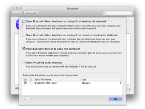

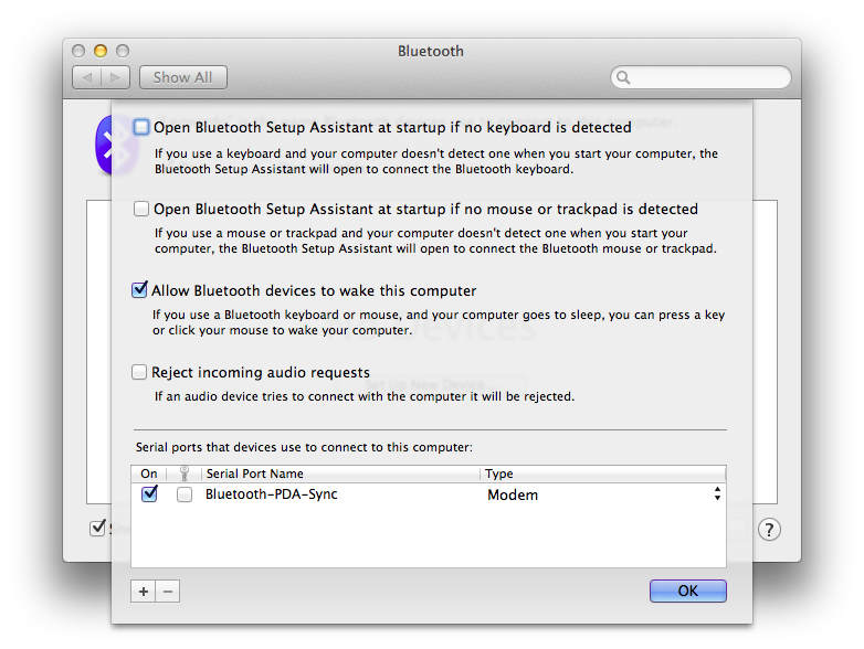

Well, 3 things so far: 1:Not sure which format to use but clover is now installed on mac HD and still does not show up as bootable drive thru BIOS. 2:Audio is not working but I assume some kext is missing or needed to be modified. And finally 3: Everytime OSX is booted, Bluetooth keeps searching for Keyboard. Odd. Typing from T420 on Mac mode so it's good so far though. Thanks for all the help.
Niece to see you progressing with the setup.
The bluetooth "phenomena" is normal cause OSX doesn't accept PS2 devices as valid controllers (keyboard/mouse) and thinks that they aren't connected. Just disable the bluetooth check.
As for audio. You are most likely using wrong driver or missing one. Now that you have OSX running update your post with DarwinDumperReport available here.
Thank you Kogen Mantis, UEFI is a great way to go (and install). My 4236DE2 build is flawless (sound,sleep,display port) with a quick load (UEFI w/ clover IS quicker). Had to add a vodoo battery kext. After playing with several DSDTs I used manwe150's from the other T420 big thread with the "DualLink to 0"fix from post 32 (I have the low resolution monitor). Changed the folder name on EFI partition and bingo. I was getting that black screen before the dual link fix, although connecting an external monitor worked.
I simply swapped the drive to my wife's 420: 4177CTR. And all but sound works. No folder change. System profiler even shows her 16 RAM at 1600 MHz(GSkill) and a Firewire port. I can't wait to try the Firewire with a MIDI external soundcard I have.
My wife's is a refub but a hellava Macbook. One thing, I put win7 on another Partition and clover wont boot it. Even if the bios is only legacy.myKexts.zip
